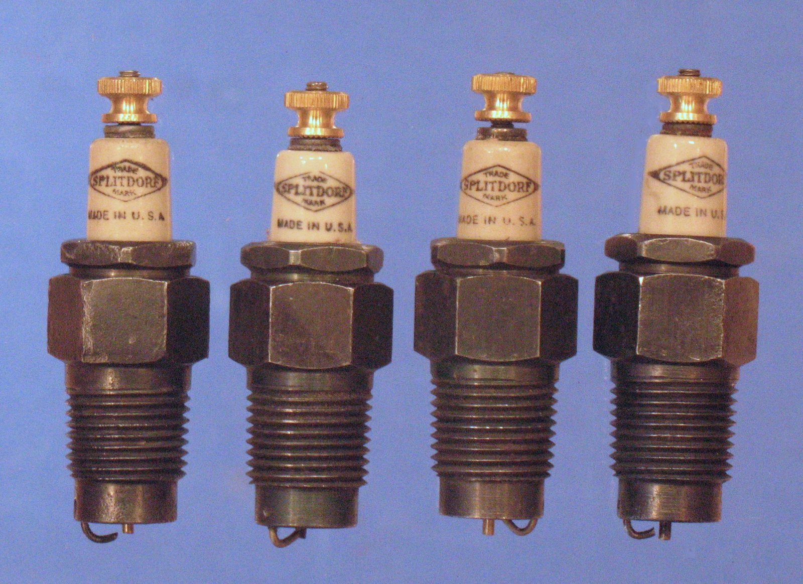

Even wearing an NH, Lizzie was making me work too much to get started. Wire brushing all the soot off the plugs improved starting considerably.

Steve, If you had so much soot that cleaning made a difference you probably need to run more lean. That could also account for your milage. Once you get up to operating temp on your long drives, turn back the carb adjusting needle a little.

Years ago on this form was a debate on spark plug gap with high compression engines. The consensus was to narrow the gap to.025 from the normal setting of .030/.032.

I've been setting plug gap between .025" and .030", about .028". Maybe I'll narrow that to .025" and see if it makes any difference.

Can anyone think of any reason at all why narrowing plug gaps from .03 to .025 should make things better in a HC engine - or any engine - if was starting OK at .03?
Posts: 7237
Re: Hard starting: sometimes the answer is simple
Post by Steve Jelf » Sun Sep 29, 2019 11:30 am
No, but if it wasn't starting perfectly maybe it would make a difference. If I understand this correctly, higher compression reduces the ability of plugs to make a spark. Maybe a slightly smaller gap would make for a better spark under the higher compression.
