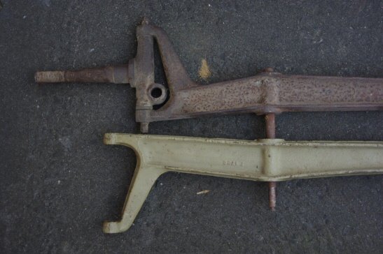

Wide track were made for southern roads where they grew cotton. The cotton hauling wagons were wider, so the road "ruts" were wider. Ford made Wide Track cars to accommodate southern roads.
Here is a photo comparing axles, courtesy of Peter Kable.
wide track axle.jpg (101.32 KiB) Viewed 4577 times
Peter is from down under, which explains why one axle is upside-down.
