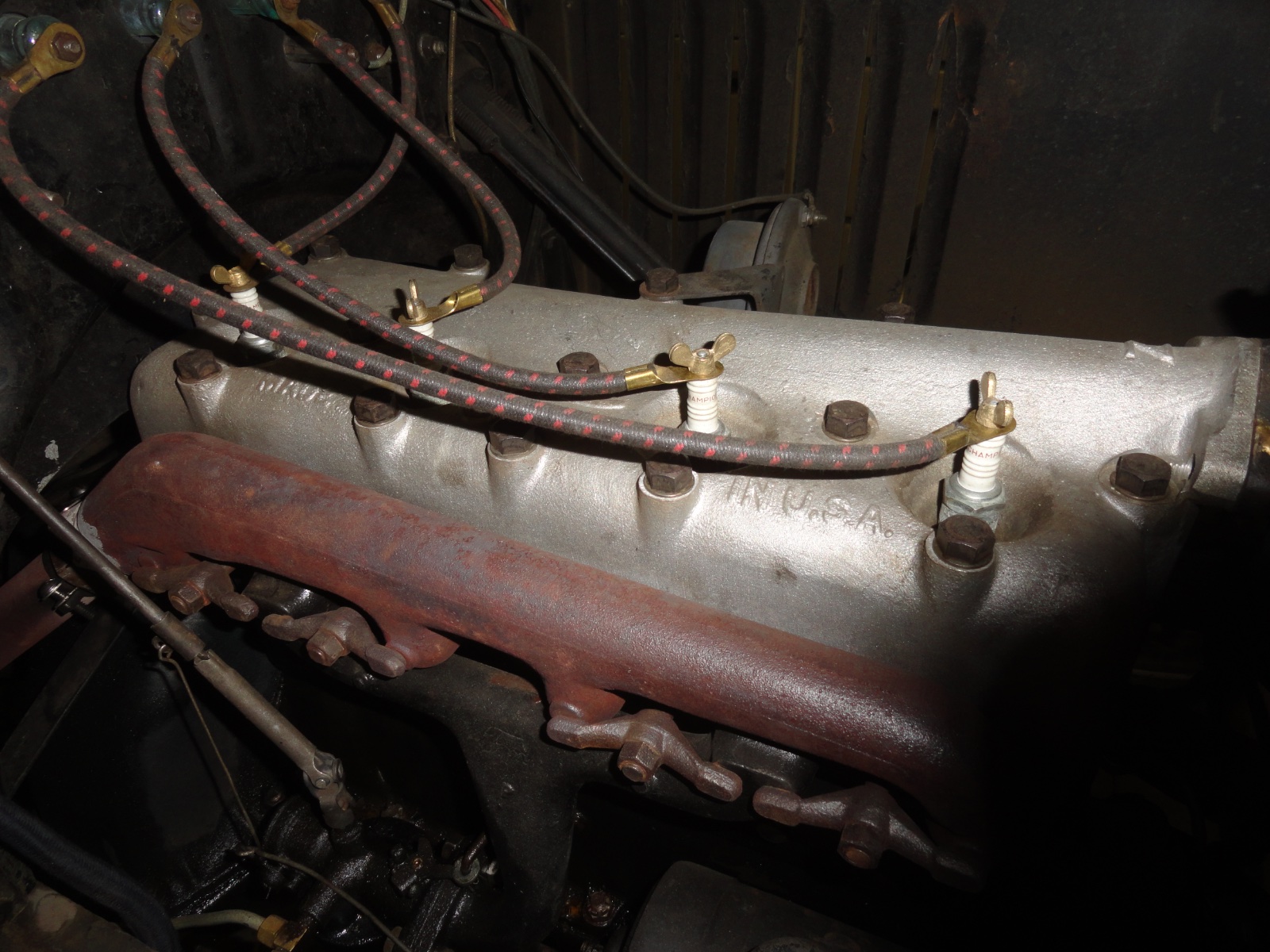

Re: Information Requested: 14mm Spark Plug
I run a Z-head, with Champion RN-10Y plugs. I have been very happy with them.
What was unacceptable to this aesthetically conscious owner is the modern top
contact/connection point, but the RN-10Y plug has a threaded top with a removable
modern cap. This allowed me to attach the stock wire harness in a period manner,
that looks perfectly 1933, Farmer Brown approved, when the hood is open.
Finding M4 thread brass wing nuts was a challenge, but the internet is your friend.
At first I looked for a period knurled nut, but changed direction to the wing nut for
ease of on-the-road adjustment.

KeithG
- Posts: 743
- First Name: Keith
- Last Name: Gumbinger
- Location: Kenosha, WI
Burger, those wing nuts look great. Could you be more specific on where you got them?
Thanks,
Keith

Burger in Spokane
- Posts: 2264
- First Name: Brent
- Last Name: Burger
- Location: Spokane, Wa.
- Board Member Since: 2014
Keith,
It was a couple years ago and I do not remember specifics, but I will look around
tonight and see if I can retrace my steps for you.
They came from China. Kind of a funny story .... Chinese sellers of odd little doo-
widgets like this seem to have very sketchy website sales presence. But they were
something like $4.60 for ten of them, so I pulled the trigger, hoping it wasn't a scam
and some Nigerian Prince wasn't about to clean out my bank account.
About six months went by and I was thinking the bank account had not been drained,
but no package ever came with those wing nuts, so I wrote it off .... The one day I get
this TINY, itsy-bitsy envelope in the mail, with all sorts of cute little chinese characters
all over it. I opened it up, and shur-nuff, .... there they were !
It only took 10 months, but what the the hey !

KeithG
- Posts: 743
- First Name: Keith
Thanks, Burger. It was worth asking anyway as they do like neat. Thanks again.

Burger in Spokane
- Posts: 2264
- First Name: Brent
- Last Name: Burger
Keith,
I just now typed "M4 brass wing nuts" into my search bar and pulled up
a whole bunch of exactly what we are talking about. Easy-peasy !
