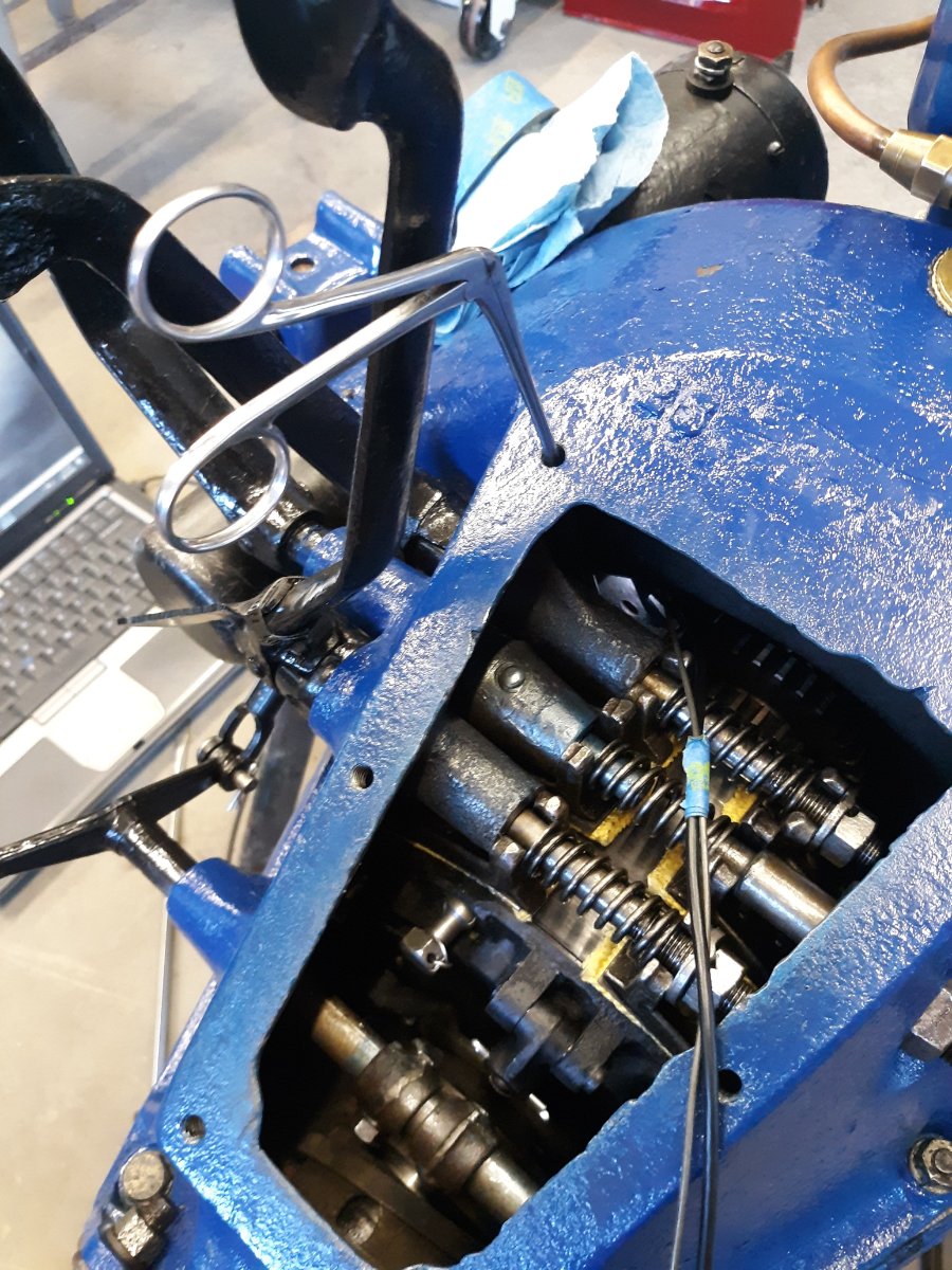

This is how I got the screw out of my trans. The bore scope plugs into the computer USB port. I could not get an angle to grab the screw except through that screw hole. A magnet couldn't get it.

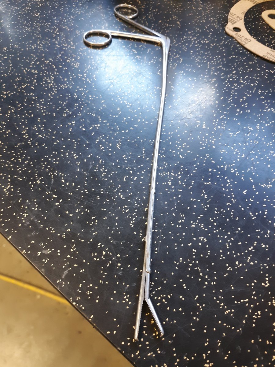

You must get the washer out, don't take a risk leaving it in there.
I once dropped a band spring down into the depths of the transmission, here is how a friend and I got it out.
I removed the oil drain plug, drained the oil, and fished around with a magnet tipped flexible wand through the oil drain hole until I felt the magnet touch the spring (I actually felt the spring click onto the magnet).
Then, I pushed the wand with the spring attached upwards until my friend could see the spring from above through the inspection cover opening.
Then, with the magnetic wand holding the spring in the position where it could be seen from above, I reached down from above with a two-pronged wand, gripped the spring, and pulled it out from above.
Good luck!

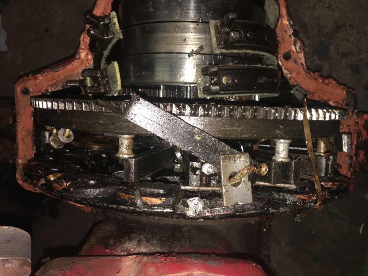

Don’t run it with a washer in the motor because this is the result when a customer did that for 30 minutes
The pan had to welded and the hogs head had two cracks

Do not doubt Tony when he says an errant washer can cause this cascade of damage. It can and will.

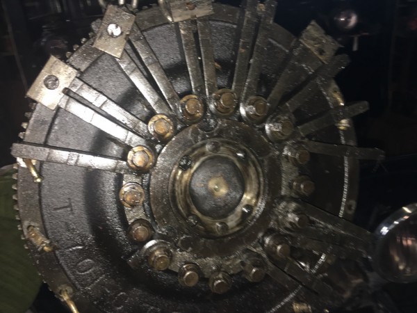

(((((( Found IT ))))))))
Used a wand magnet, didn't work, Used an inspection scope, didn't work.
Finally decided to remove the hogs head and there it was, stuck on the fly wheel magnet.
I didn't know the magnets were left installed when the prior owner switched to a distributor.
Glad I checked because I found an additional washer in the oil tube funnel. Looked like it had already been
run though the gears. It looks like the lock washer for the starter spring bendix bolts.
If it wasn't for you guys insistence to remove it, I was tempted to leave it and cross my fingers.
Now clean up and re-assemble
Thanks everybody!!

Quick Question,
My engine has no magneto installed, anyone know if I can/should remove the magnets off the fly wheel also?
I'm concerned about any weight imbalance. It would make the main bearings carry less of a load.
Thanks Again!!
Thanks Again!!

Magnets on the flywheel and a field coil on the back of the engine block are the magneto. You just don’t use it with the distributor.

The magnets are a vital part of the oiling system.
They can be removed, but you must put a set of oil slinger blades in place to circulate the oil.
Pros and cons to a lightened flywheel...

Word to the wise, the magnets are a safety feature to keep the triple gear pins from backing out. You should have a collar in the place of the magnets. Dan McEarchen makes them.
