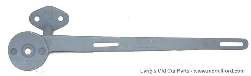

Re: ISO 1921 Kerosene tail light bracket.
I believe after 1919 they were mounted on the spare tire mount. Prior to that the 2-blot bracket was used.
A non-starter/generator 1921 roadster with non-demountable wheels would not have a spare tire bracket. The lamp would utilize the gray bracket Rich posted above which is attached to the deck - see photo of my 1917 roadster below.

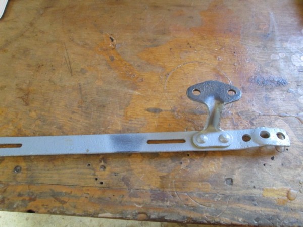

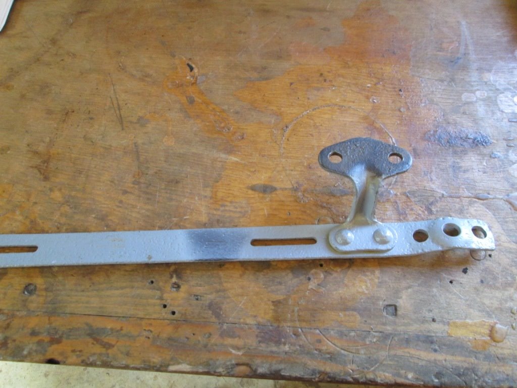

I believe by '21, Ford changed over to the pressed steel type not cast - I might have one & will post a photo.
- Posts: 5610
Here's what a pressed steel non-starter Touring bracket looks like.
I learn something new every day.
I wasn't aware that there were pressed steel brackets prior to the change where the light and bracket were re-designed so the light was turned 90 degrees and had a large clear lens and a small red lens. I don't think I've ever seen a pressed steel touring or roadster bracket like shown above.
Where would the kerosene lamp mount to that type? That mounting is three holes. My car has only two holes for mounting.
Chris
The bracket for the touring car mounts on the underside of the sill, under the body. The bracket for the runabout, like in the photo Richard posted, mounts on the back of the cross frame on the left side, just below the turtle deck.

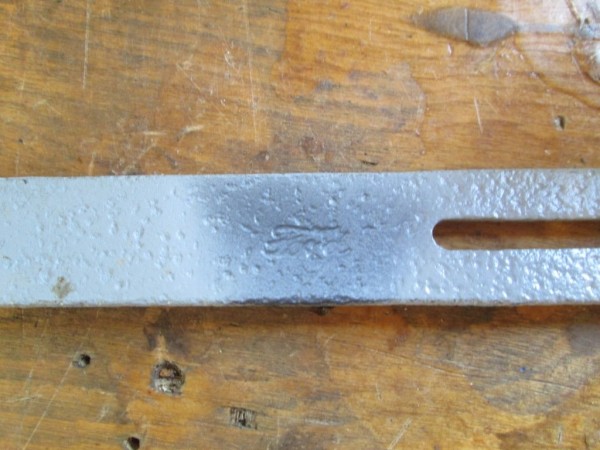

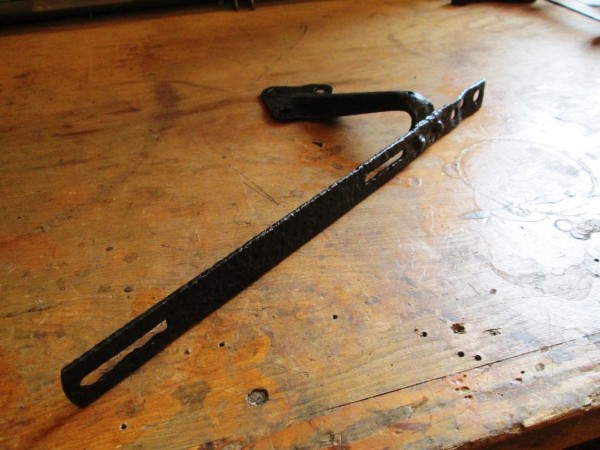

- Posts: 5610
Chris - did you ever locate the correct bracket ? If not, I found one.
- Posts: 5610
Here's an original stamped runabout "Ford" script bracket.
- Posts: 4414
Chris H, I hope you are out there and answer for this! That bracket is quite rare as they were used ONLY on runabouts without the demountable spare tire package. Beyond that, most such runabouts got upgraded later and the original brackets thrown away. The three little holes on the car's left of the license plate mounting locate and hold the tail-lamp. The middle one is for the mounting post (which on some electric tail-lamps has a hole for the wire through its center). The two on each side of the center hole are to cradle rivets in the back of the lamp to hold it straight (centered).
The later change mentioned by Erik Johnson was the "Ford O" lamp used I think in 1925 and later non-electric open models. The oil lamp was turned sideways with the large clear lens to light the license plate, while the very small what used to light the license plate was replaced by a red lens as the tail light. There is a rather long story of dirty politics behind that change. Suffice to say, it was Henry's response to a few states trying to make him do something he was going to do in a couple years anyway, but the states demanded "RIGHT NOW".

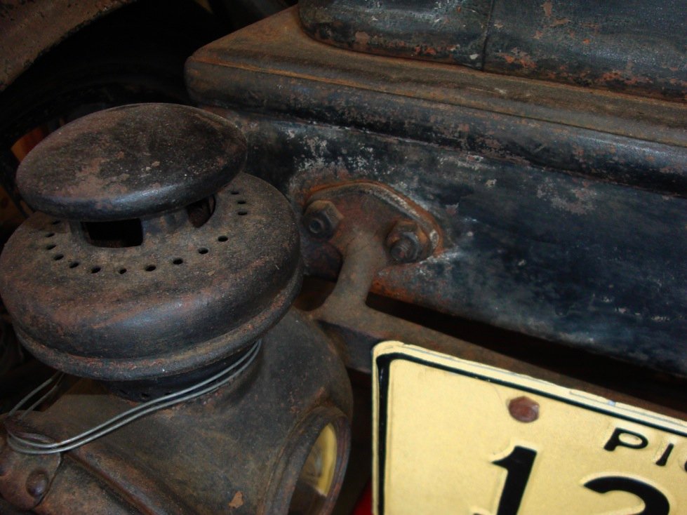

Interesting topic!
Have the cast bracket on my 18 Runabout. Original, far as I can tell. The bolts have been pulled thru the rear cross frame so much they needed a second nut to secure the bracket. It is what it is.
Wondering if I have the correct red-lensed Kero tail lamp...
Like the wire Erik!
Have an O on the bench (missing the red lens), awfully quaint/near backwards lamp. Burner intact, by the way...
Quaint is apparently my word of the day.
Just wish this Runabout had been left with the original rust instead of psychOdelic primer & paint from the late 70's/early 80's.
Duey C, Yeah, those cast brackets are much better than the simple steel ones that replaced them. Much stronger as well.They are also correct for an '18. I gather from a couple discussions that Chris H is trying to get his original car back to as correct as he reasonably can. And the simple steel bracket as I understand it would be correct for his car. Frankly, I wouldn't blame anyone for using the earlier cast bracket. I mean, how many people really would know the difference? As I understand it, there were three main variations of the cast bracket, although all in both runabout AND touring car versions. The '15, two piece bolted. The mostly '16/early '17 two piece riveted. And the late '17 through '20ish one piece casting.
Duey C:
About the bailing wire on the lamp.
Someone thought he would do me a big favor. Without asking, he decided he would bend the tab inside the door that keeps it closed so it would have a tighter fit. He ended up breaking off the tab. I do have a replacement door with the tab intact but I have yet to install it on the lamp.
