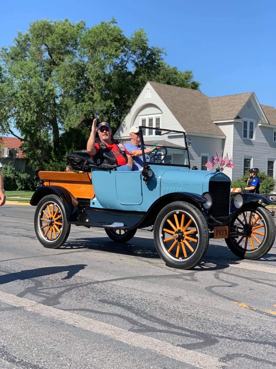

Well, it's been a fun year for me and Woodrow (the name I gave my newly restored T). Three parades, 3 shows and one Best Classic award. There's another cruise-in late October (might be brrrrrr by then). My friend will be stored in an unheated building with OAT's in sub-freezing conditions. I'll have the battery on a tender. Anti-freeze adequate and Stabil in the gas. Full cloth cover.
Are there other storage tips anyone might have? What about raising front & rear ends just enough to take pressure off the wheel bearings, etc?
Missing anything?

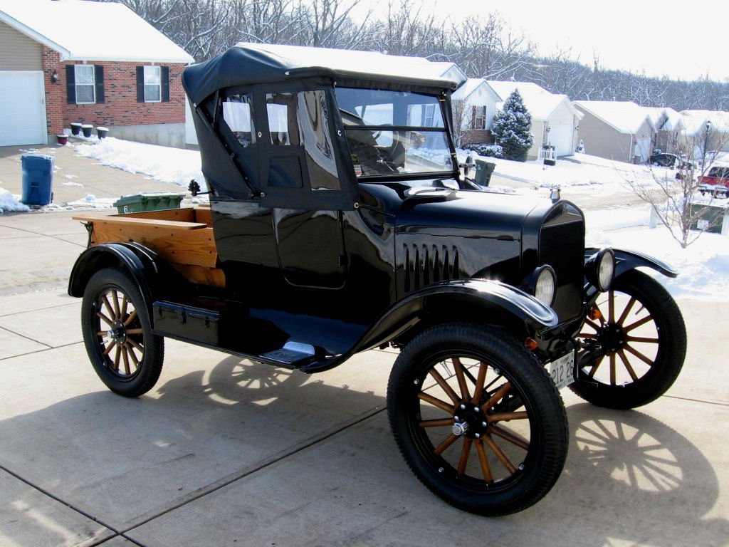

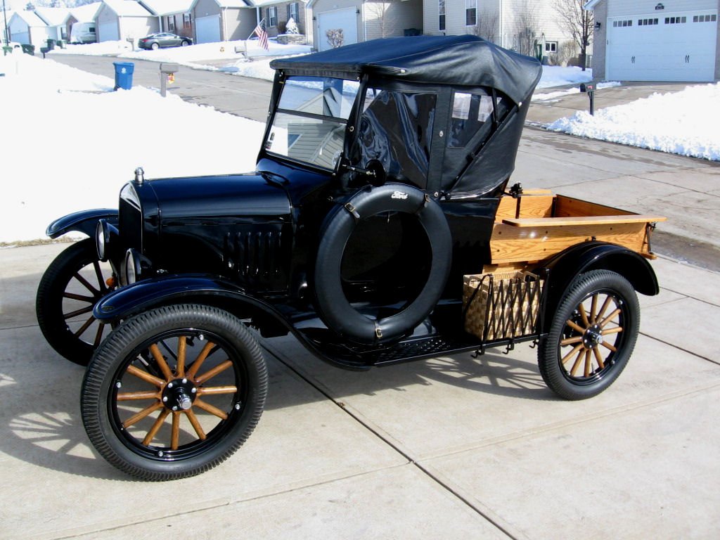

How large is the storage building?
I have a 3 car garage that I had insulated and drywalled. Then I installed one of these, turned down low to take the chill off. I can also turn it up and make the whole garage toasty if need be:
https://www.northerntool.com/shop/tools ... gJiIfD_BwE
I'm able to drive my Betsy year round as long as the roads are clear. I have full side curtains and wear a sweatshirt and jacket along with light gloves and a stocking cap.
