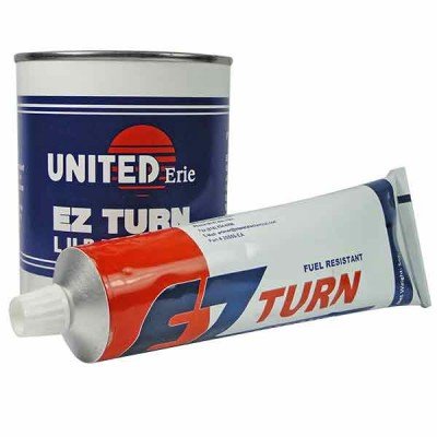

If its the valve cone (main or petcock) EZTurn is recommended - sold by Lang's and others
- Attachments
- ezturnlube.jpg (23.17 KiB) Viewed 3682 times

I did as all of you suggested and even used EZ lube as I stated but no cigar. I finally broke down and ordered a brand new sediment bowl and petcock. Two days of crawling back and forth under the car, gas all over my arms, the wife angry all hell and still ended up spending a $100.00 to make the gas smell go away. Thank you everyone. Frank
