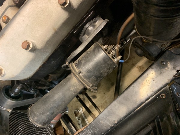

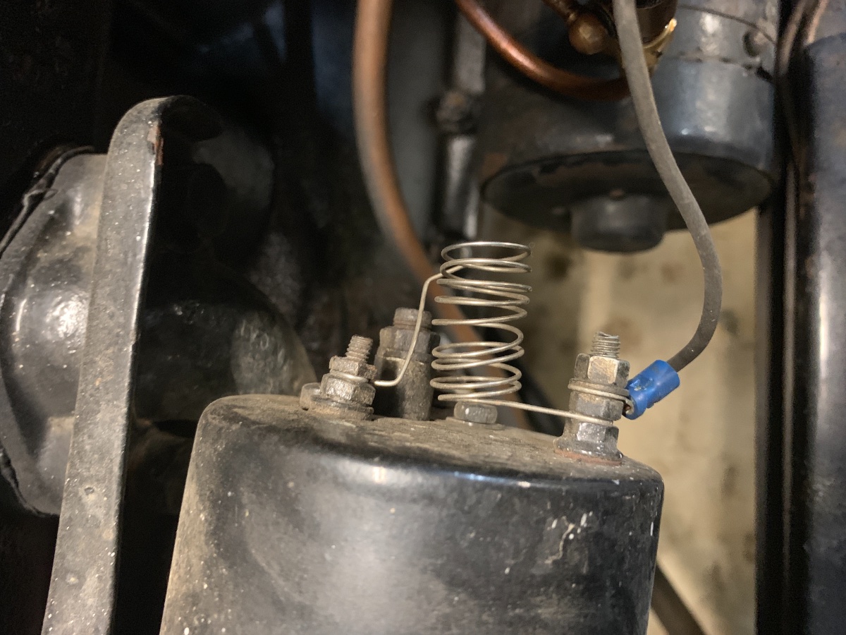

Hi Don I have done this with a piece of 0.8 mm stainless welding wire and cut about a foot and a half off and wound it around a half inch drill shank ant tried it then kept cutting it back until I got the right resistance

Works well Cambin!

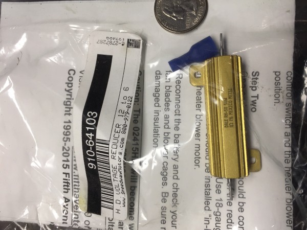

I found this online at autozone
929FC1E2-5A5F-4ABD-A2F1-8695CCEEFAB1.jpeg[/attachment Also found this online at a rat rod supply, haven’t tried tried yet . [attachment=1]929FC1E2-5A5F-4ABD-A2F1-8695CCEEFAB1.jpeg

Double resisyer will do it
A parts guys sell a unit ready to go
VW guy have one as well

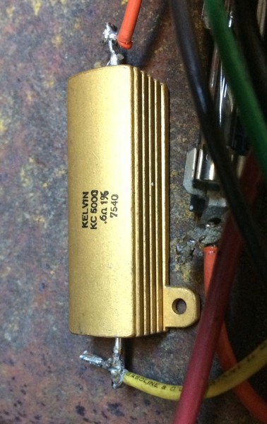

I have used wire like Hank above. I have also used a resistor (see picture). Depending on the current draw resistance values may need to be changed. A voltage divider with equal value resistors would be problematic for something drawing a lot of current. If the Horn drives around 1 Amp at 6 volts, a one ohm series resistor will drop 6 volts. I had a .6 ohm resistor handy it dropped about 4 V leaving 8 V on the horn.
