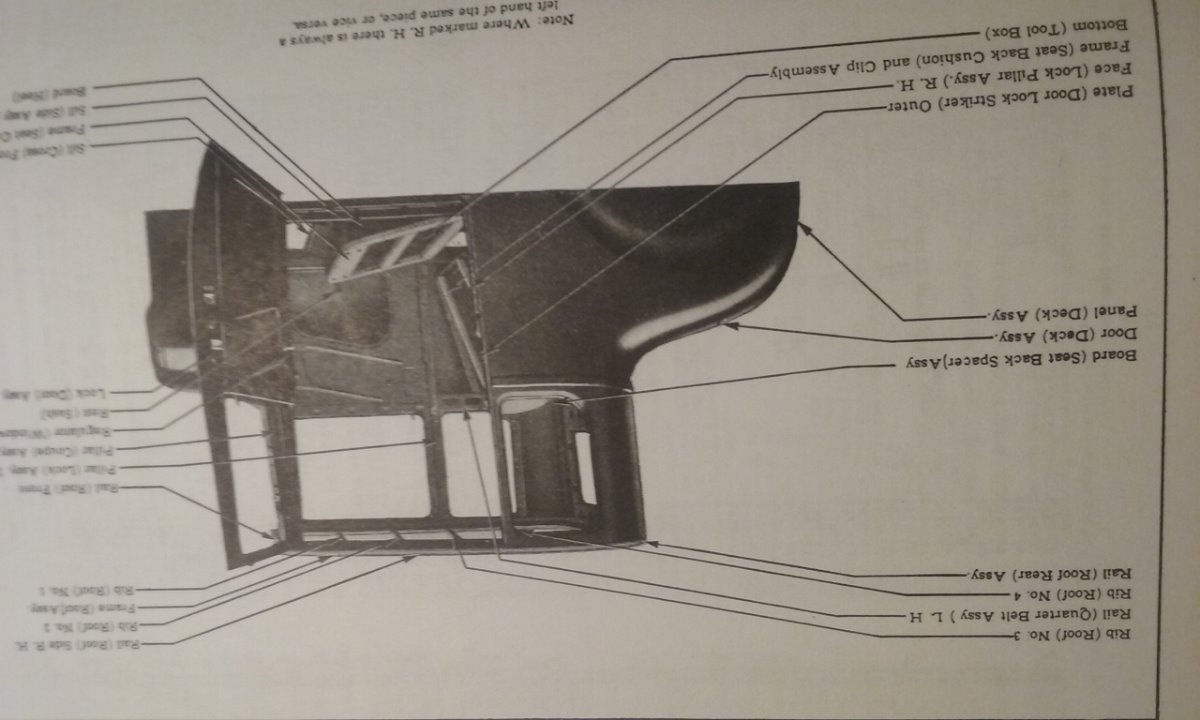

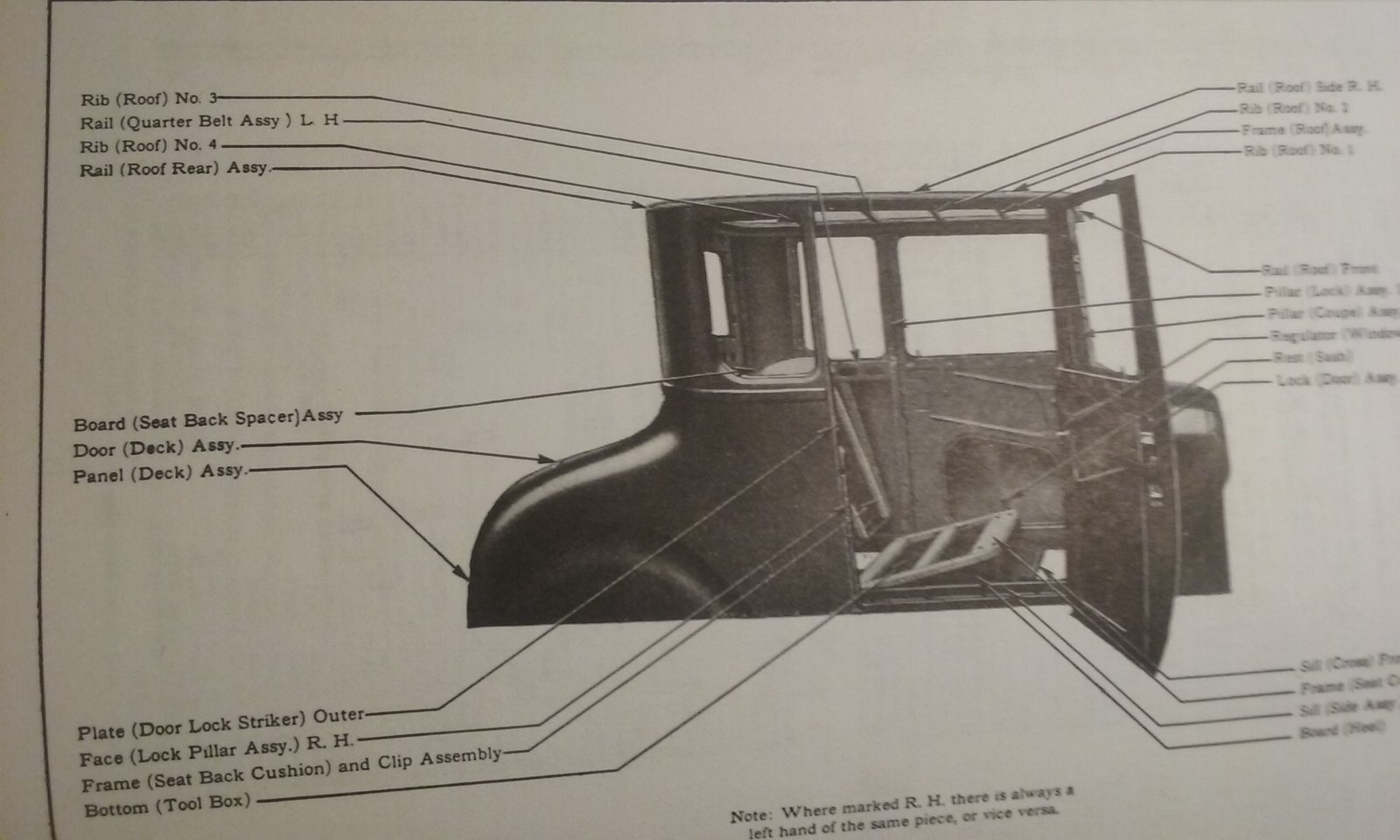

From the Ford Service Bulletin.

I am pretty sure he is talking about a panel that would close off the trunk from the cab not the package shelf. The T nor A had one and I do not recall one on the 33 coupe I worked on. You could see the support and springs when you looked in the trunk even on the later coupes and sedans. At some point the trunks became better finished and may have had some extra bracing, but would have had card board type panels added to finish off the trunk and if you took the card board away you would still be able to see the springs.
