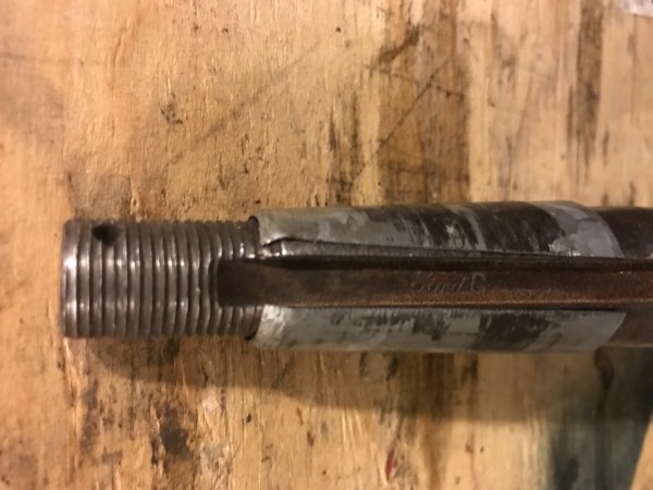

I have been a fan of the new-fangled rear axle seals and have them on most of my T's. The Touring requires an axle shim on both sides to give proper clearances. The shims seem to crawl up into the seal when installing the rear wheel and chew the rubber seal a bit. This time I made a shield out of .030 steel hoping it will stop the shim from entering the seal. There is ample room between the hub and seal so the shield can free float. The ID of the shield is a sliding fit with each axle shaft. Hopefully my new seals will last a very long time. The old ones still worked pretty well even after getting roughed up.

That washer looks like a good way to cut the axle as it is floating and any rotation of the hub can turn it. I would maybe trimming some off the shim first or put the shim into the hub first then install the wheel. That way it will works to the outside as you put it on. If the shim is moving in use, then there are other issues, like not getting tight on the taper, loose hub worn axle taper.

As I said the shims "seem to crawl up into the seal when installing the rear wheel". Not moving in use. I have found no good way to keep the shim from sliding along the axle with the hub AT INSTALLATION. The spacer should turn with the axle and hub. Also it is softer than the axle shaft. If problems develop with this I will post it here first.

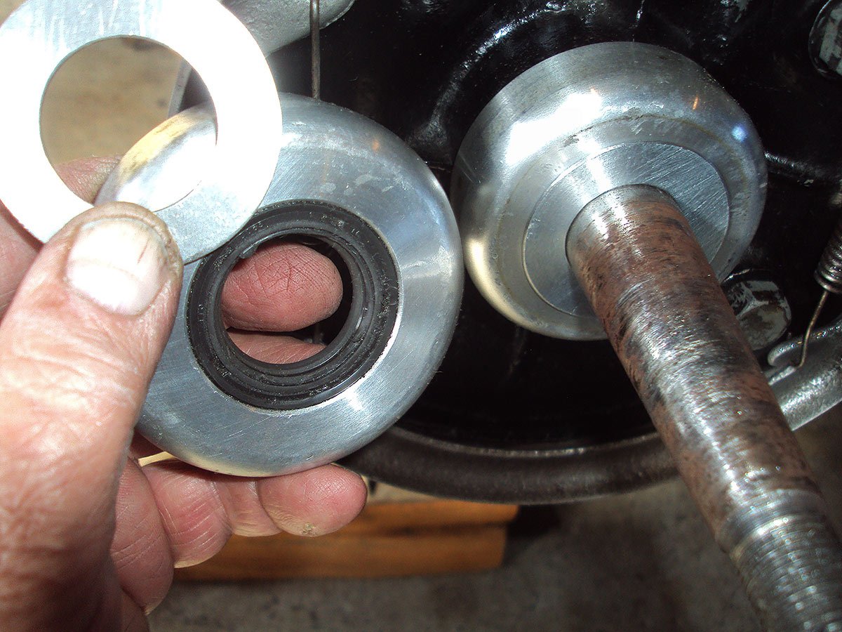

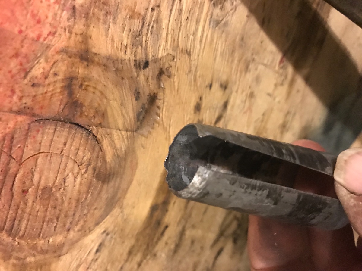

Rich looks like a great idea and thanks for sharing. I have had the same problem. This is what I have done with some success.

That looks like a great fix John. The idea of putting the shim in the hub rather than on the axle shaft sounds like a good fix too. I will inspect the assembly after some miles to see if the shield is causing any wear.
