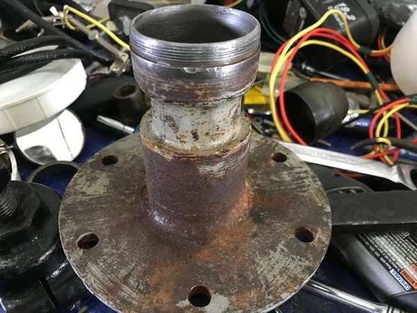

I recently bought a 30 x 3.5 demountable wheel with the intention of sending it off to be re-spoked. I have one front wheel with a slight wiggle and this was to be it's replacement. Awhile back I purchased a hub thread chaser from Snyders which I used successfully to clean up the threads on my other wheels. Even though the threads look good on the new one (I thought) I can't get the thread chaser to turn on, much less clean the threads. A hub cap will not turn on either.
Is there anyone out there who could "renew" the threads on this hub or is it junk? I appreciate any suggestions.

I’ve always had good success with using a thread file on hubs.
They also work great on spindles as well.

An old timer friend taught me a lesson on this subject. I tried for several days to get the chaser to grab and clean the threads. I went to "Bill" who reversed the application of the thread chaser. I was applying the chaser to the stationary wheel. He put the chaser in a vice and then put the wheel on top of it. This allowed him to focus on leveling the wheel on the chase while the wheel itself provided the down force to grab the threads. It took him about five minutes and he was able to move the wheel down the threads. Try it and it may work for you also. Dick C.

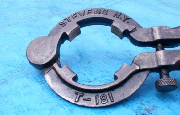

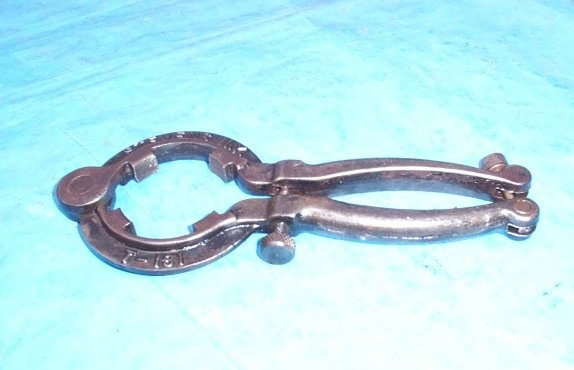

The Stevens T-181 is the tool for this, but it's rare and usually expensive. I haven't made my own version yet, but I believe Andre in Belgium posted pictures of one he made.
