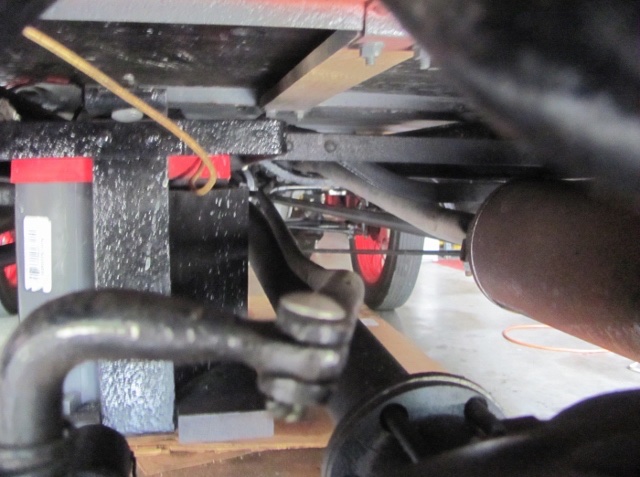

Believe your question is what position is the little arm on the shift lock assembly for putting the Ruckstell into gear? Since you don't have the linkage rod or the hand lever at the u-joint mount.
The little shift lock 'arm' on the Ruckstell when in full rear ward position, to the rear of the axle, keeps the differential in standard Ford gearing or 'high'. When the little shift lock 'arm' is pulled forward, toward the front, the Ruckstell is now engaged and puts the differential into Ruckstell gearing or 'low'.
- Posts: 5498
Re: How do you work a Ruckstell?
There is no "HIGH" in a Ruckstell, ether the under drive is engaged or it not . With the lever pulled back (to the rear of the car) and it is disengaged or pushed forward (to the front of the car) the Ruckstell (under drive) is engaged (this is at the rear end). At the handle (when it is installed) the action is reversed only for the handle. IE; when the driver pulls the handle back it pulls the shifting lever at the rear end forward. This all assuming that the shift lever at the rear end is installed the correct direction, pointing to the pumpkin.

So basically it is an on-off lever. Either you are in Ruckstell or you are not? Is that correct?
Thank you for the picture Dan.
