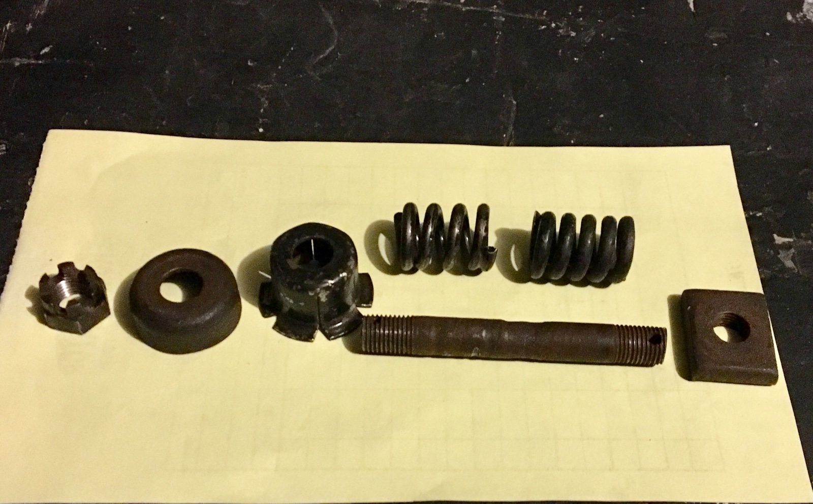

I’m a bit flummoxed as to how the radiator mounting hardware goes on my 24 Touring.
My car came with a farm patchwork of nuts and bolts holding down the radiator that wasn’t doing a very good job. However I secured a more stock appearing set that is nicely weathered to match my car and now that my new Berg’s radiator is here, I want to get it mounted.
Can someone please help me figure out the order that the various pieces are installed and how the radiator and shell fit into that order?

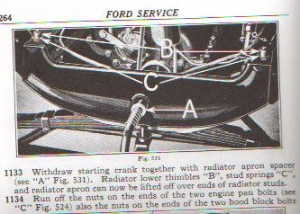

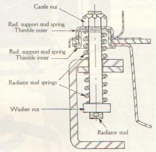

Here are some drawings from a previous thread. From memory the studs are slightly longer on the 26/27 kit but the rest is the same.

Assemble the lower portion first in the frame cavity, stud, spring, square piece, and cotter pin. Use a chisel or wedge to jack up the lower assembly for the stud to sit higher. This will help to align all the upper parts and have some length of stud to get the top nut started. Once it is all tightened up the chisel will fall out.
