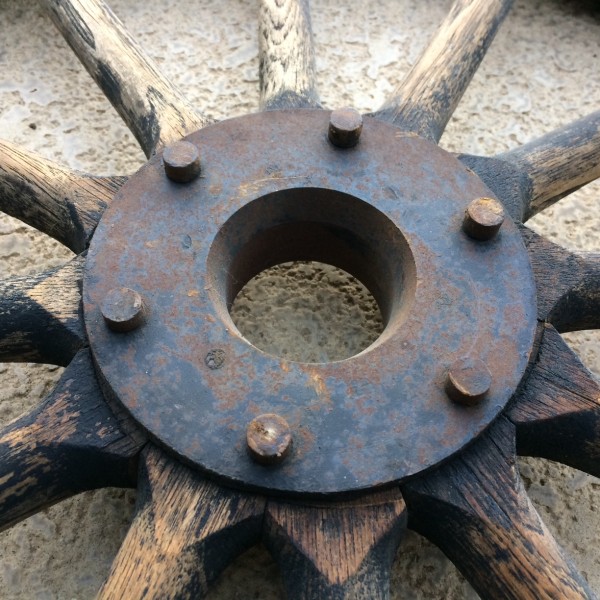

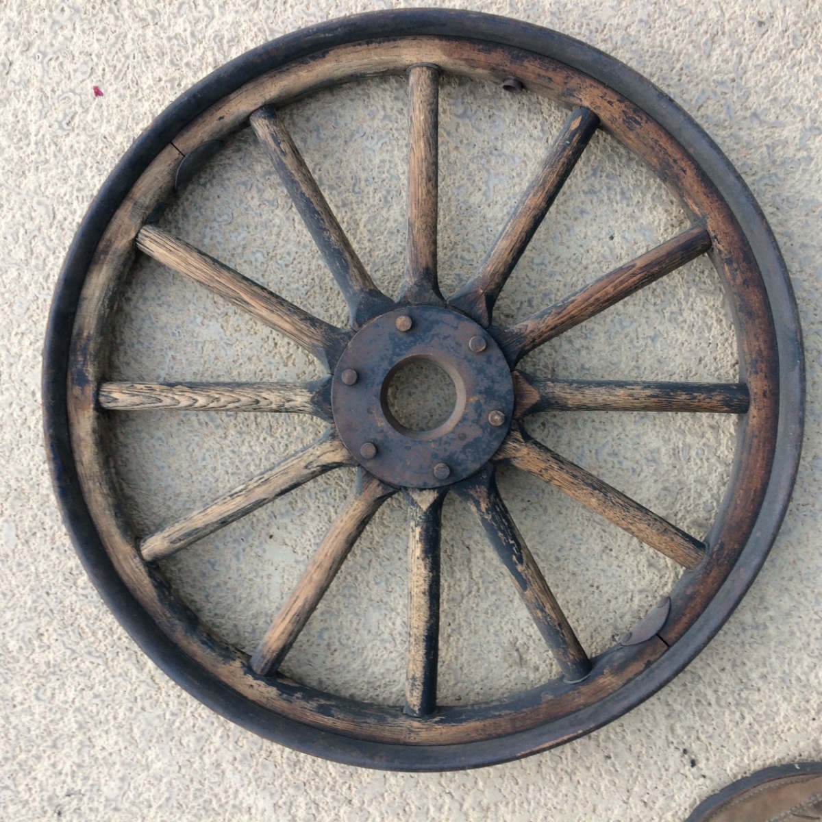

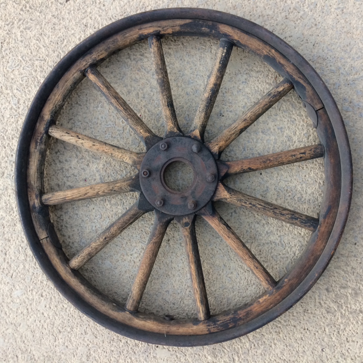

I got this wheel with the interesting hub along with a bunch other Model T wheels. Can anyone explain this to me?
Thanks!
Matt

To me (and this is just my opinion, please do not put any stake in it) it looks like a hay wagon wheel - no high speed, frequent grease, and built to take a load. I know I may be WAY off, but having dealt with hay wagons before, that, with that taper, is what it looks like to me....

It looks like a demountable conversion. Spare tire is already mounted and filled with air. I would guess that there would be a hub on the car with six holes that the pins locate in, and a single center nut holds it on, like a modern "Knockoff" hub.

I agree it does look like some sort of demountable conversion. Has anyone seen one? Does anybody have more information?
Matt
