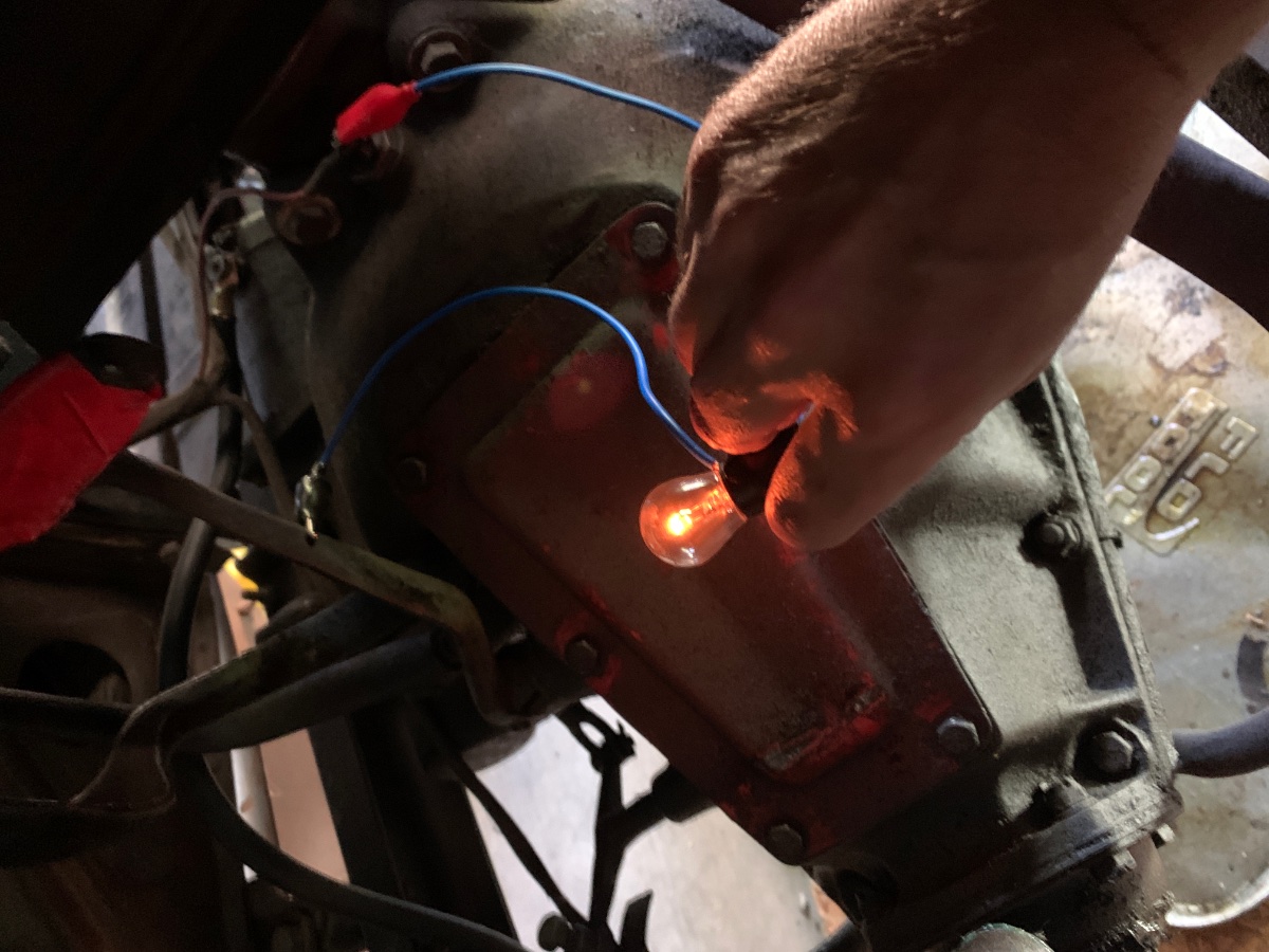

Next I checked the magneto itself with a 1156 bulb and it in fact lights up.
What Am missing? Any ideas as to why it runs on BAT but not on MAG?

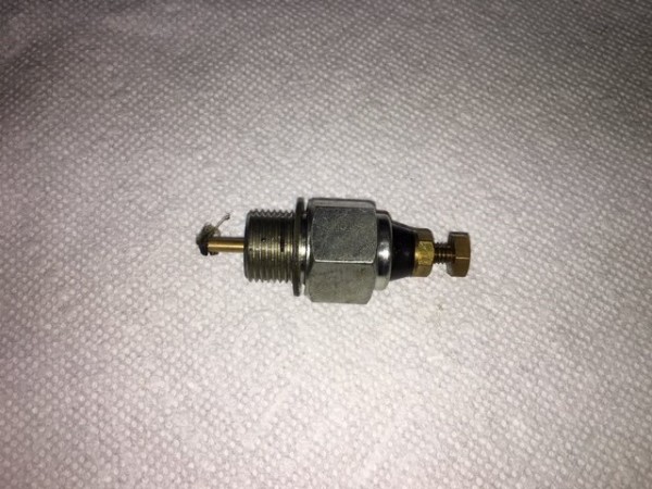

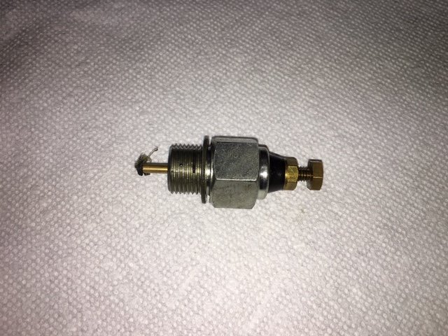

If that is as bright as your magneto will light the bulb, I suspect a weak mag. But, if it ran good on mag while on the tour, then I'd suspect a piece of lint, or trash is lodged against the mag post. Unscrew the mag post, shine a light through the hole, and see if there is anything that might be breaking contact with the solder blob. A mirror may be required to see the blob. Keep your fingers crossed.

Tubby, I'd like to add this photo because your problem has happened to me (more than once over the years).

I pulled the probe out. It was clean. I even stretched the spring a bit to make sure it had good contact. I will have to check the actual solder blob and make sure it is clean as well. My father just acquired the T last year so we don’t have much of a history on the magneto itself.

I would say if that is just at idle I don't think it's too bad. Might just be the switch it self need cleaning or attention. With the bulb attached like it is, do a check with an analog meter set to AC. Hook the leads from the meter to the same points as the bulb. Do this at different RPMs. This will not work with a digital meter unless you have are real high quality meter that can filter out the back ground noise from the magneto.
