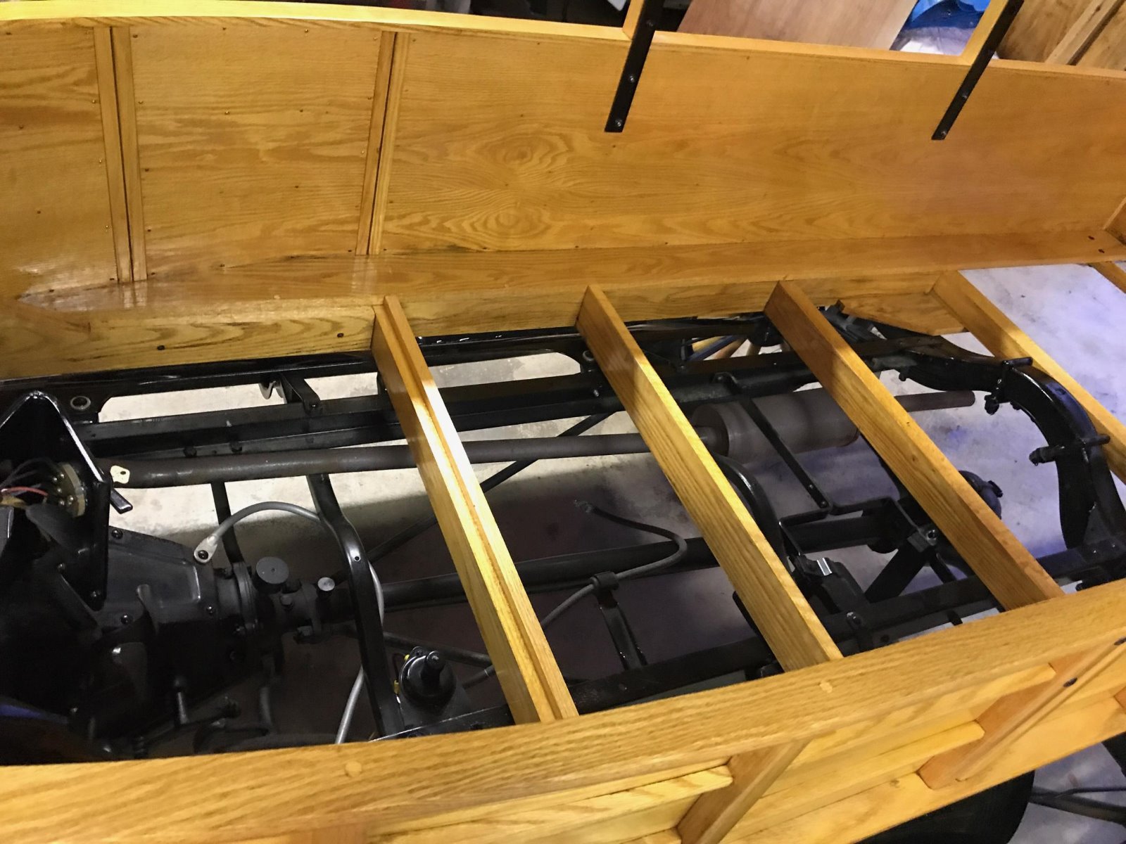

Hi all, I am building a 1922 Depot Hack and I am ready to attach the Pleasantville Manufacturing Body to the frame. My question is how do I do that ? Do I need to add angle brackets to it or do you just drill through the cross members into the frame ? One problem with this car is that the rear frame (wishbone) extends beyond the wood gussets where I assumed you should be fastening to and the top of the wishbone extends above the floor.I believe the problem I have is that the body was probably built for a 1922 frame but my frame is a 1926 which on a 1926 frame the wishbone is longer and higher. I am not changing the body or frame so any suggestions ? I did think of cutting a hole in the floor to give it clearance  and the rear seat would cover the hole up and making some wood blocks for the ends of the frame and attaching it to the underside of the body. just an idea.. Thank you for the help !!

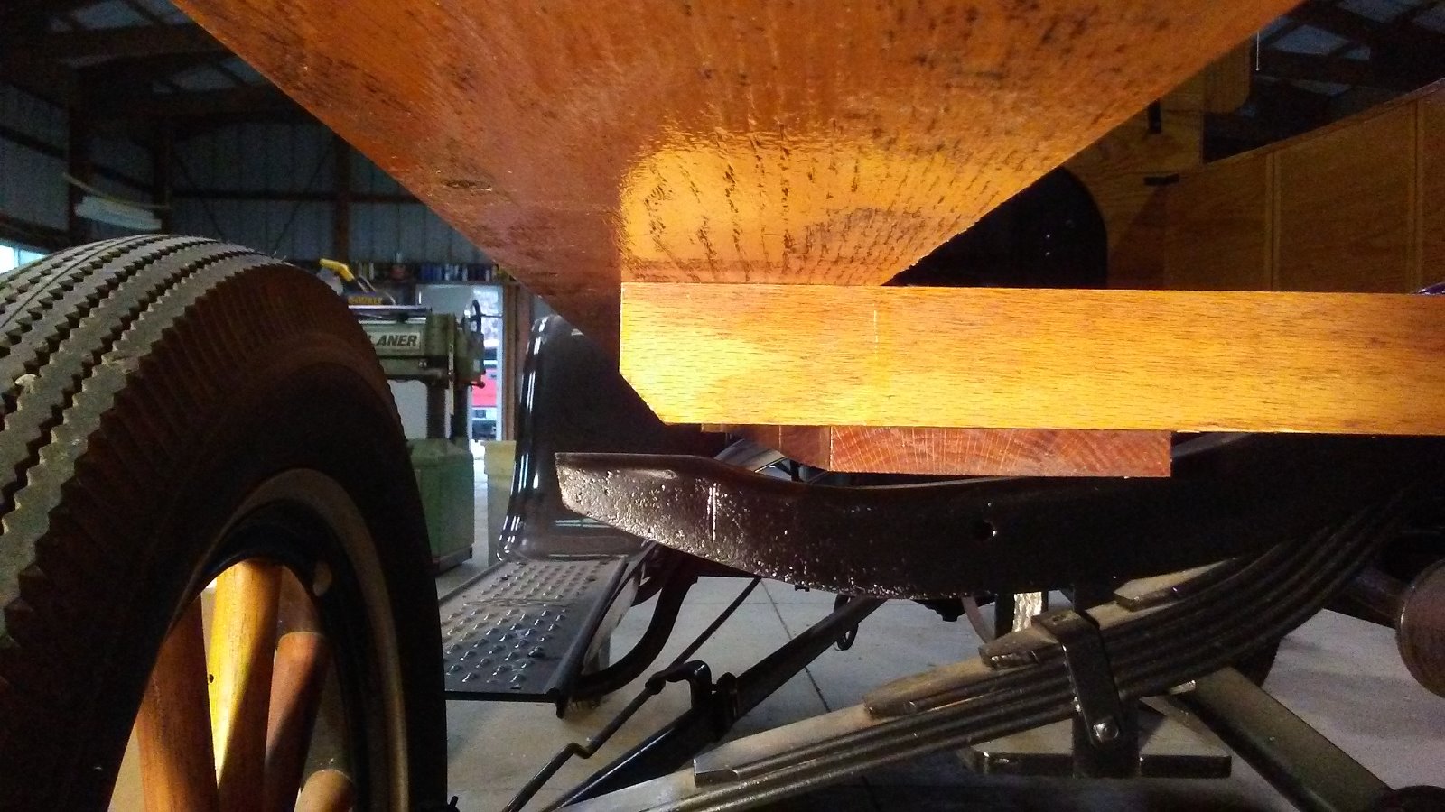

I can’t help with the how to attach to the frame as my Hack body is a modern Sieger.  (The Sieger sits on flat side 2x4 oak sills then has body blocks that pick up existing frame holes)
Some do raise the body’s to clear the 26/27 hump issues. To me that makes the Hack top heavy in appearance and function...and then won’t fit in a standard garage door opening or enclosed trailer.
I took a flyer and tried something, the hole was cut to clear the frame hump...then I bought a Model A trunk patch panel from Howells (they actually had one on the shelf) . I never got around to painting it...maybe I’ll try yet this month?

Martin, using the correct brackets doesn’t raise the height at all, unless you add a rubber spacer of some type.   What it does do Is spread the load out further side to side, which is good.     I think it’s been determined aftermarket bodies used brackets with elongated slotted holes in the attachment point, to allow for a bit of a variance.   If you are building it, it will work pretty well to use the standard body mount bracket that the suppliers sell, or used ones guys have available.  Good luck, fun project! One of my pics show all three mounting brackets, attached to a frame rail and main body piece, which is hanging here. .
