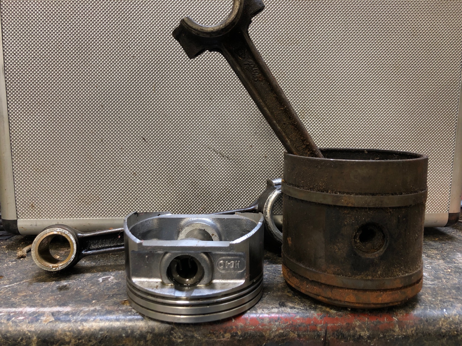

Kevin, they aren’t bad pistons. I wanted to see what else was out there and available. Here’s a picture of a comparison with a cast iron original piston. The A rods have to be bushed to the new wrist pin size of .870 and other than that is stock .010 under main bearing A rod.

Those look like a interesting piston choice.
To compensate for the flat top I would consider offsetting the wrist pin bushings. Obviously need to be careful that the rings stay in the cylinder bore.
