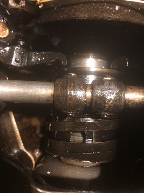

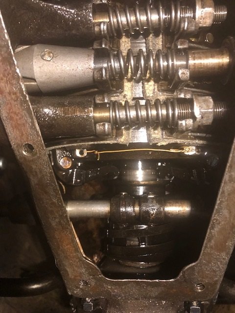

Hello Ignacio,
Looking at your photos I can not tell you what is wrong. I am going to make some assumptions and try to help you understand how the transmission works and to trouble shoot the problem.
I believe the transmission was working correctly before you removed the hogs head.
Based on this current post it implies that low and reverse are working correctly, and that is significant information. What that means is power is being transferred form the engine/flywheel through the triple gears, to the brake drum, and to the output shaft. In these modes the clutch must be released. It is also is a good indication that the rivets that attach the clutch cover plate to the output shaft are not sheared.
To go into high gear the clutch must be engaged. In this mode power is transferred from the transmission main shaft to the clutch drum. Then through the clutch discs to the brake drum and then to the output shaft. The clutch collar which is controlled by the clutch shaft which is activated by the low pedal (and hand brake) is what determines whether the clutch is engaged or disengaged. Now there are three fingers on the clutch cover. For the clutch to be engaged those three finger must not have any pressure on them, you should be able to wiggle them freely.
Now what baffles me is that it appears your car used to go into high and now it does not. From your photos one photo appears to show that one clutch finger I can see does appear to have the clearance. I can not tell about the others. Please check all three.
I hope this information help you solve your problem.
Terry

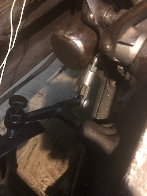

ivaldes1
Topic author - Posts: 960
- Joined: Mon Jan 07, 2019 1:32 am
- First Name: Ignacio
- Last Name: Valdes
- Location: Houston, Tx
Re: No high gear after changing bands and cams.
I found this article: https://modeltfordfix.com/adjusting-the ... nd-clutch/
I put in a new slow speed connection yoke since my old one was worn out. Per the article it has to have 1/16th play. I shortened it and will retry tomorrow. I hope I don't have to take the whole thing apart again.
-- IV

Joe Reid
- Posts: 270
- First Name: Joe
- Last Name: Reid
- Location: Almond WI
Is your clutch fork engaged on the collar or is it behind it?

ivaldes1
- Last Name: Valdes
I tested it after tightening up the yoke so it had give in the clutch lever. Thankfully high-gear came back. However, when my foot goes off the slow speed pedal it doesn't fully engage high gear unless I pull the pedal back towards me with my foot slightly. It seems like I need to lengthen the yoke a bit? Or tighten the yoke a bit?

erkbrn
- Posts: 71
- Joined: Sat May 11, 2019 2:24 am
- First Name: Eric
- Last Name: Brown
- * REQUIRED* Type and Year of Model Ts owned: 1915 Speedster
- Location: San Diego
I just replaced my bands as well, and have noticed the problem with the pedal not wanting to return on its own when trying to go into high gear. However, this problem only appeared after driving around for a little bit. I assume this just means the bands are settling in and the low band needs to be tightened another turn or two (I have read somewhere else on here that this can be the case). Yours looks pretty tight already in the picture, so I'm not sure the same reason applies. I'll check the yoke on mine to see if it's going over center and causing the problem.
