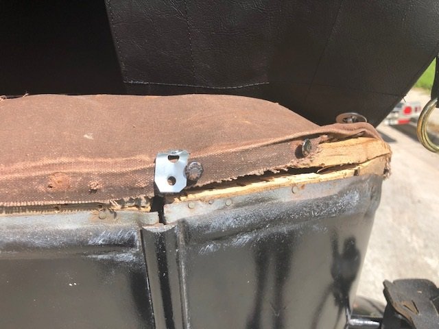

1) Hit my garage door with my newly rebuilt top backing it out of the garage and tore out the 2 back flaps and broke the rear seat backrest wood Picture 3 shows broken back rest wood, common sense's torn out. Oops! Need new rear seat back rest wood, don't know where to get it.

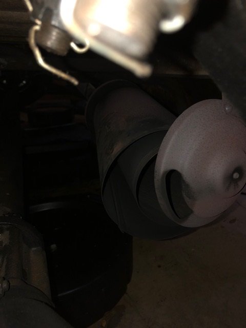

4) Picture 1: Blew out my muffler when switched from battery to magneto then back again when it did not work. Discovered when I returned home that the nut had come off so I reassembled it and put a new lock washer and nut on so maybe it will be ok.

My muffler lost its nut and washer on the last tour, oh well only 98 years young!
The suppliers carry the tack strip. Sounds like a fun time. Best we can do on a club tour is maybe 3-4 average, the rest are A's or modern.

1 R.V. Anderson's bother Jonathan Anderson makes new tack strips.

4 Yes, the lock washer may be the cure.

The tack rail looks split but not shattered. One option might be to strip back the upholstery and repair the tack rail with marine epoxy and clamps.
West System epoxy with a bit of thickener to make the epoxy creamier, spoon in with a tongue depressor and then lots of clamps. It might be enough to repair the tack rail and save a larger job of replacing it.
I used the West epoxy to repair and strengthen the old original on my T where it was cracking and to fill in the old tack holes. So far its holding well.

Nova Scotia Jeff: will Quick Poly work? I have that.

It is very easy to "blow" that type muffler. I like to put a few tack welds around the end plates. Then put on the nut with a lock washer. Mine haven't blown in about 20 years.

I tried Quick Poly once and was disappointed and will never use it again. I don't think it would have the needed strength to hold every thing back together when under stress from the tension on of the top when its up.
I prefer the West System epoxy. If you google it they have a lot of information on their website on the many different ways it can be used. Wood repair and restoration is one of the main ones. When I did overload load it (usually unplanned too) the wood would break before the epoxy did when its used right.
The West Epoxy should be thickened with the filler powder for use for this repair, it helps to fill in small voids and cracks when the two pieces don't come back together 100 percent tight. The straight from the can epoxy is a bit runny which helps it soak into wood when doing general bonding, but it would tend to drip out when doing this repair. I have used it in building new wood body parts and repairing/splicing old and new wood sections for repair/rebuilds. I also found that it helps to let it cure for a few days before sanding to better harden up too. I'm a fan.
Second choice would be a good name brand two part epoxy intended for carpentry wood work. There are others that would work will too.
