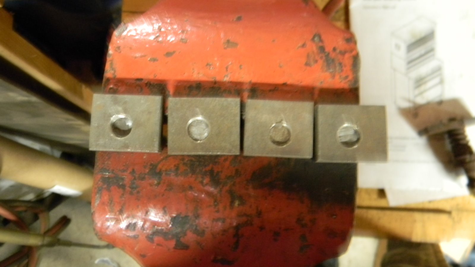

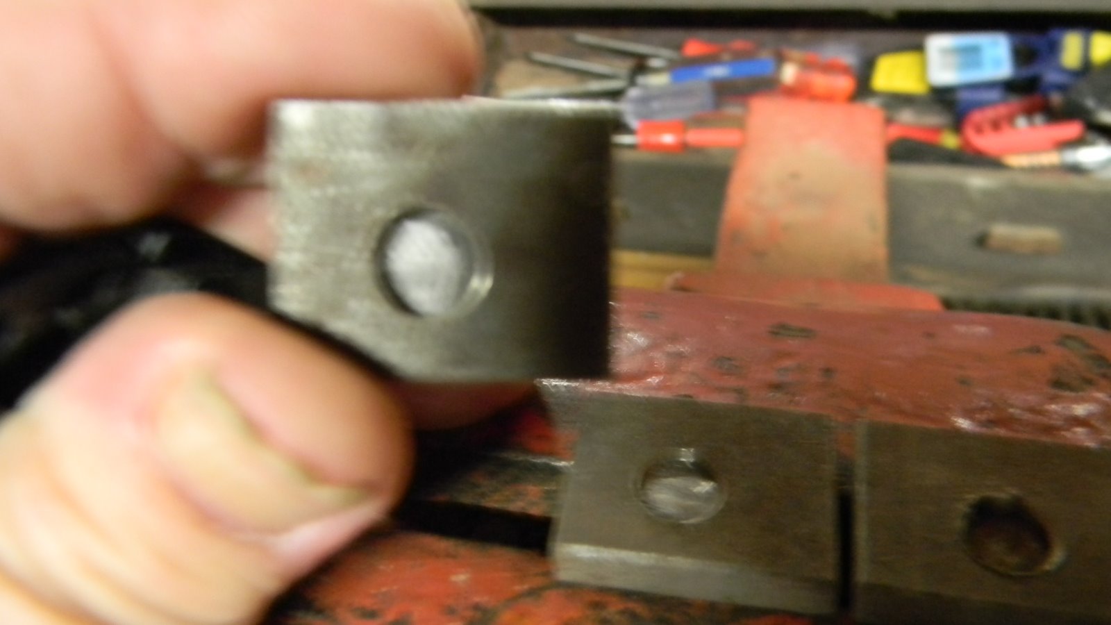

Looking at originals they are all over the map
1" x 7/8" on most but the holes are all over the map, none are centered and they all vary about .0020-.0085
the later style measures 2 5/16" x 3/4" with centered hole, I might have to get the prints but not a crucial part.
I will look for a few more, if anyone has some please let me know your measurements, Bob

Bob, make them all long ones. Those who must have the short versions and the grief they can give, can always cut them down to suit. They probably should not be plated either. Then, to be absolutely original, they should be sheared rather than sawn to length!
I too, have found some with the hole drilled off centre in relation to the width. This can be helpful when trying to clear the fender iron mounting bolt heads. I doubt it was done intentionally, as the hurly-burly of the production line may well have been to rapid for the fitters to mount them in a particular orientation.

Over the years looking at and going over cans and boxes of small T parts I have also noticed the radiator nuts with thread holes drilled here and there.
I have a feeling that on Fords assembly lines there was more than a few that were thrown on the floor and wound up in a scrap pile because they wouldn’t fit easily in assembly.
There was probably boxes of the nuts and the assembly line guys grabbed for the “good ones” they knew would work the best.
From a mechanics point of view of course!
The suppliers who made them weren’t to concerned about being really precise and we have the proof to show it.
