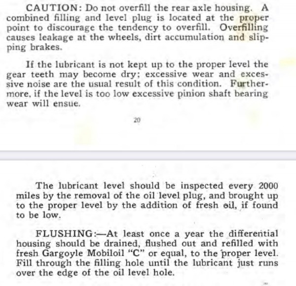

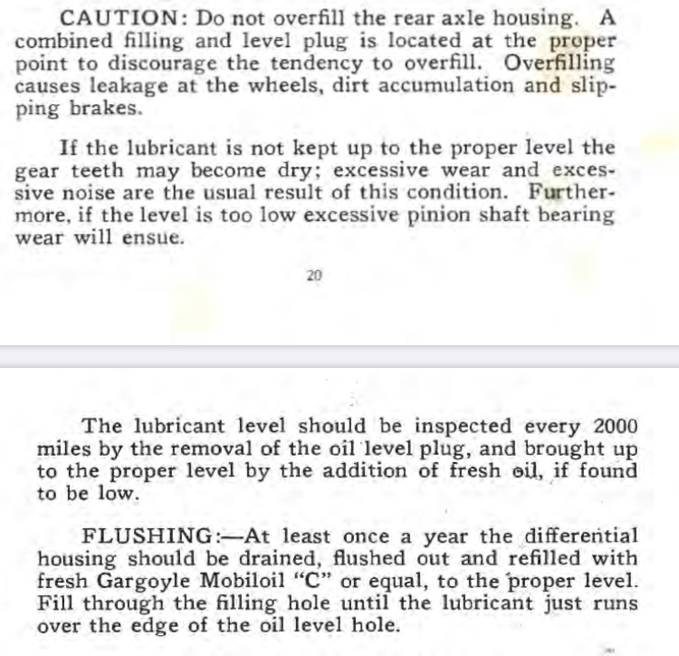

Re: Oil level for car Ruckstell
Ruckstell instructions. Mine is filled to just tiny dripping at the oil fill /level check plug.
So what exactly is the equivalent of “Gargoyle Mobiloil C” ?
