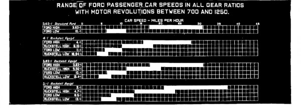

Bill
That's the same way of use on the '27 touring. Live in flat land FL, so don't use the Ruckstell much at all. Regardless, won't shift it thru the gears all the time, would have a Model A if I wanted to shift
My Ruckstell-equipped rear axle has std. Ford 3:63 ratio.
So, just use it as '2nd gear' when hill climbing, pull the hand lever back to the seat edge, while putting low pedal to 'neutral' and reducing throttle to match road and engine rpm's or engine speed. At about 15mph or so, when finished with hill climb, right at the crest, press low pedal into neutral and reduce throttle, and push the hand lever to the dash, back into Ford.
If very steep hill, ride down it slow still in Ruckstell and shift back to Ford when on level.
As for those who run in Ruckstell all the time, what engine speed?
When in Ruckstell, my engine strains if much over 20 mph.
Click on graph to enlarge for viewing

Nice chart Dan
I’m in the last group, 3:1, I run Ruckstell generally up to about 25-30mph. The higher ratio makes it more necessary for Ruckstell, especially for braking, but I can climb most hills around here in Ford high/direct. But my engine is not stock.
It takes some practice, but shifting is second nature to me. A lot easier to show someone than to splain it.
