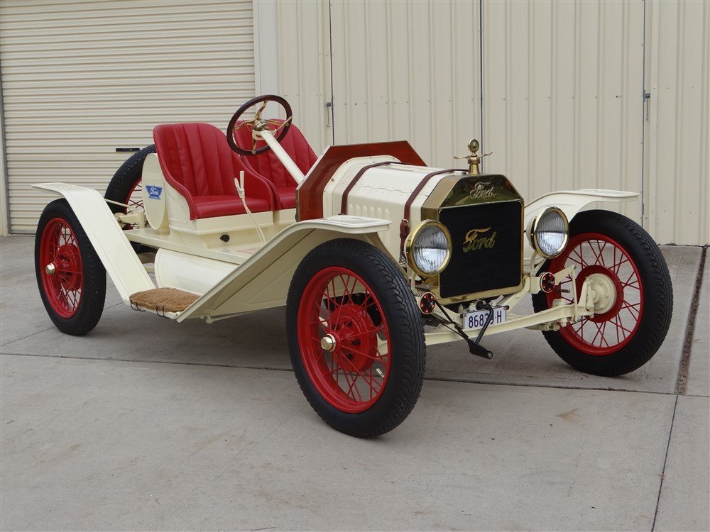

Hi Folks,
Next weekend is our car clubs annual "Show-n-Shine" and I'm getting my new-ish Speedster ready for its first Club outing.
I've been polishing brass for the first time (for the car, not me) and its taking an eternity because its new, I suppose. I'm just about finished, but there is a problem that you might be able to advise me on.
