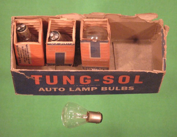

I ran a #1009 bulb for the magneto lights in my 1920 ice cream truck I don't remember what kind of bulbs that I first installed in 1965 but they didn't last long and neither did subsequent replacements. Then in around 1972 I put in these 1009 bulbs (I don't know any other description, volts, watts, amps, other than the number on the base) they lasted 40 years and are still in the truck although it never goes out at night any more. They were plenty bright at speed and adequate at 25 MPH. The truck has ribbed lenses so the bulb was not easily visible which was good because it's not a big great early looking bulb. It's a small bulb, looks like it belongs in an electric cowl or tail light, that size. But they worked great and I used to drive it at night at speed across the San Francisco/Oakland Bay Bridge.
