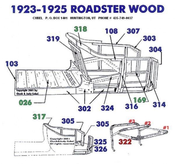

Is anyone making these wood parts? If so can someone please point me in the right direction. I tried Fordwood but got no response.
It's the belt rail (318 at Fordwood) I need.

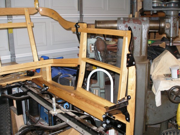

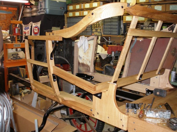

Though not the best photos, here is the 318 part that I made from a block of ash (as was the rest of the framework). Careful bandsaw work and lots of thought as to where to begin and end the part such that the grain worked with me and not against me resulting in unaccepable weak end grain at one end. I don't believe it would hurt at all to laminate 3 pieces of wood such that the curve can be cut out and end up with good strong grain structure at each end...I just was lucky to have a friendly lumber yard who would create the rough dimensions of lumber that I needed so that I could cut, mill, shape, etc., what I needed. Just be sure to use a good marine epoxy to glue them together:

Nether the 1923 or 1927 body parts books call it a belt rail, just rail. Nice wood work Scott.

That corner piece is much stronger if made with laminates of plywood. Cut from a single block of timber, it will have short grain at each end which makes it subject to splitting under load. It is easy to cut the pieces from thin plywood. These can be clamped in place on the body, gluing two pieces together at a time. When the glue is set, other pieces can be added. There is no need for total accuracy, as the glued pieces can be trimmed/filed to fit once laminated to the required thickness. Being formed on the body they will be fitted to means they will fit.
