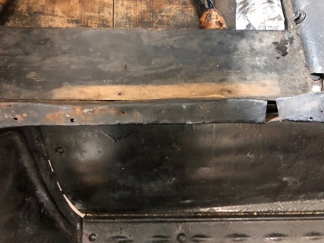

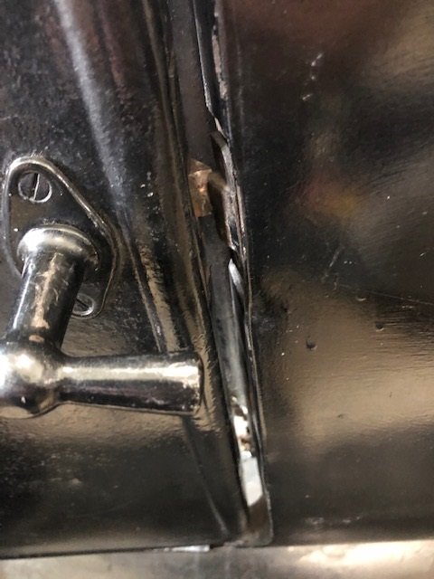

See picture from above 22 touring rear door closed at the latch. What should the gap be on a door? Mine seems to be excessive. Why would it be wide like that?
See picture below outside facing in, is the big notch in the rear door jamb of a 22 touring body normal?

Yes, that is a bit excessive. Probably due to some issues with the wood, or possibly frame sagging. I am imagining that at this time you do not wish to do a total restoration.
However, you really need to assess the conditions and try to determine just where the problem is. There is likely a simple "adjustment" that may help quite a bit, and give you several years of good touring and enjoyment. Often, adjusting and/or shimming of the individual body bolts can push the back of the body up slightly and in turn push the rear tub forward enough to make the door close much better.
Of course, the only real or right fix is a full restoration. But maybe you would prefer to drive and enjoy the car for a few years first. No real harm in that. I have known many people to do that.
