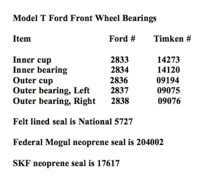

The inside the front wheel dust cover can be had at most automotive parts stores like NAPA, pep boys, etc. Here are some part numbers for them to look up. They can usually cross refetence one brands part number for the brand they carry in house faster than you can order and ship from the usual model t vendors.
Chicago rawhide: cr17617
Federal mogul nat'l oil seal: 204002

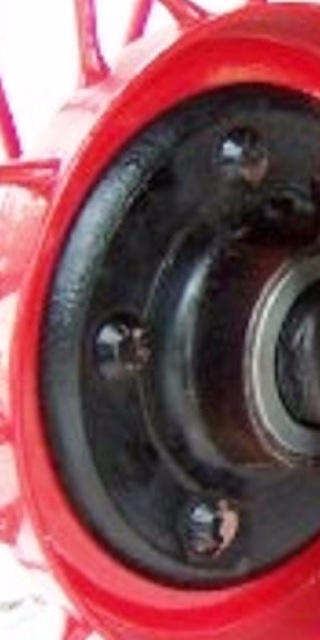

Humblej has it right. go with the newer style (rubber). It can't be seen for the purists & it's a longer lasting piece.

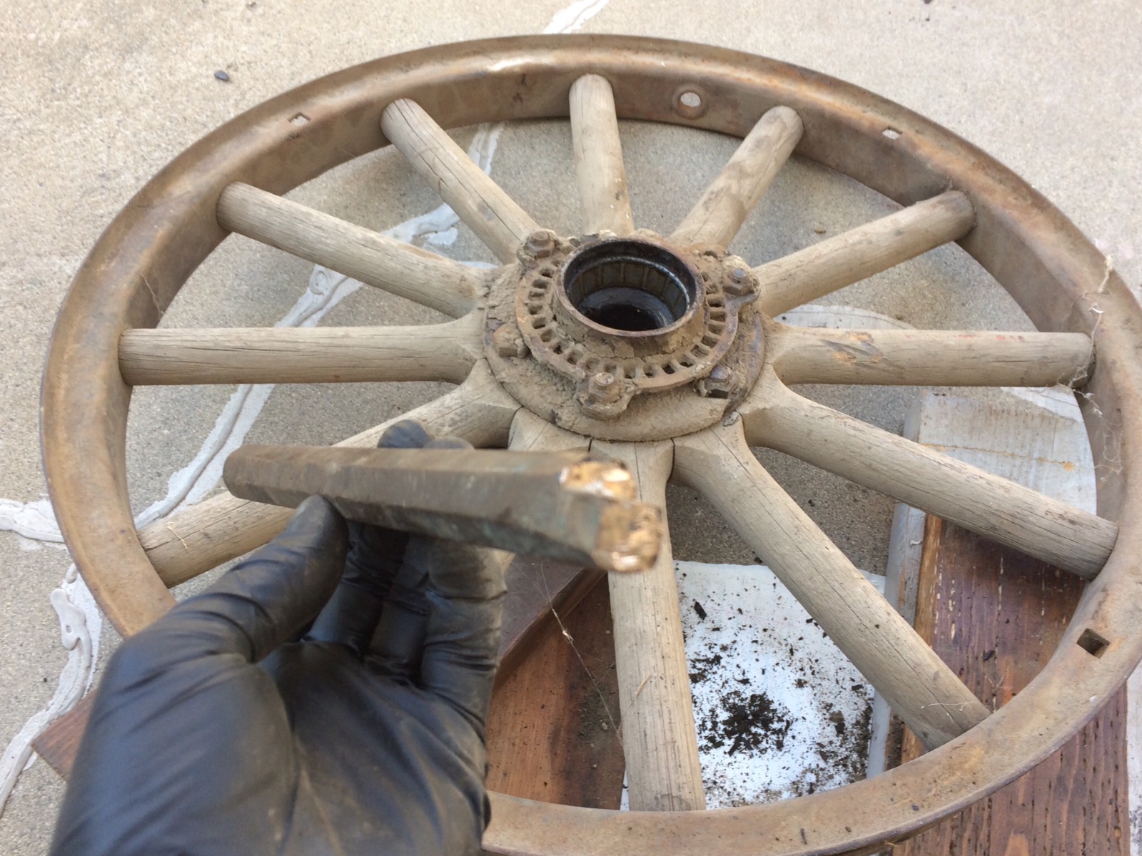

Remove hub cap and outer bearing. Lay your wheel on a couple of 2 x 4's. Take a brass punch, angle it to the side and punch out rear bearing and seal with a couple hammer hits. Now you will not have to buy a new seal. Rinse bearing in kerosene to clean out old grease. Dry. Check bearing and race to make sure they are still good. Now put a gob of grease in the palm of one hand and regrease the bearing. Put wheel back on 2/4's to protect and a piece of cardboard to protect outer hub. Drop bearing in place, cover with old or new seal and use 2x4 and hammer to set. 1 or 2 swings should do it. Now replace outer bearing. Done.

Apparently Chicago Rawhide is now SKF. This gives three seal numbers.

Wow! Thanks for all the help! I decided to start with a old wheel I had.
I used David’s advice. I believe at Bakersfield I picked up the tool in a box of stuff. It was easy as butter to get it out. But I can see it is not the best bearing! Good thing this wheel was not on my car! Thanks everybody! On my car I will use you advice on the seals

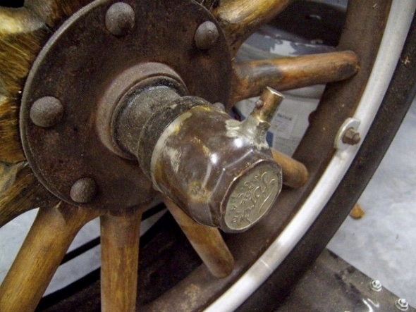

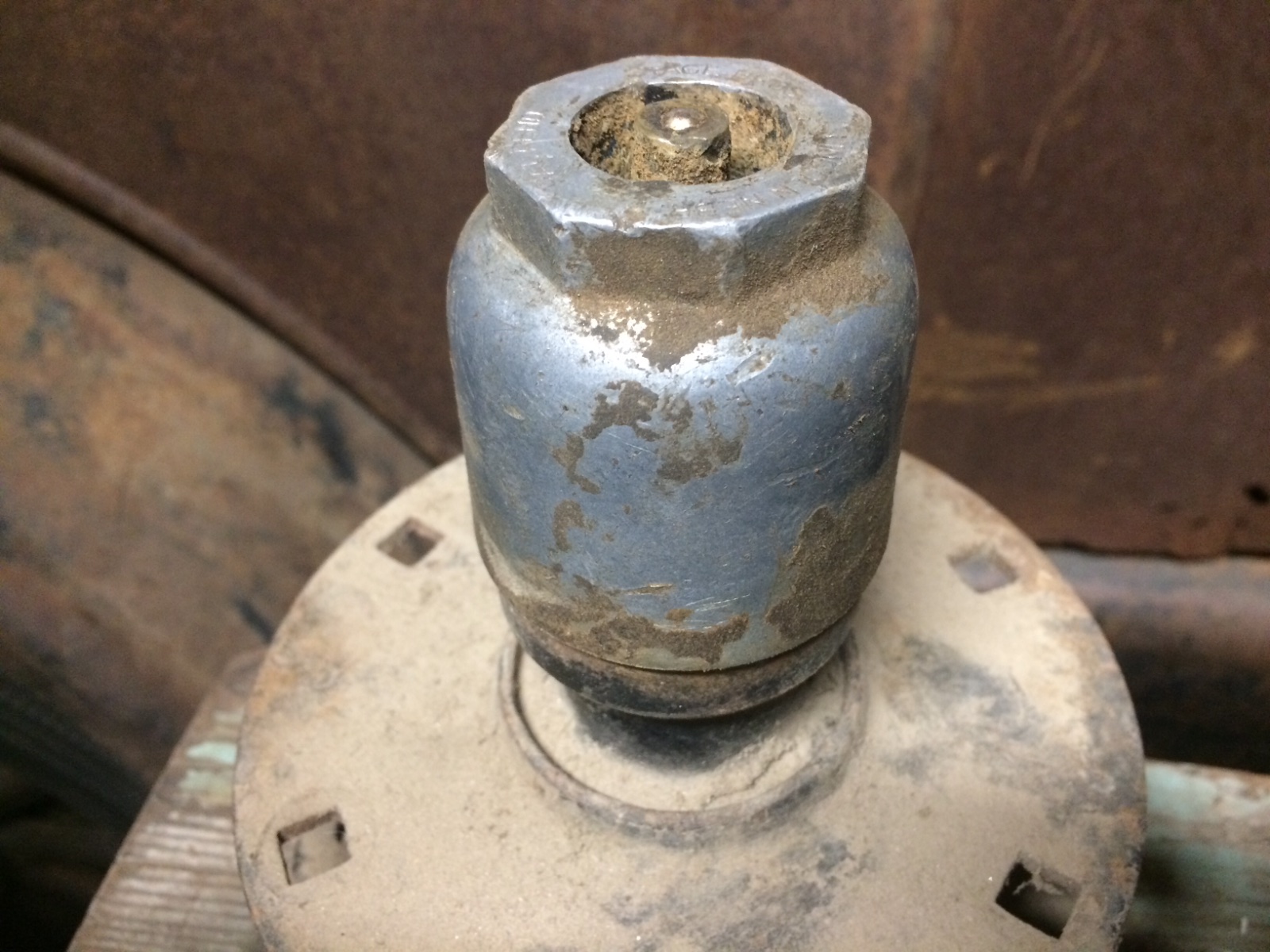

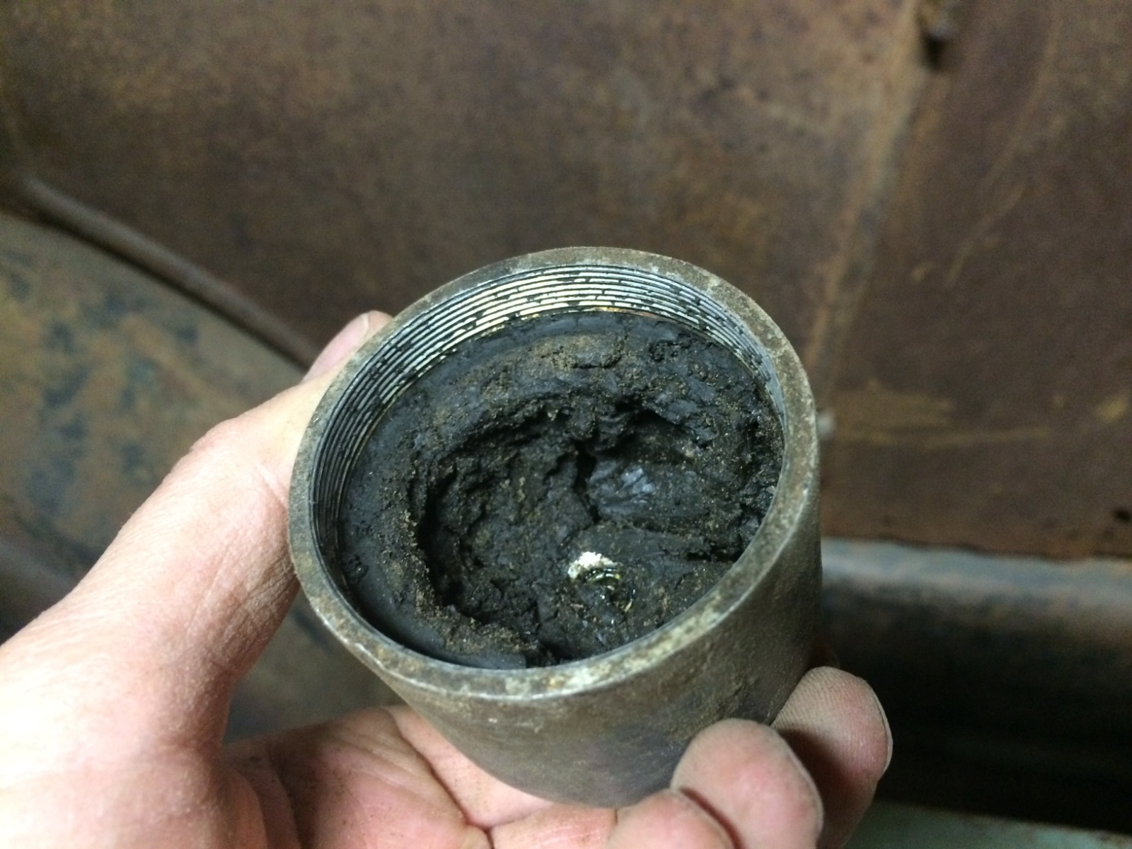

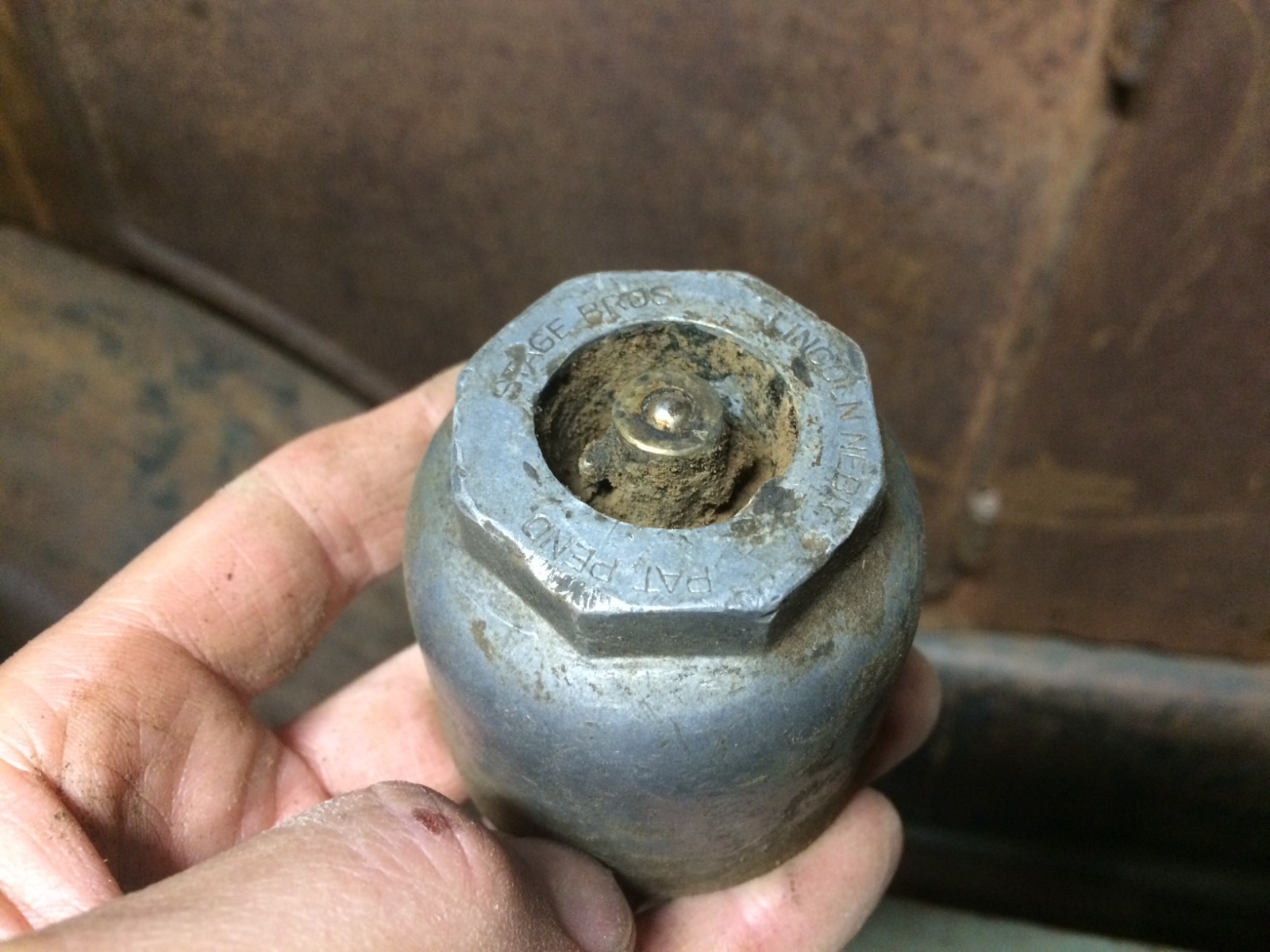

I was thinking about doing what Richard mentioned. Using a old grease cab and put in Zürich oil fitting in it. But I found this!
I need to clean out the old grease. Here it is mounted on a loose hub. Anyone ever see one of these?
Thanks!
Matt
Thanks!
Matt

I have several different type - there were a number of manufacturers who produced these.
- Posts: 6804
Re: Greasing inside wheel bearings?
I have that exact cap (only cleaner
Not rare, but not overly common, either.
- Posts: 4090
The old farmer owner of my cut-off pickup, didn't want to spend $, so just soldered on a pin-type Alemite grease fitting, to the hub cap....the easy way

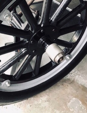

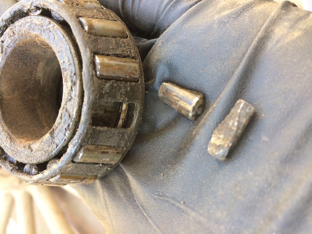

I must be really old school and left behind.🥴. When I put a wheel together, I drop a bearing in a baggy with some grease, and just squish it over and over and dump it out. Then when it’s in, I just fill up a hub cap and use it as a dope cup until I just see a hint of wet on the inside inner race.
As far as a zerk hub, one of mine has aftermarket zerk hubs, the Hack. Came to me that way with the old time push and rotate fitting. Someone on here was nice enough to sell me a non-functioning screw type grease gun intended for display that had the right fitting on the braided hose...yet after an hour in the oven at 225 wrapped in aluminum foil it worked smooth enough and loose enough to take it apart and soak it bare for rebuild!
