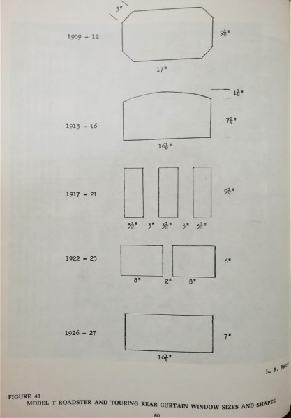

This is form Les Henry's book, Model T Ford Restoration Handbook.

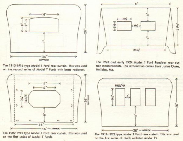

I'm not sure where this one is from...
Note there are some differences between the two, as I'm sure that there was differences in production as well depending upon supplier, especially in the early years.
Keith
Keith

The illustrations above are exactly why I posted this. There can't be two different sizes for the years posted, there can only be one! I'm working with Mike Francis on this, and we will eventually clear up all this misinformation.

Ford factory drawings at benson ford research center would answer that. There may very well be different dimensions for the same style windows. My experience with factory drawings is that there were many subtle changes for some parts even during a 12 month period, even for a short run style such as the 26-27 models. It may turn out that for some window styles there was a change every couple of months, so the quintessential, all or nothing, black or white, right or wrong, single configuration for show judging standards correct, does not exist. Who knows where Les Henry got his dimensions from as well as other pearls of wisdome for his book, but 40 years ago his book was THE source and that was what we looked at as the authority.
