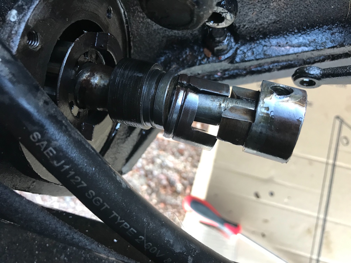

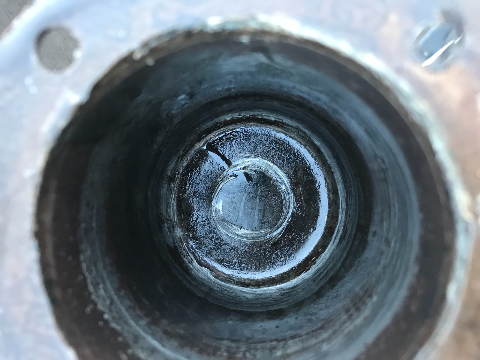

Post by John Warren » Mon Oct 21, 2019 8:09 pm
A couple of photos of findings. The bolts were were sorta still in place along with the spring. The cover was keeping it sorta together.

Post by Kenny Edmondson » Mon Oct 21, 2019 8:26 pm
Pull the starter and rotate the flywheel to see what kind of parts are stuck to the magnets.
