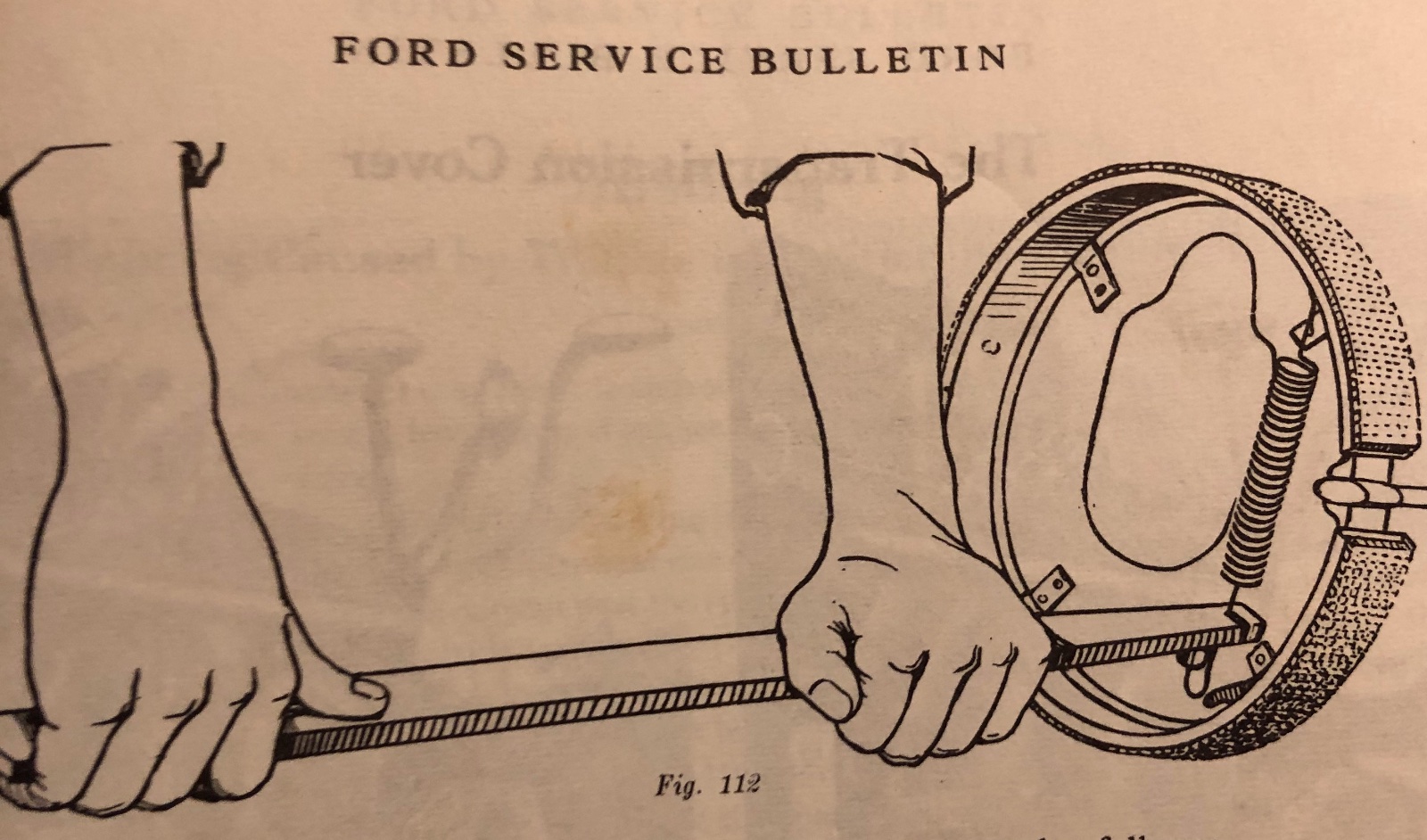

Ford shows using a bar like tool, so both hands for the work.
But just did that this last week, my trick is a handy pair of good Vise Grips, snapped around the lower spring shank, and then placing a bar on top of the widest part of the horizontal locked pliers handles, used a socket extension bar, 8".
That gave grip with both hands to push down hard and stretch the spring so the hook fitted into the band lug. Keep face out the the way when looking to hook that spring in case something flies apart!

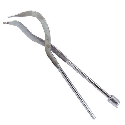

Wouldn’t modern brake spring pliers work ?
Available at most any parts store.
Some do, some don't. It depends how they are shaped. I find Vise Grips the easiest.

I would avoid anything like pliers that could nick the spring wire were the jaws grab it. Under tension that nick could lead to a break. I used the tool suggested above or a screw driver to pry it on.
