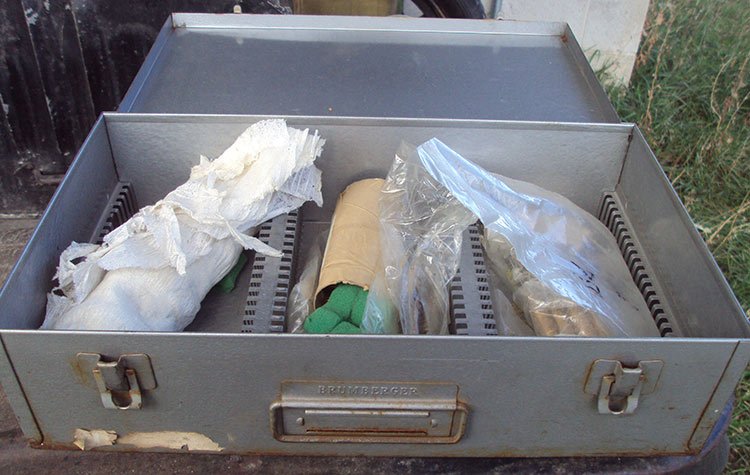

Back in the 70s our local A&T dealer found this at a swap meet. I wish I knew where they came from or how to install them. At least they were available at some point in time.
FWIW
FWIW

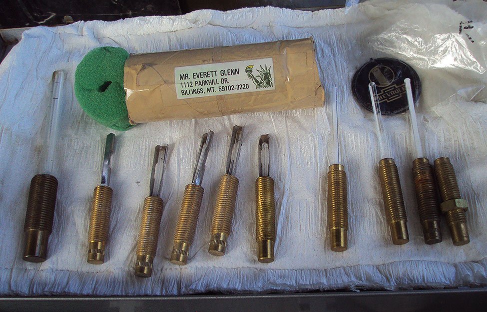

I don't know about now. But Restoration Supply outside San Diego Califunny used to carry the repro meters, and depending upon availability, repair thermometers. Been several years, but I did restore a few broken originals. Again, I don't know how much may have changed the past ten years, but it used to be that a repro model A accessory quail was prone to breaking the thermometer. While the large meter standard Boyce replacement thermometer was not available at that particular time, the large quail replacement was. The quail replacement comes mounted in a brass sub-base, and used the same thermometer otherwise. So I bought one of those. Being VERY careful, using a dremel tool cutoff disc (or about four or five of them!), I cut the brass base lengthwise in three places. Carefully peeled the glue off the thermometer, and carefully installed the thermometer into my broken original Boyce.
It was a bit of a bother, but worked quite well.

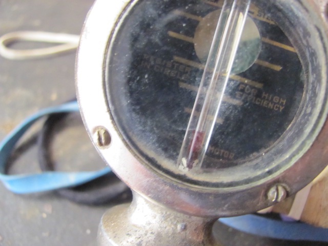

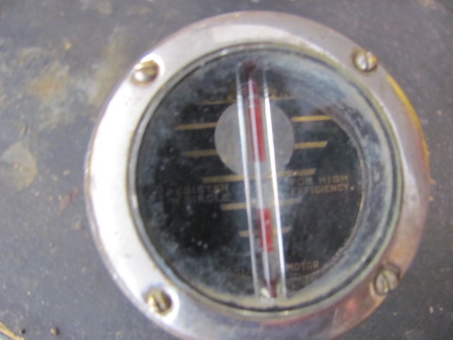

My large motometer thermo tube is broken. the red (mercury?) fluid is, and has been since I bought it years ago, at the top of the tube. Now that I have the engine built and running, I'd like to have a working meter.

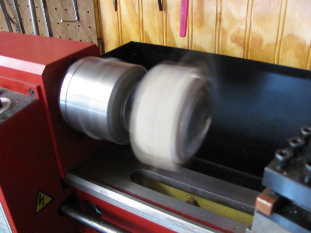

Is the thermometer physically broken? Usually, you can tell by looking at it. And usually, if it is broken, you will not see much red in the top half of the thermometer.
Often, over the so many years these things sat around, and laying flat? The colored mercury (or other colored fluid?) would slowly flow to the top of the thermometer glass. Motometers should always be stored upright. This issue seems to be getting worse as the years roll along. But it used to be that most Motometers could be fixed by any of several methods. One of the favored (and original recommendation by Boyce) was to beat the mercury back down on a spare (or other available) inflated tire. This method does pose a risk of breaking a good Motometer if proper care is not taken. The risk of breakage seems to be getting greater as they approach a hundred years of age. The "pot metal" Boyce used was generally a much higher grade than so many automobile parts used. So they usually look pretty good still. Yet they have degraded somewhat and become a bit more brittle.
Some people prefer to spin them on a bicycle wheel or machine lathe and have the centrifugal force work the mercury back down. Be VERY careful tying it onto whatever you plan to spin it on. If the Motometer comes loose, it can really fly far breaking itself and who knows what else gets in the way (like your face?). Others have held the meter in boiling water on the kitchen stove with good success. I personally have tried that a couple times, but it never worked for me. Back to the spare tire.

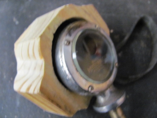

Dan, would zip tying my Peerless to the T hub accomplish that of a lathe? Clearly a lot slower rotation which may be the required case.

I have one which got hot and the red stuff went all the way to the top. I tried putting in the freezer, I tried boiling it, I even tied it to my spoke wheel, jacked up the wheel and ran the car, which threw the motometer across the garage, but it is still up! Got a replacement from Langs.
