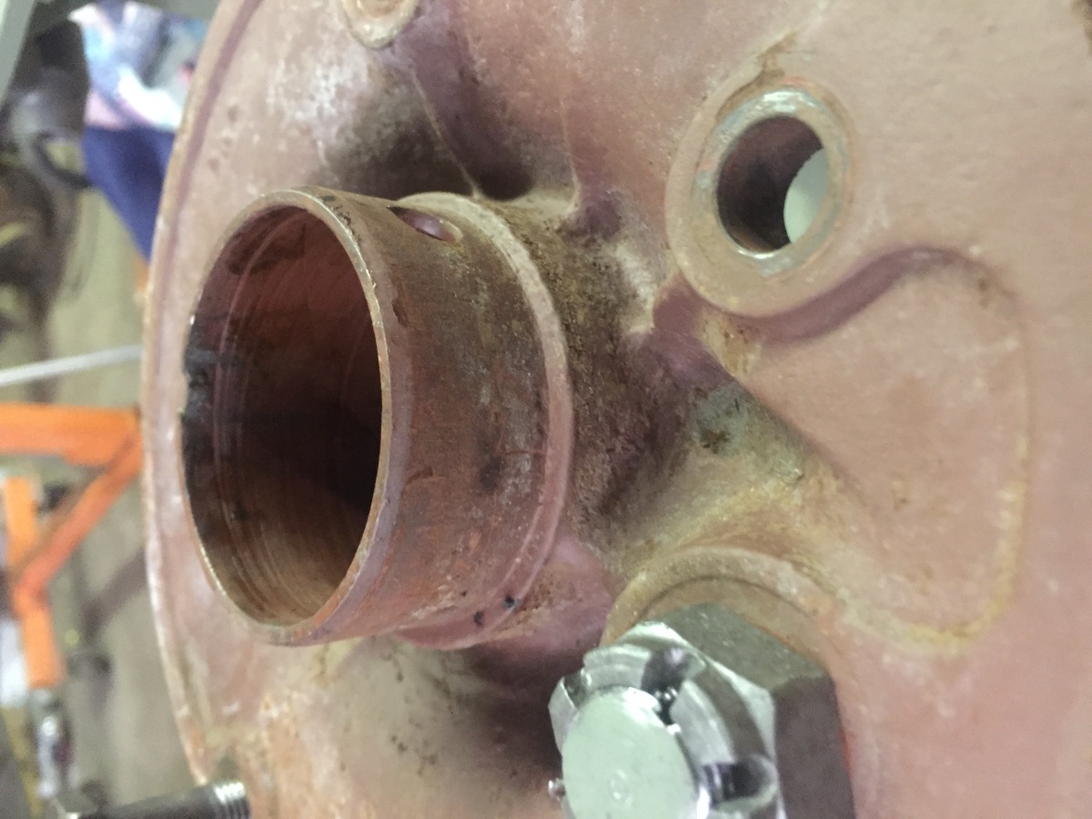

So one inch is basically to the shoulder? Is that right? Yes I’m a little nervous.

I used an angle grinder 4.5 cutting disk and then smoothed up with grinding disc.
I marked a line around just inboard of the lock hole foe the sleeve
Lastly took my dremel with a sanding disc smooth the edge so i didnt cut a seal witch was an O ring
Depends i think what safety hub you buy there
Email me i send pics or help more
I was nervouse my 1st set but did my second set like nothing

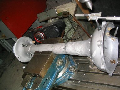

I use a cutoff wheel. On an assembled axle, I slide a piece of tubing over the axle to avoid nicking the axle.
Andy
Andy

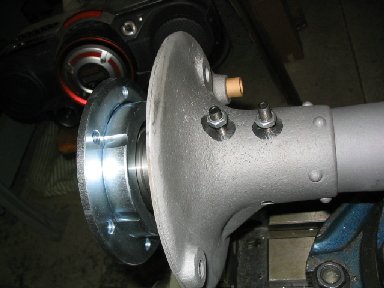

I have always used Dans Hubs, they are made right.
I use two set screws to keep the hub straight with the axle, and I tighten them, and use a lock nut. You do not want the hubs sliding, in, and out, as cornering, and ruts will do.
All that I have put in, no problems.
Herm.
Herm.

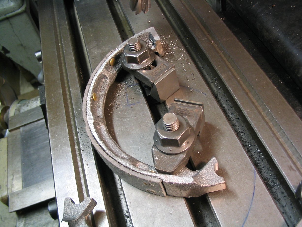

Those two piece brake shoes, to keep them working straight, and not coming off, i put put washers on the out side of the New Old Stock Brake Cams.
I also used NOS Hubs, in the New wheels.
Thanks,
Herm

When cutting the tub off straight, I have always used a hack saw.
Scribe your cutting line clear around the tube. Now, take the hack saw, and cut on your line, until the saw teeth just drop through to the inside of the inner, tube. Then move your saw forward, and do it again. You are only cutting about a inch, or less at a time.
When done with sawing, it should be straight, and a clean cut. Just a little file on any sharp edges.
Do NOT just cut the pipe off at the inner larger diameter. It has to brace, itself against what is the right a mount left, so all the pressure is not against the set bolts, when the force is inward, on the axles.

Some good ideas there Herm, what are you using for a plug in the drain? And are you taking width off the shoe?

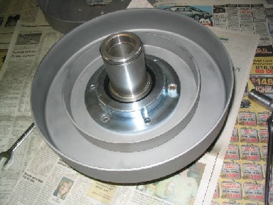

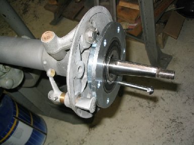

Herm’s approach is good and resembles the era design which I started using 40 years ago.
I have now reduced the ball bearing size a bit to make it easier to fit into the small drum brake. I hold it onto the inside adapter with a snap ring. Still LOTS of load capacity!!
I have a couple of other “deviations” but I’m not looking for a fight so I will not share them

Re: Cutting axle tubes for floating hubs
I milled of the cast iron, only, off both sides of the shoe, up to the lining. These shoes are crude, I won't be using them again.
The drain plug is large zerk size. The plug was a Allen wrench, flat plug.
Herm.
