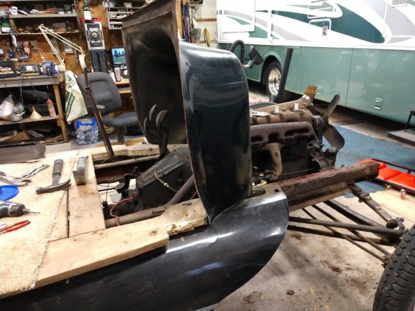

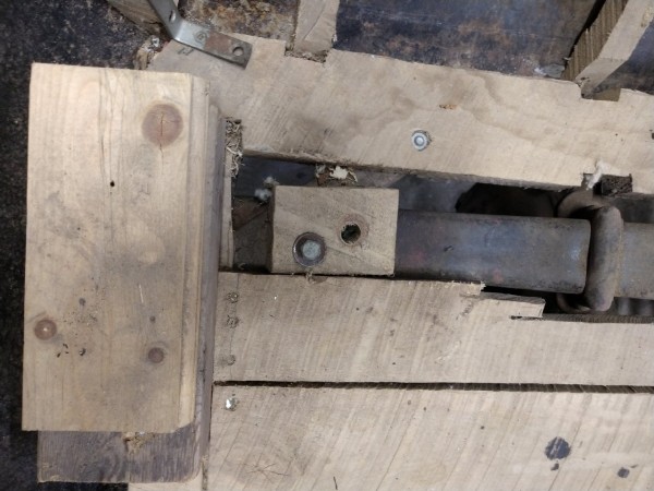

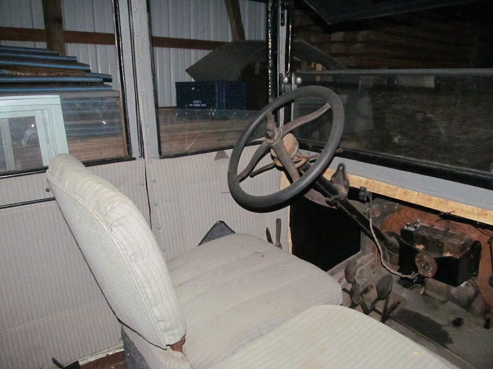

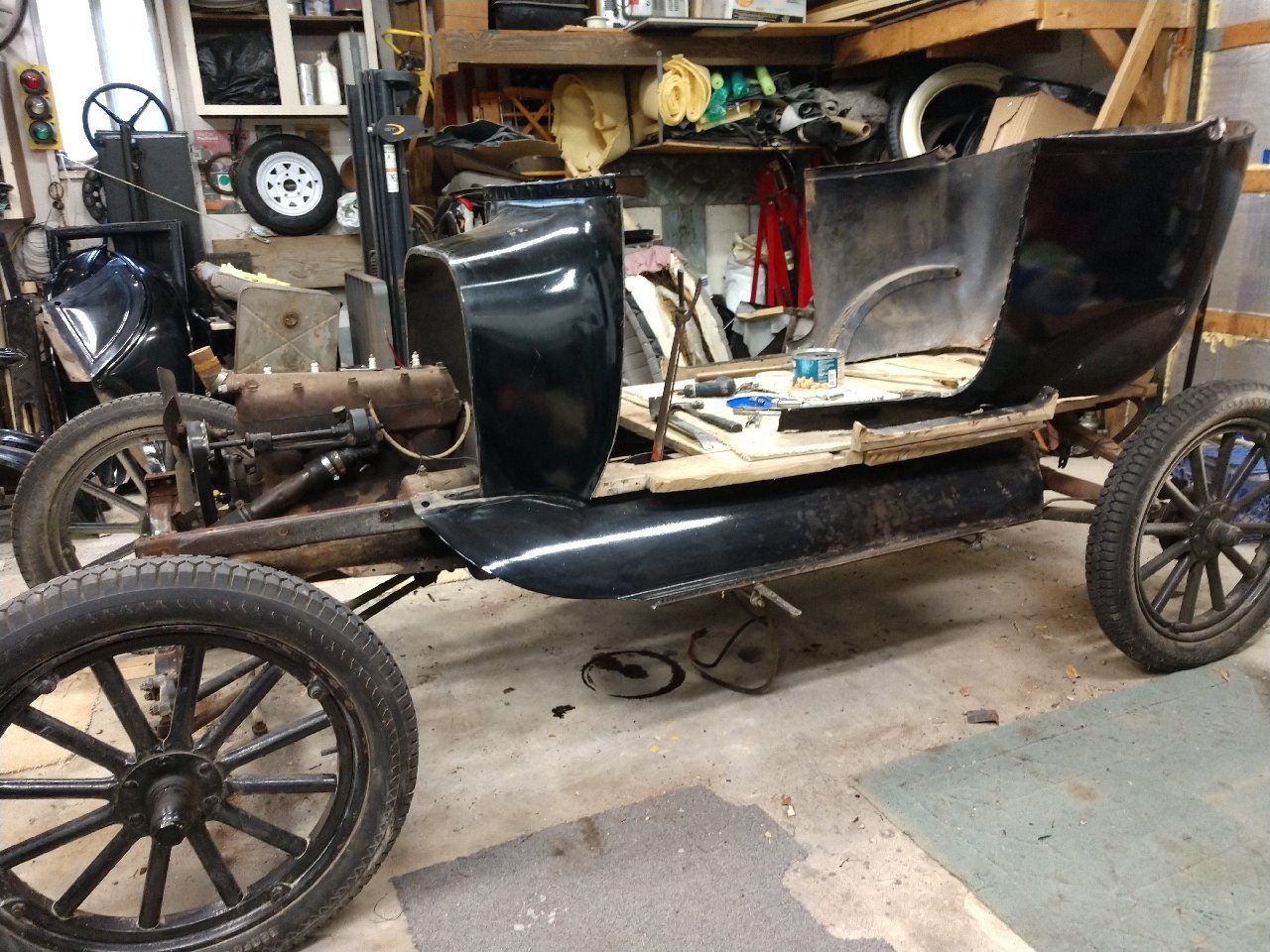

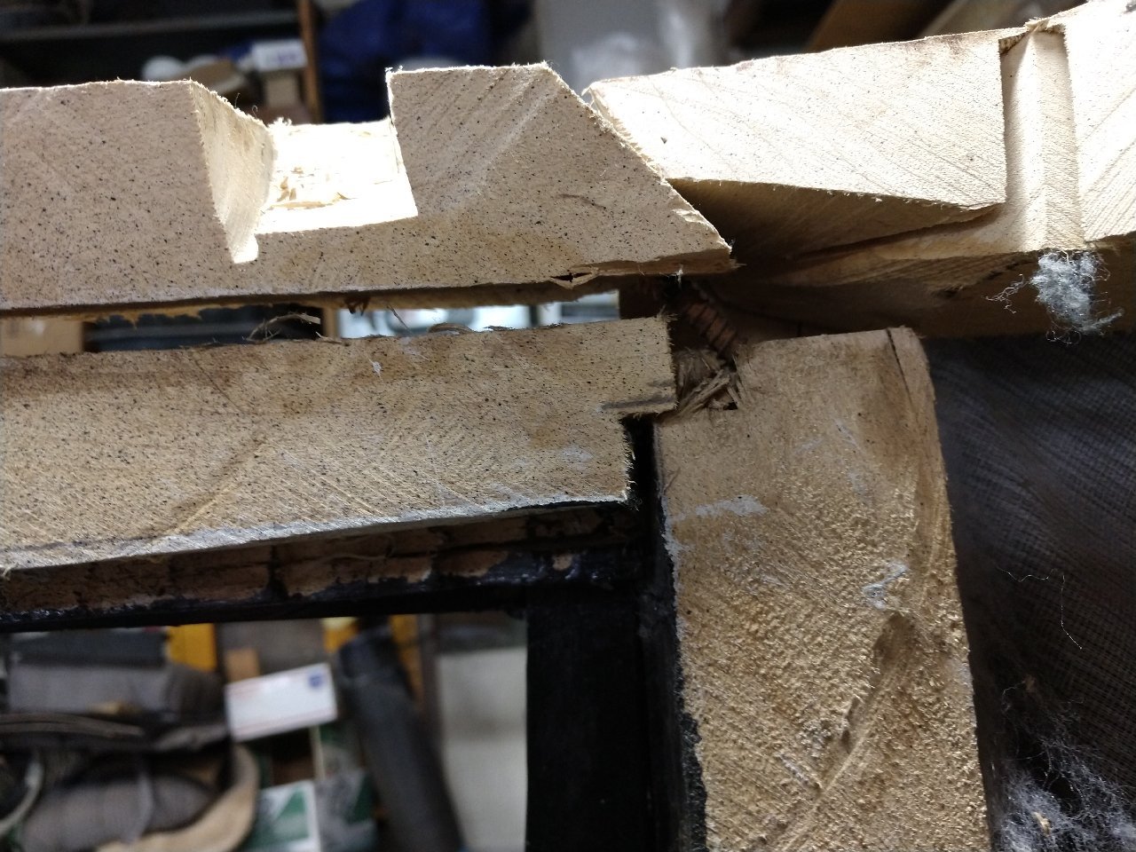

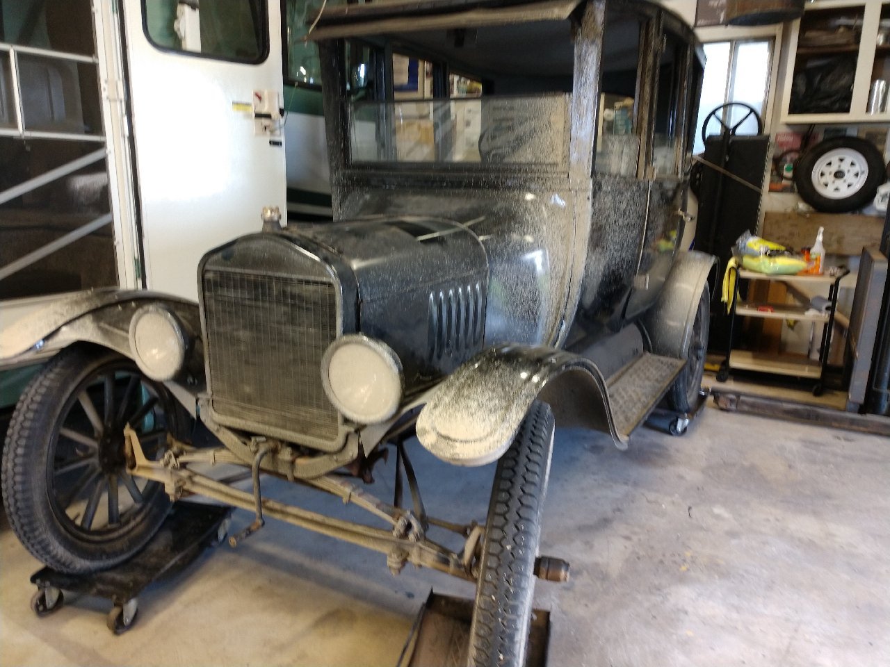

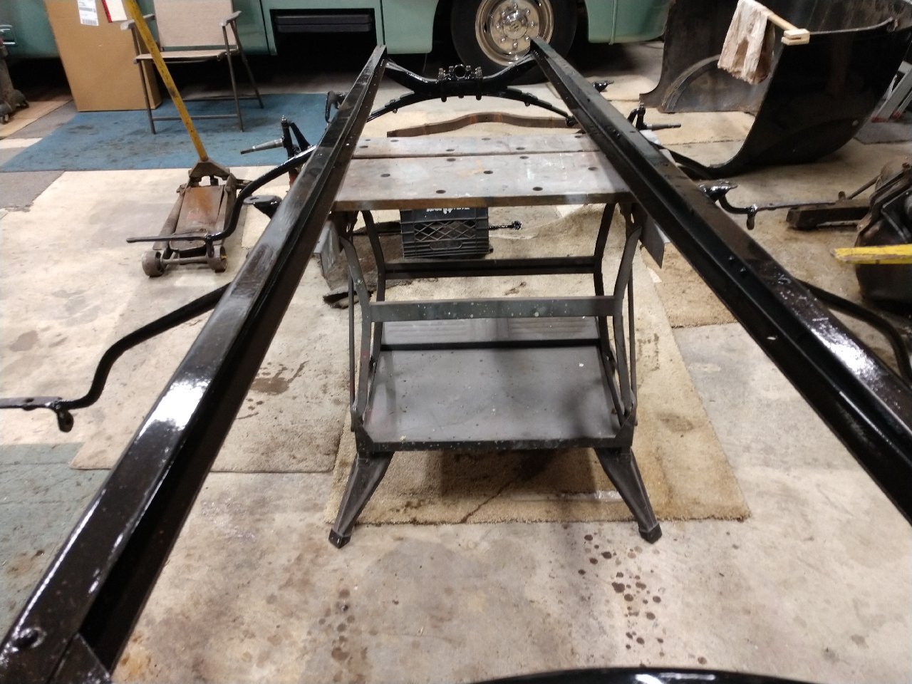

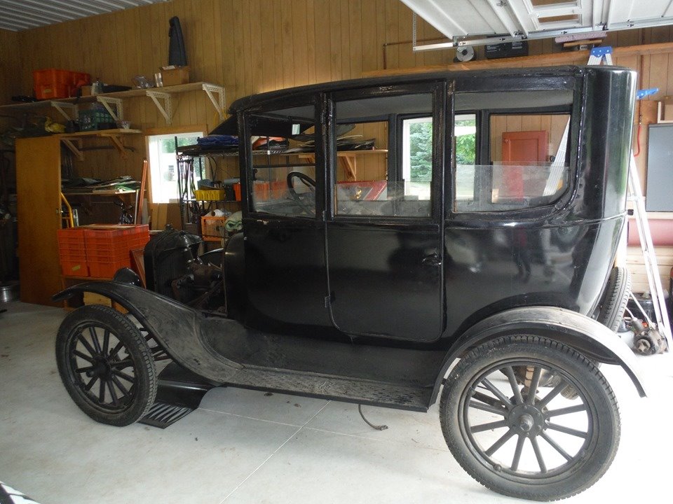

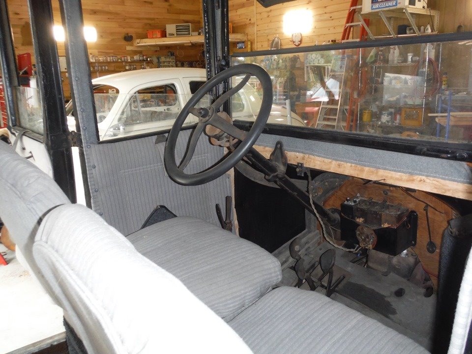

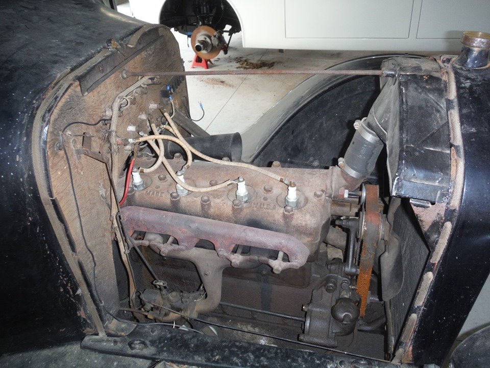

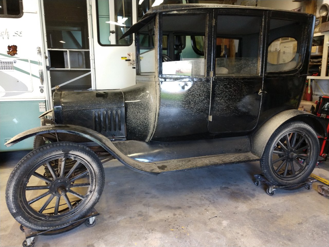

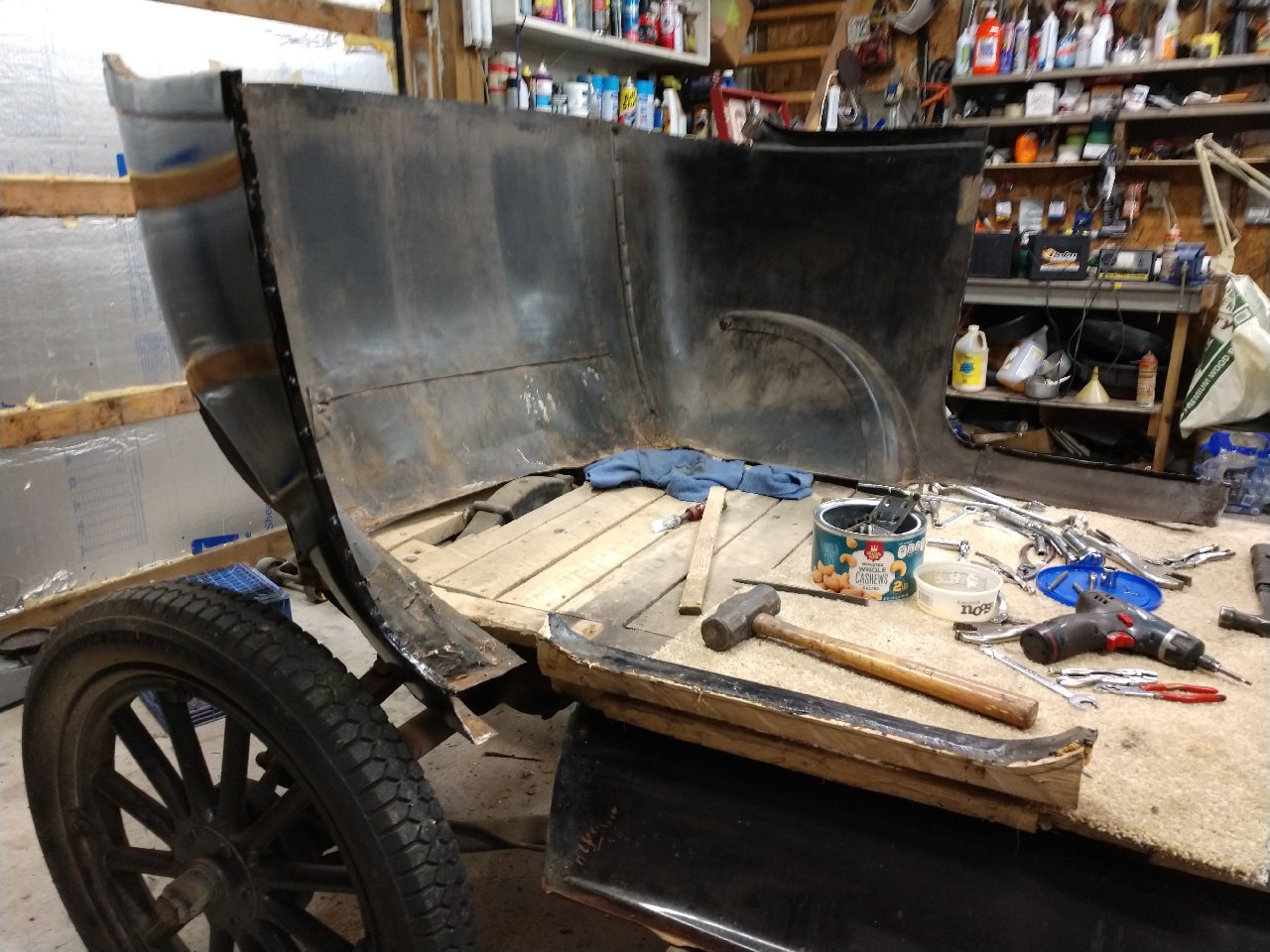

Just picked this up yesterday. It appears to be a mutt and also appears to be re-wooded. Who did this wood, I have no clue. Not much correct about it and it will have to be replaced. Should be a fun winter project.

Hmmmm... Once again - very interesting. I also have a ‘19 centerdoor. Original wood in excellent condition. Your bracketry: very interesting upper steering column stabilization bracket. I don’t have this. And the “dish towel rails” on both doors. I have them too. Are they meant to grab and close the door with?

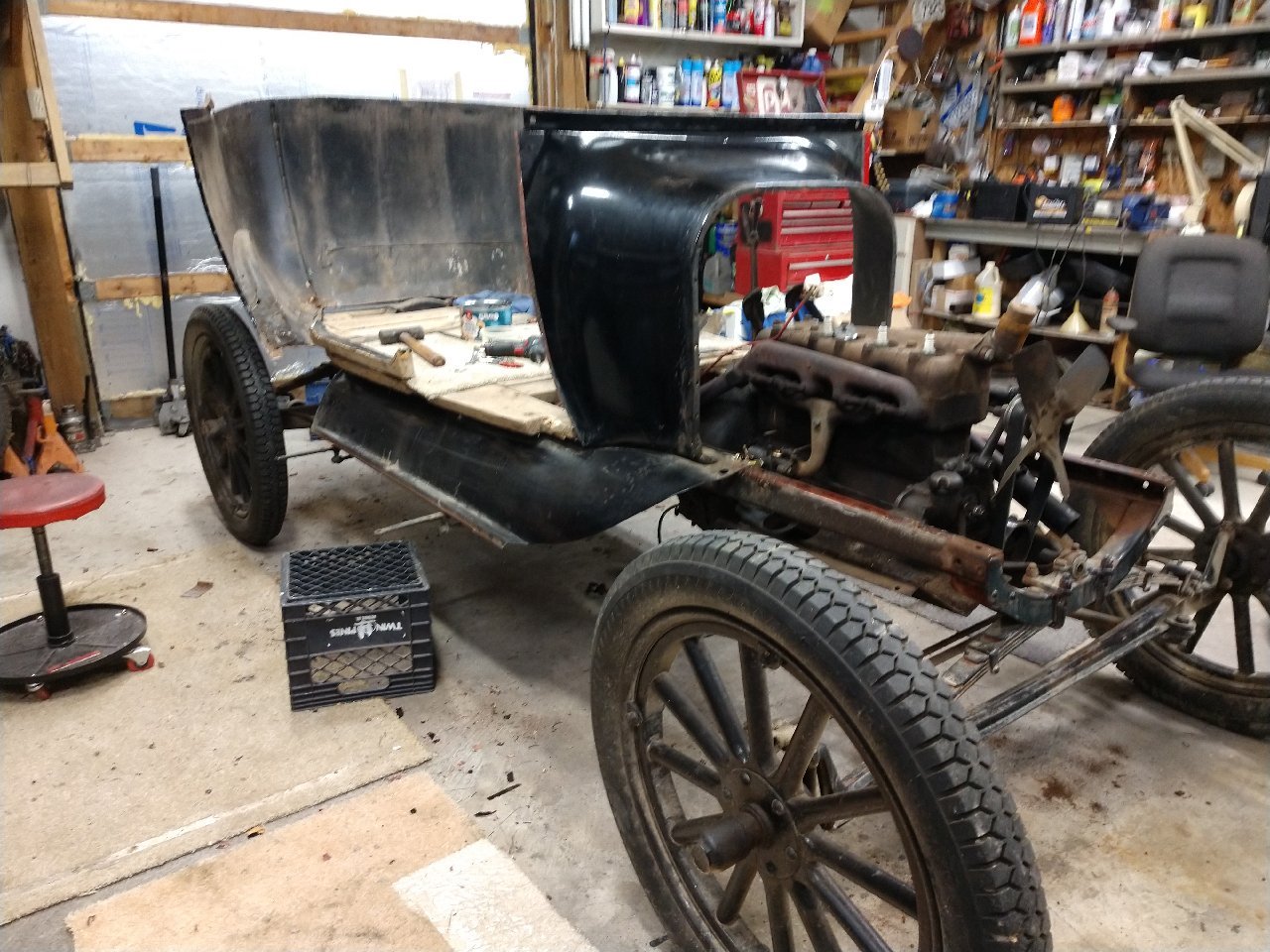

Thanks George, yes I'm pretty sure I will end up doing a frame up carving on it. It was redone but no accuracy to any of it. And I knew that before I handed the cash over. This also appears to be a mutt. Seems to be a mix of close but no cigar parts. It should keep me busy this winter and that's really what I want and need.

Dallas, heck no!! I've gone on a diet and cut the calories in half with this one.

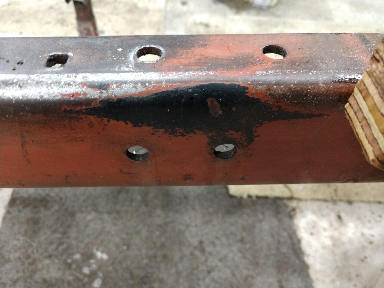

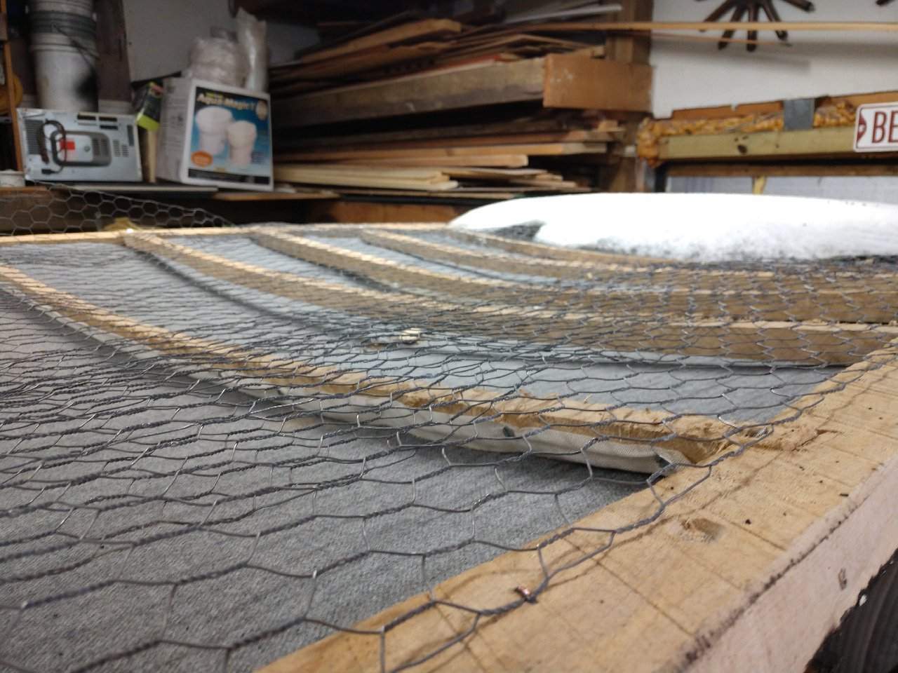

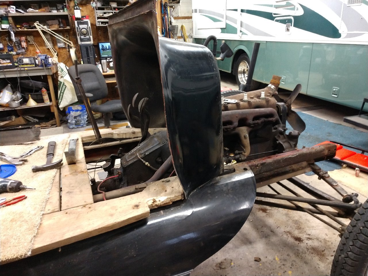

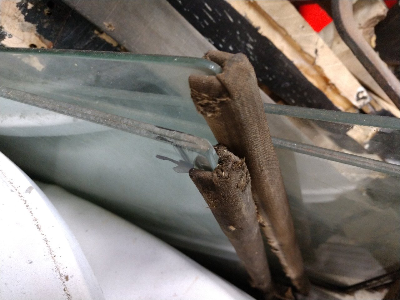

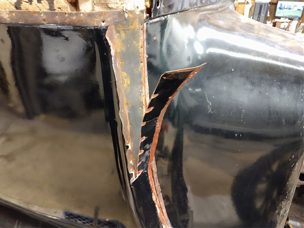

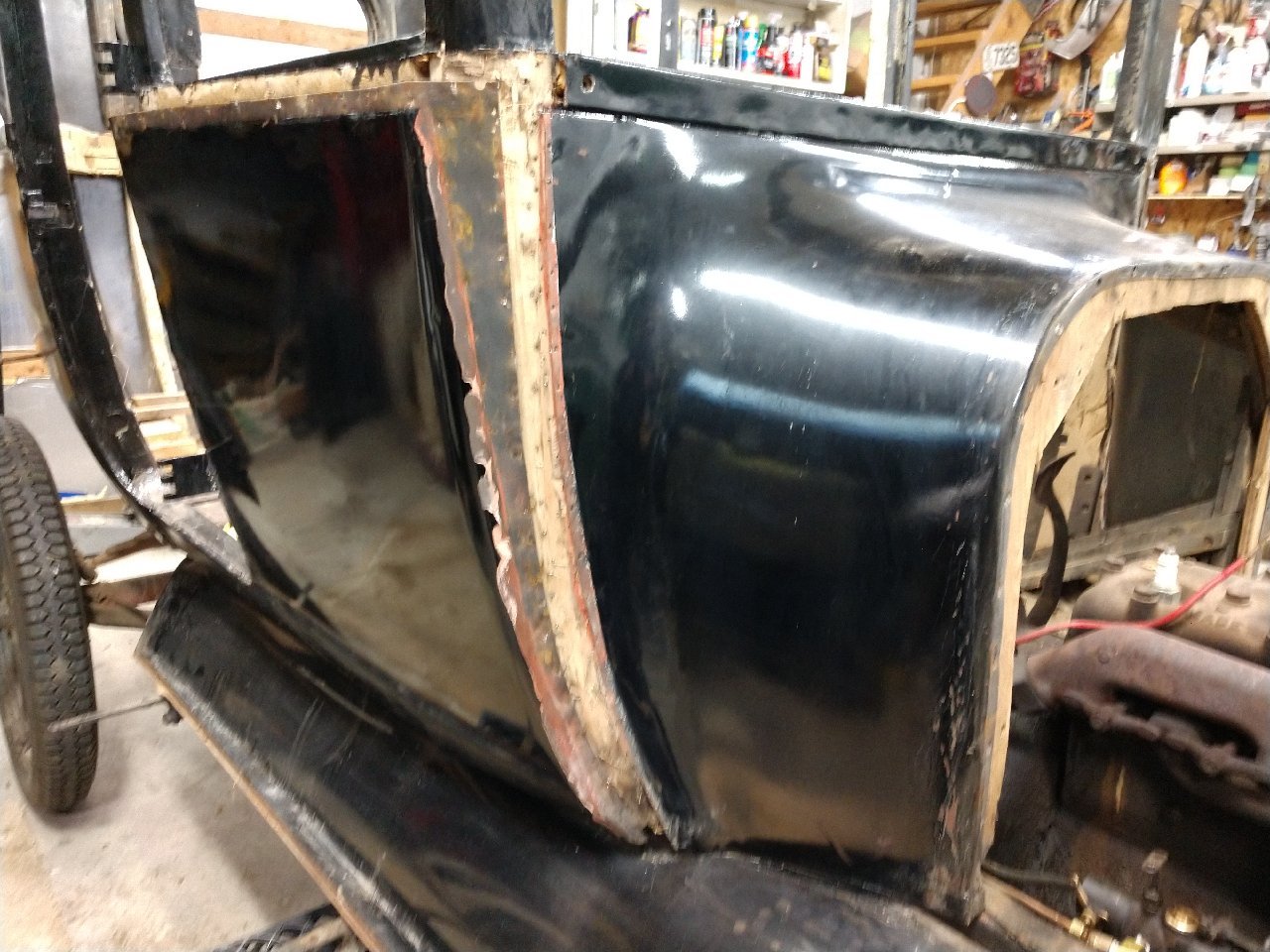

Rich, I tried to add some pictures this afternoon. NOPE once again this forum has a problem with my pics...frustrating. I even tried the same pictures I posted and no cigar. So when this fancy dan forum has a mood swing I will post again. Errrr !!

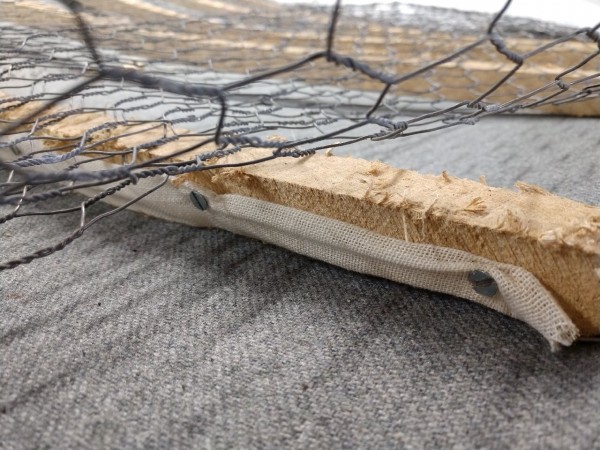

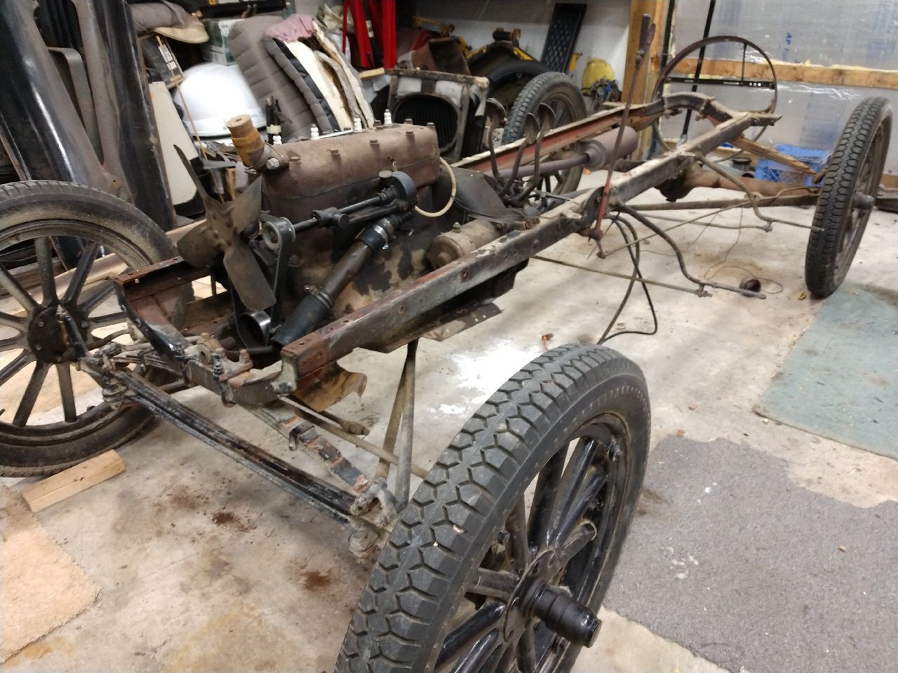

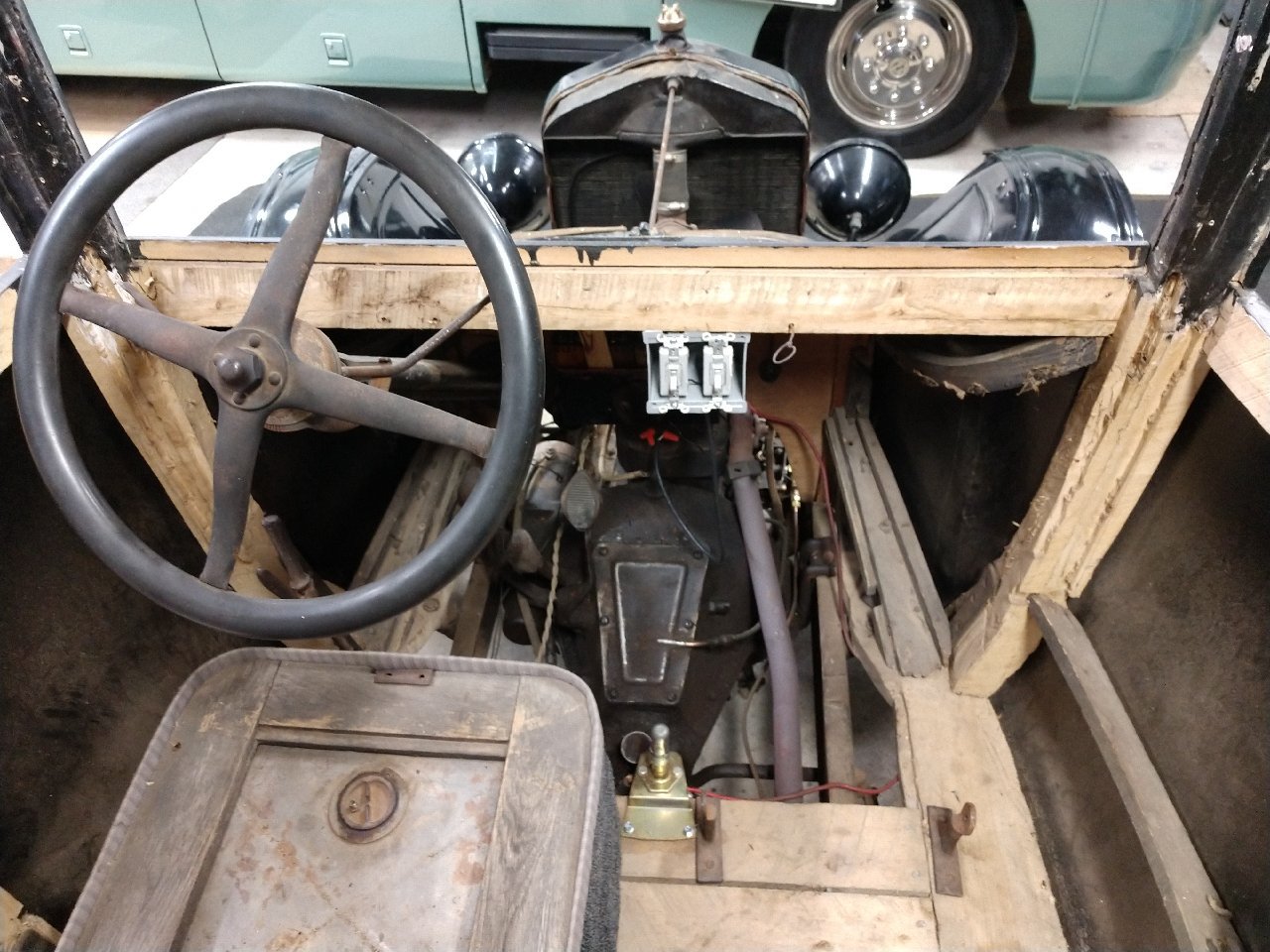

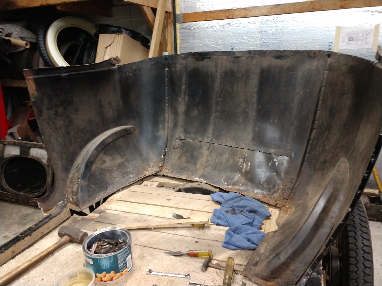

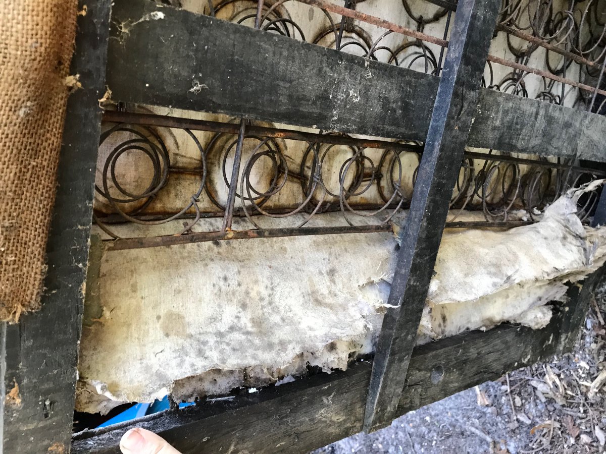

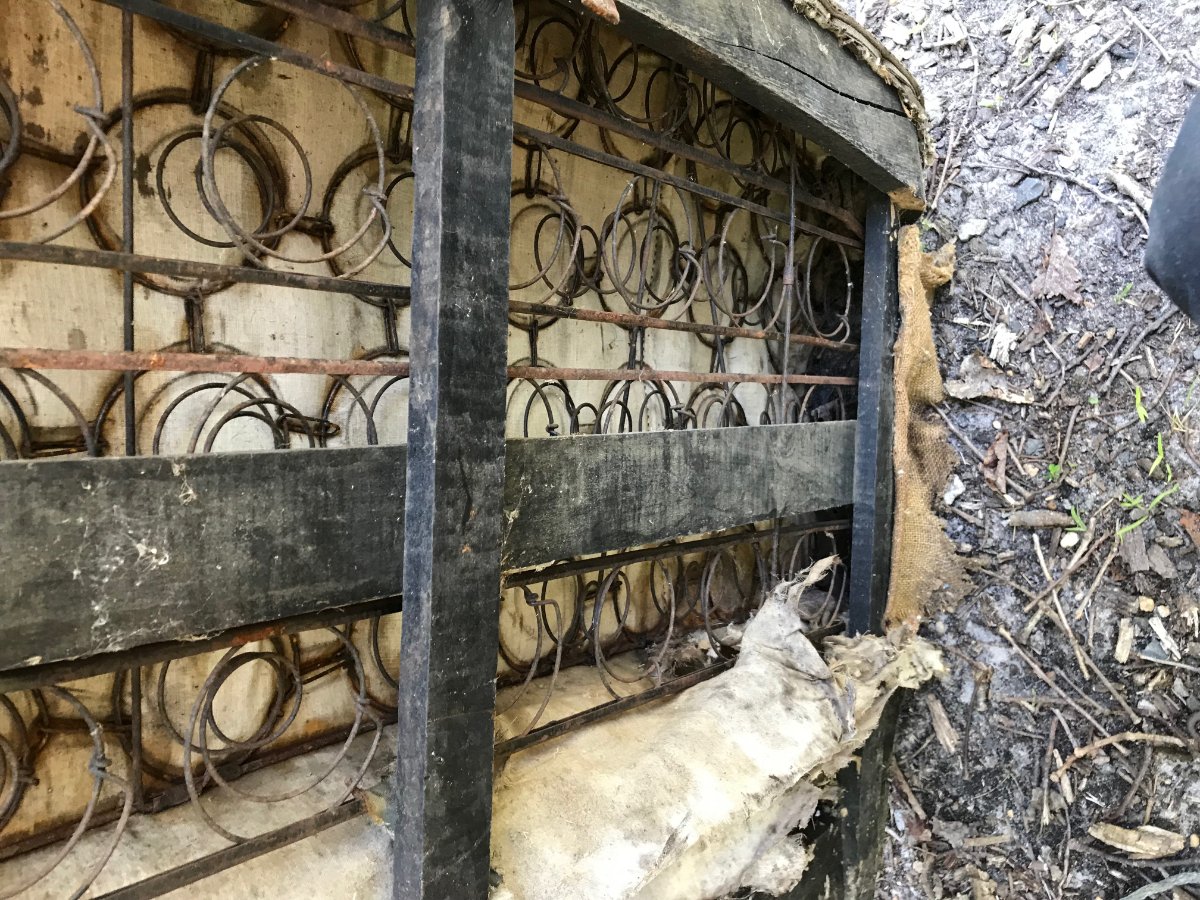

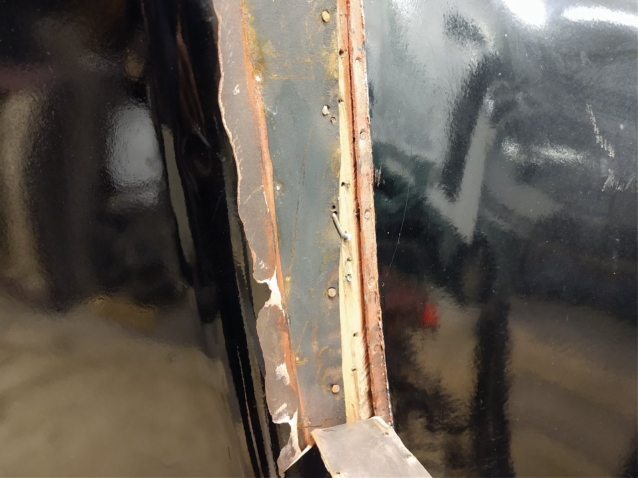

More pic's... This car was originally from the Upper Peninsula where you look up to see how deep the snow is. I was a bit surprised to find rolled roofing under the top pad. The weight of the roofing material took a toll on the top bows. Just part of the fun … Notice the prior stapled the chicken wire and screwed the headliner hangers. yeeee ok~
Once again this forum accepted these pictures and that was that. I will try to post more pictures as its mood allows....

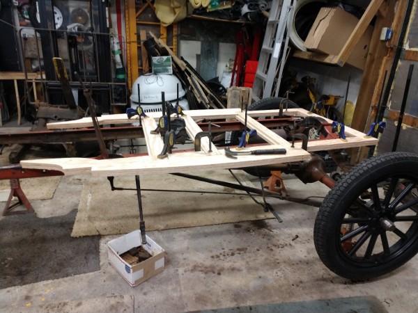

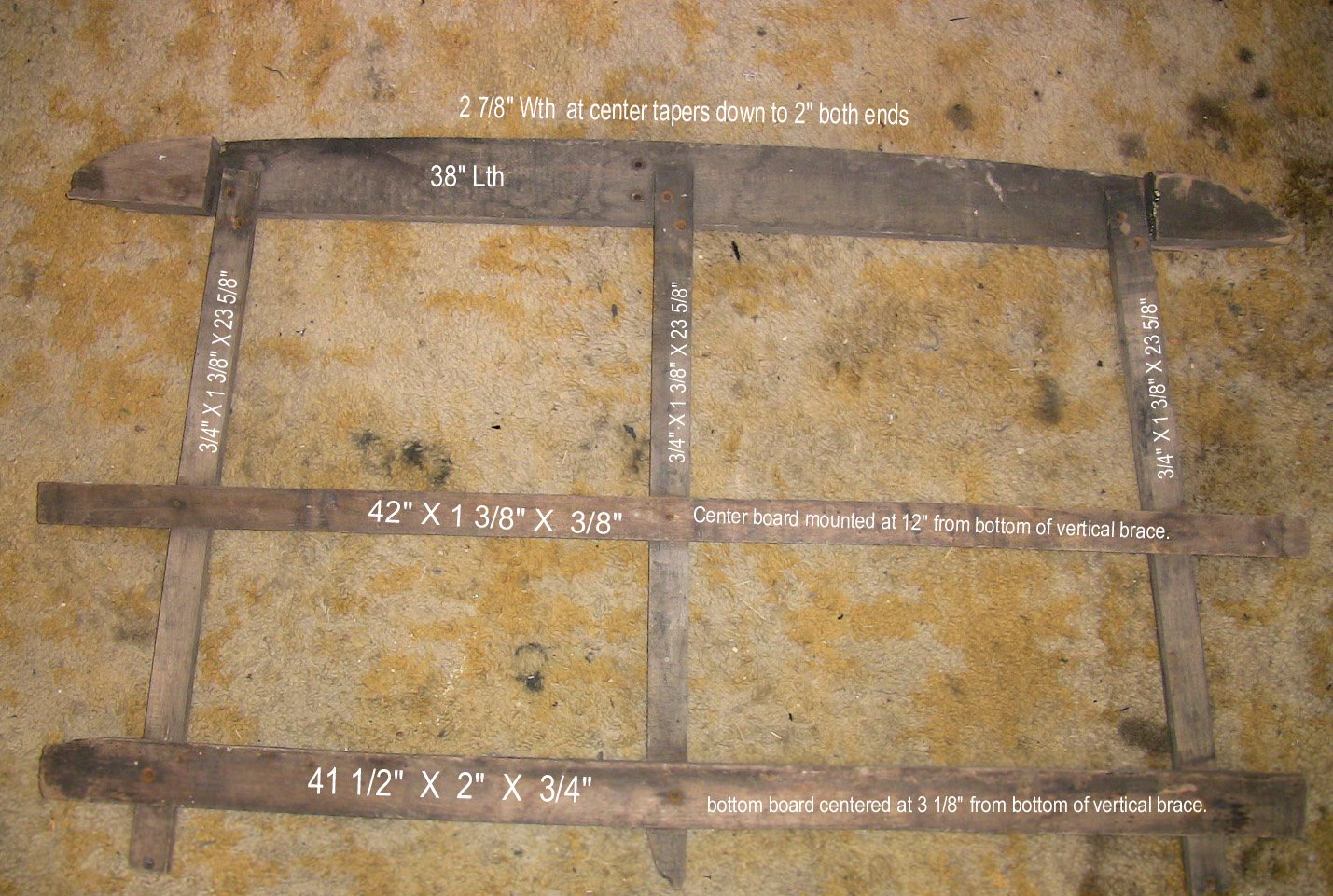

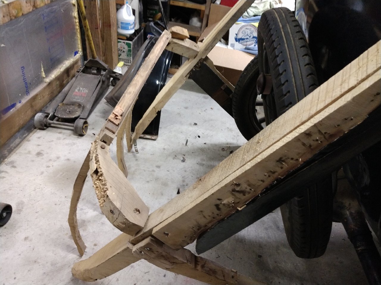

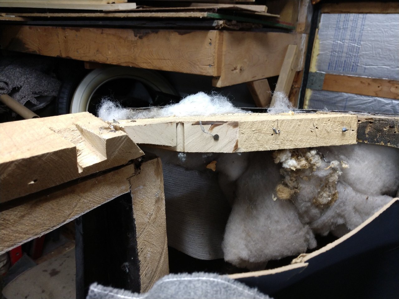

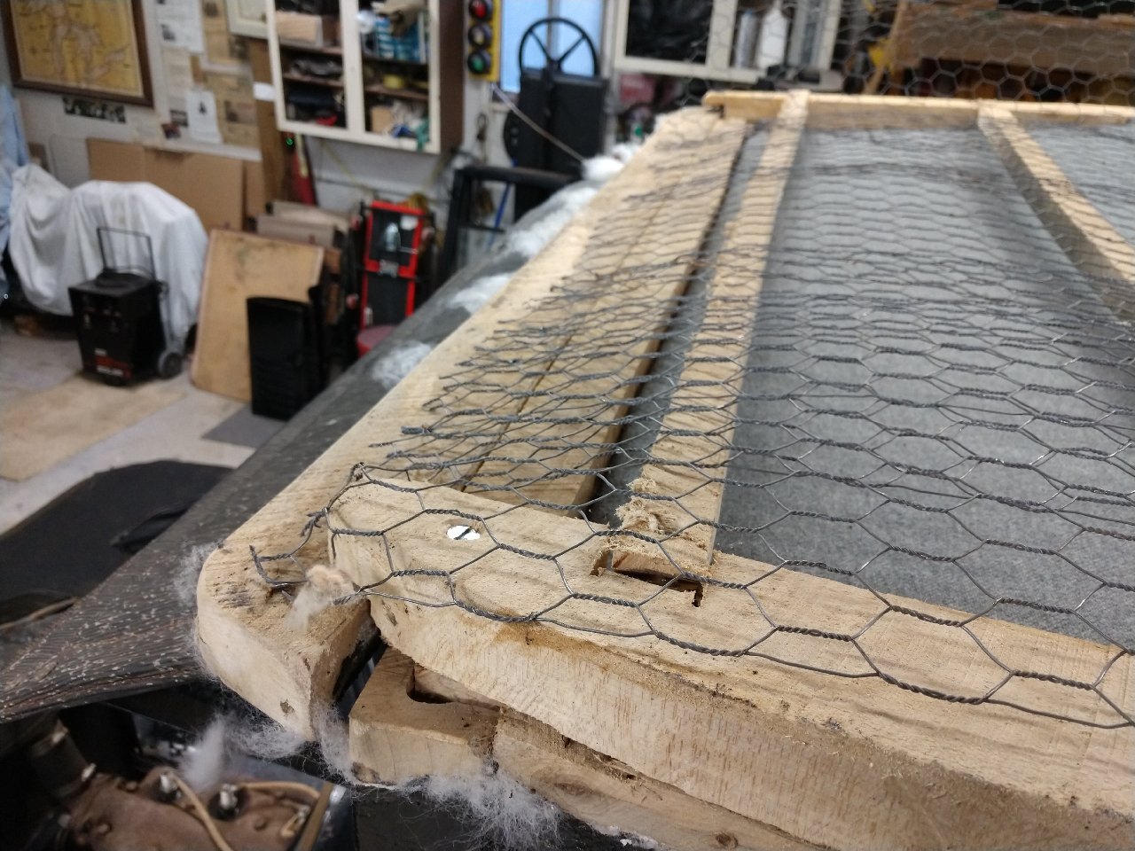

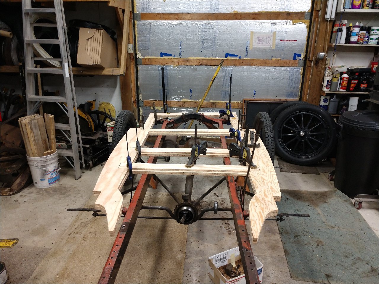

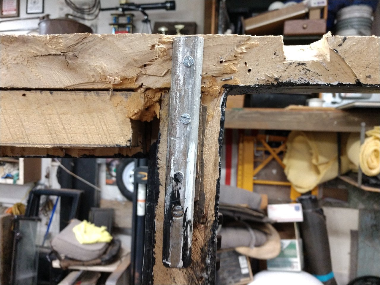

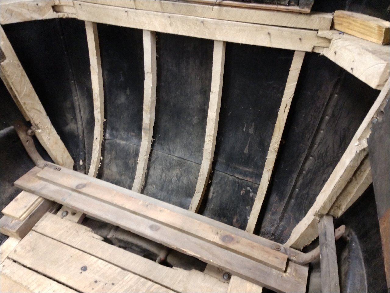

Yikes...hard to find anything for a pattern. Oh well, it will be a fun challenge.
John Codman
- Posts: 1532
- Last Name: Codman
- Location: Naples, FL 34120
Re: '19 Centerdoor restore... :)
I definitely see why you are replacing the wood!

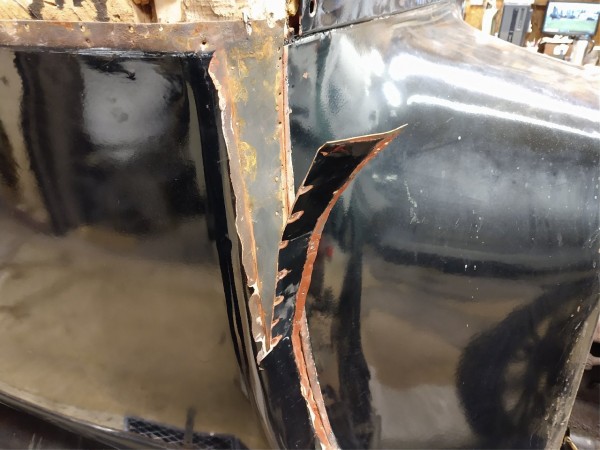

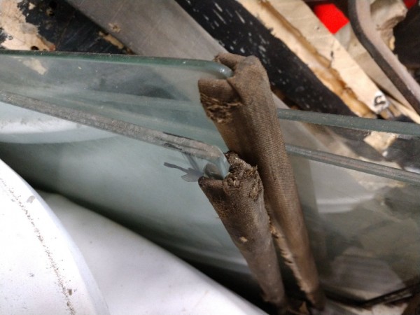

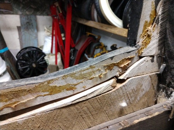

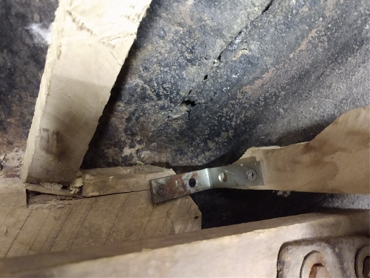

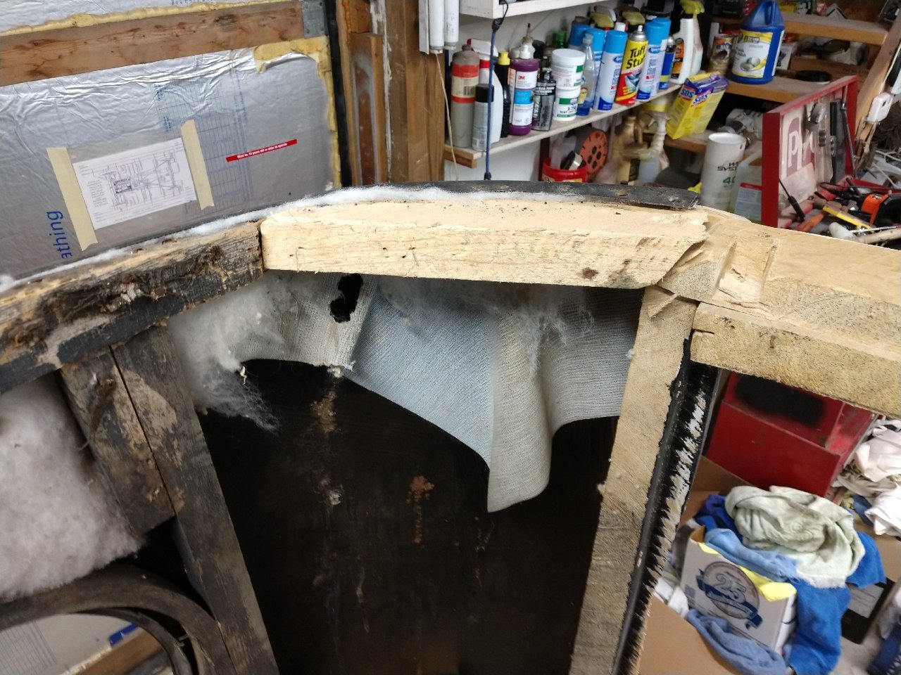

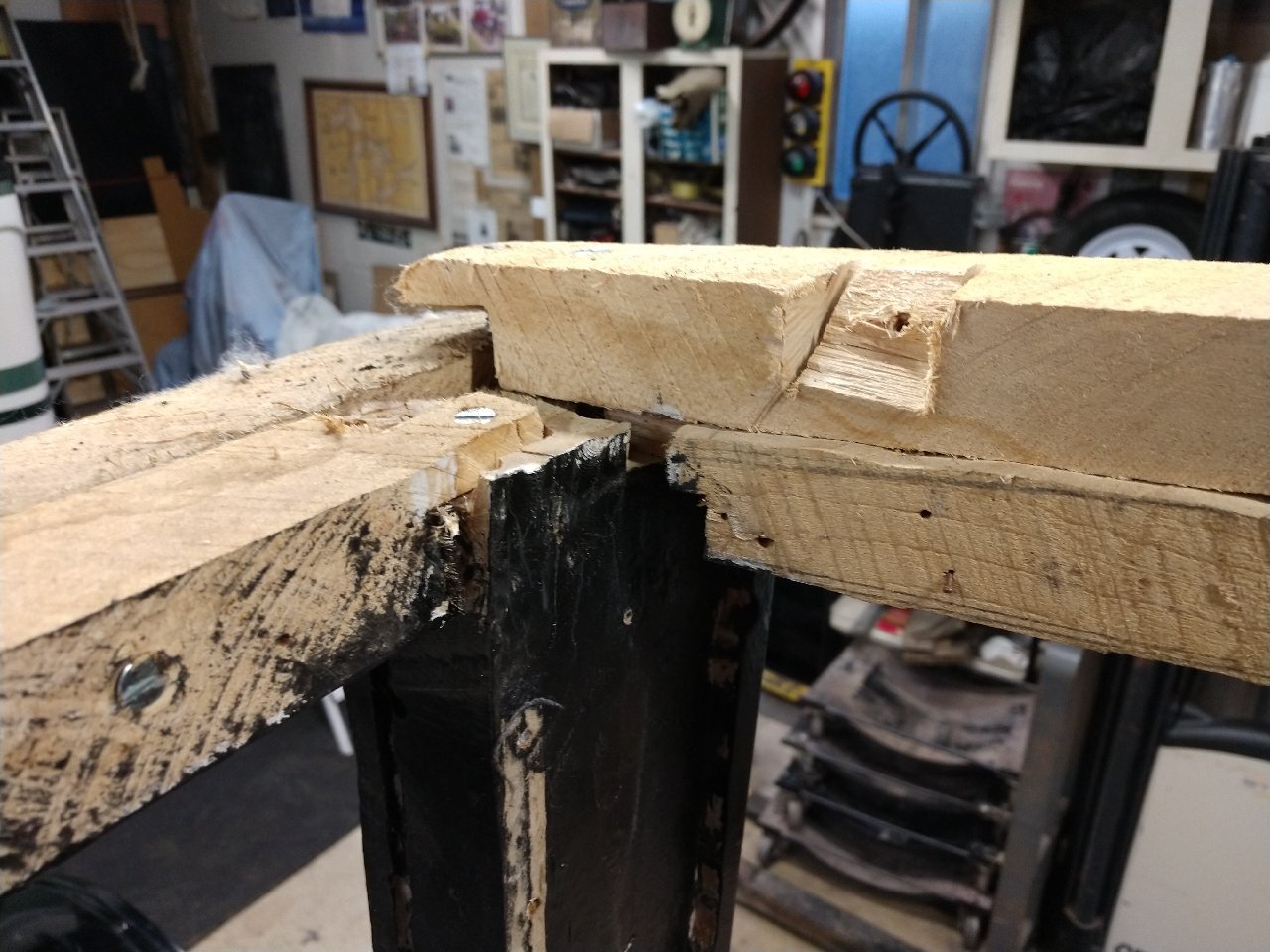

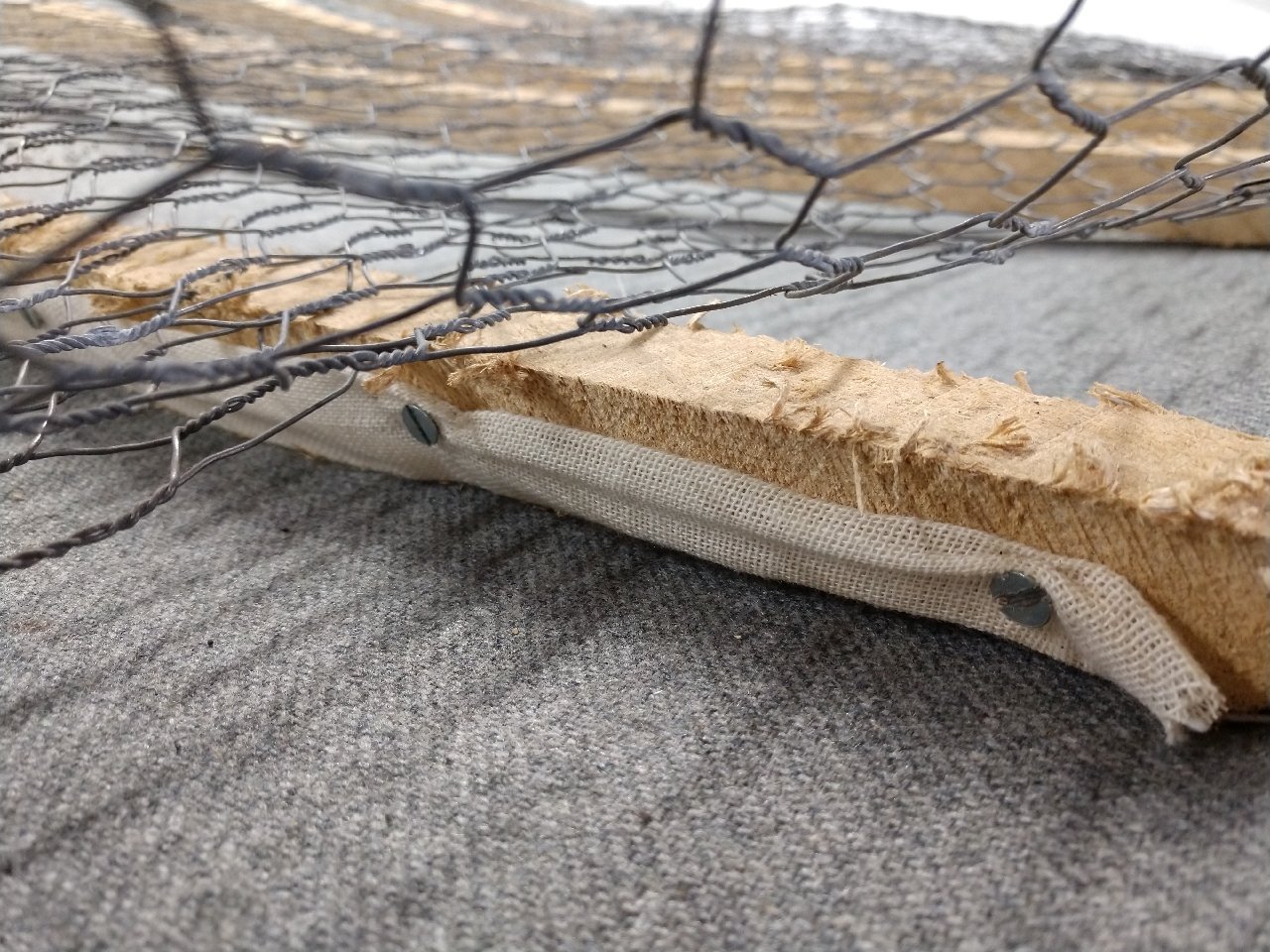

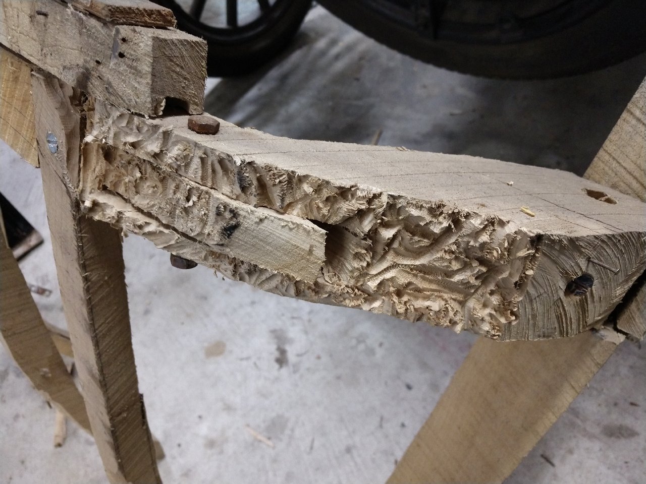

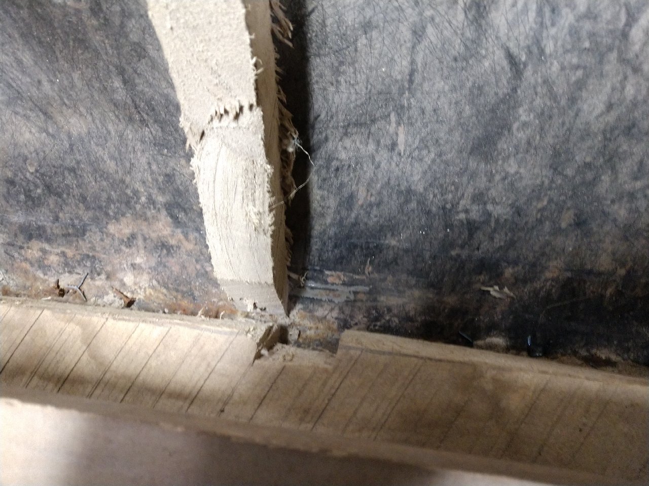

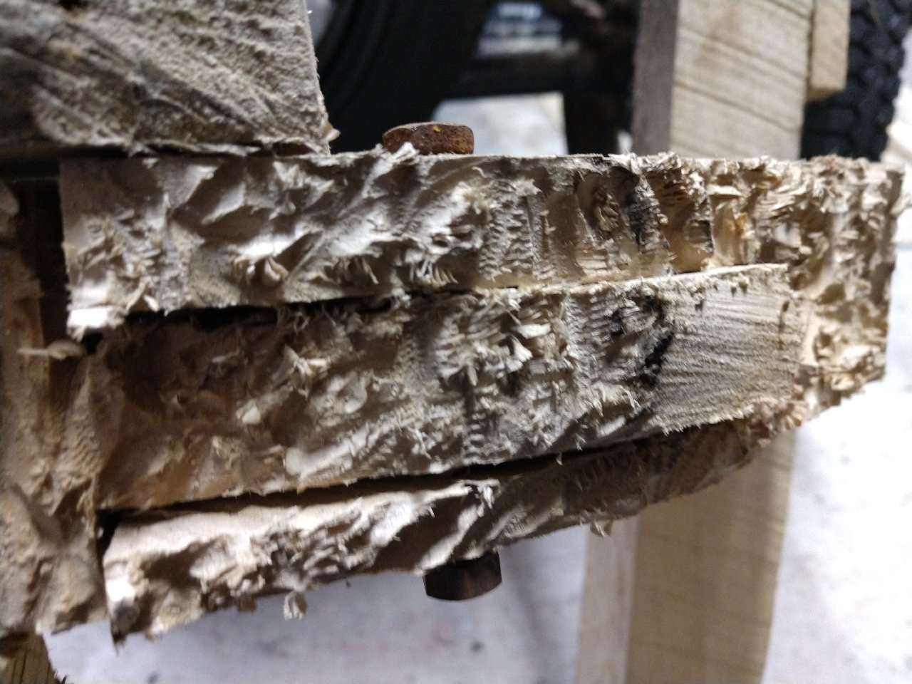

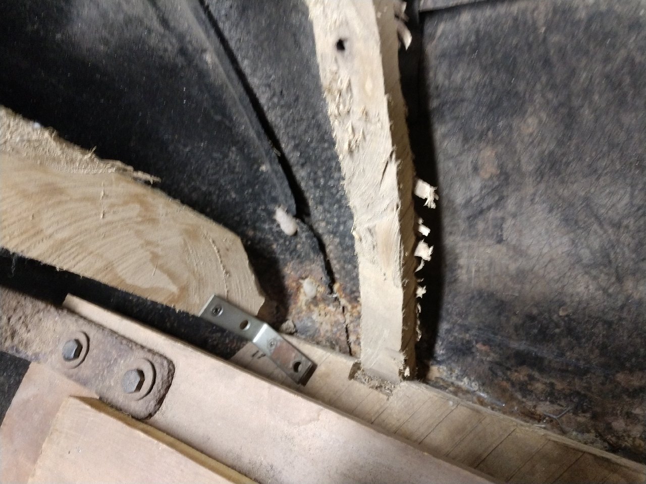

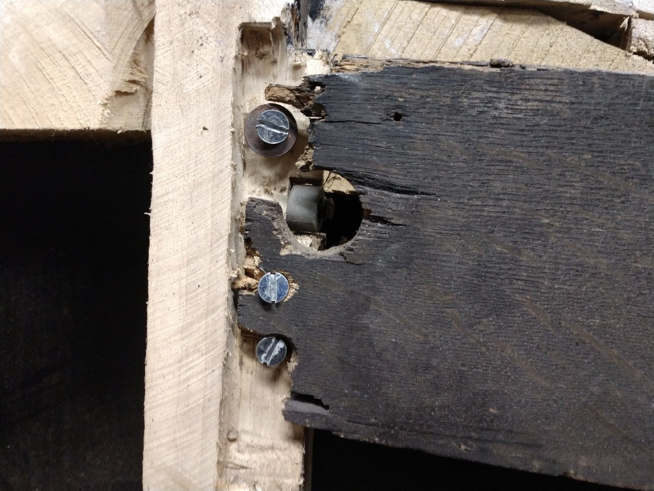

Oh boy... Buyer beware. This thing was obviously slapped together to increase it sale price. I didn't go for it but now i'm amazed at what i'm finding. The "D" pillars are suspended along with the vertical slats. I don't mean to knock someone's attempt to restore a car but this isn't restoration.
- Posts: 2842
- First Name: Dallas
- Last Name: Landers
- Location: N.E. Indiana
Looks like some nice pallet lumber was cut with a hatchet to build it. A bit more detail was needed? I like the double switch on the dash. More work than I would want. Im sure you will be knee deep in sawdust soon and have a real nice T by spring. Thanks for the photos!
- Posts: 4671
Well at least you have some wood structure to by. Sort of and better than nothing. I guess!?

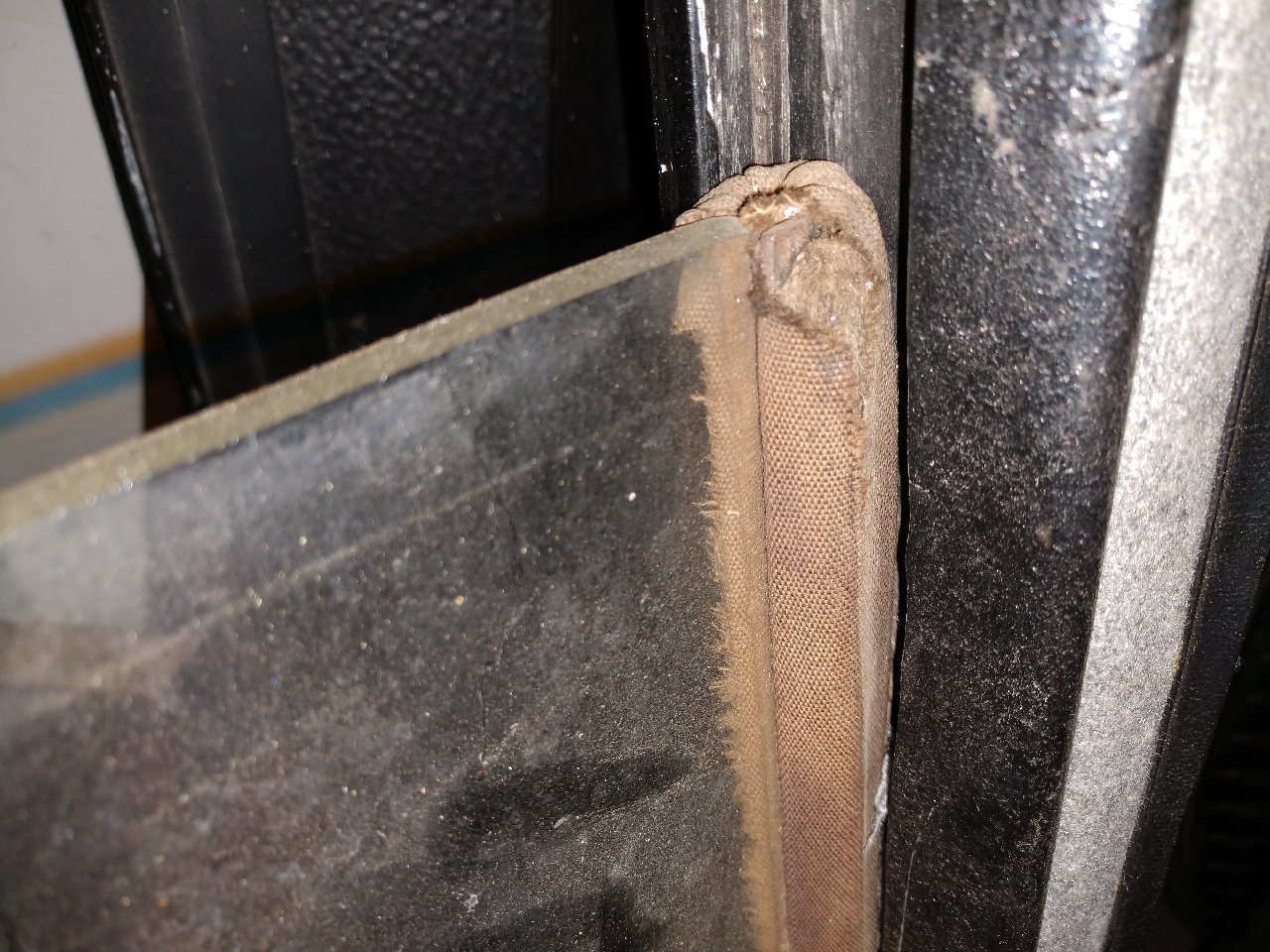

Wow, what a challenge...I understand the concern of many as to the quality of wood working....very umm....interesting, the top bows look like they were put in upside down, and those steel l brackets ! ?? Would be helpful if any of the original wood came with it, not only for patterns, but also to ID the body builder...I suspect this one is a Fisher body , but the door latches puzzle me, my '19 CD has latches go thru the "bottom" of the window frame, are several inches taller , and face the other way ,also no brass around them. Have you checked the headlights yet, should have 2 bulbs, as used in 19 & 20 closed car only. While you certainly have your work "cut out" for you, I wish to thank you and the fellow who did this attempted rebuild for rescuing this rare model from the bone yard...I look forward to seeing the process going forward...this forum continues to be a great source of info for myself and others. THANK YOU FOR SHARING...Best wishes, respectfully, John
- Posts: 4404
Wholly Moses! I have finally seen woodwork FAR worse than I have ever done! I mean, I know I have done a lot of "cannot afford better" "low budget and cut a lot of corners" restorations over the years? But never anything nearly THAT bad! And yes I have used free pallet wood, but I sort through it and cull out anything not decent enough.
At least the car got the right person to do this now. Don Booth, you are/is the best for this for certain (along with Charley Shaver IF he was still doing this sort of thing). No doubt when finished, this will be one of the best center-door sedans around!

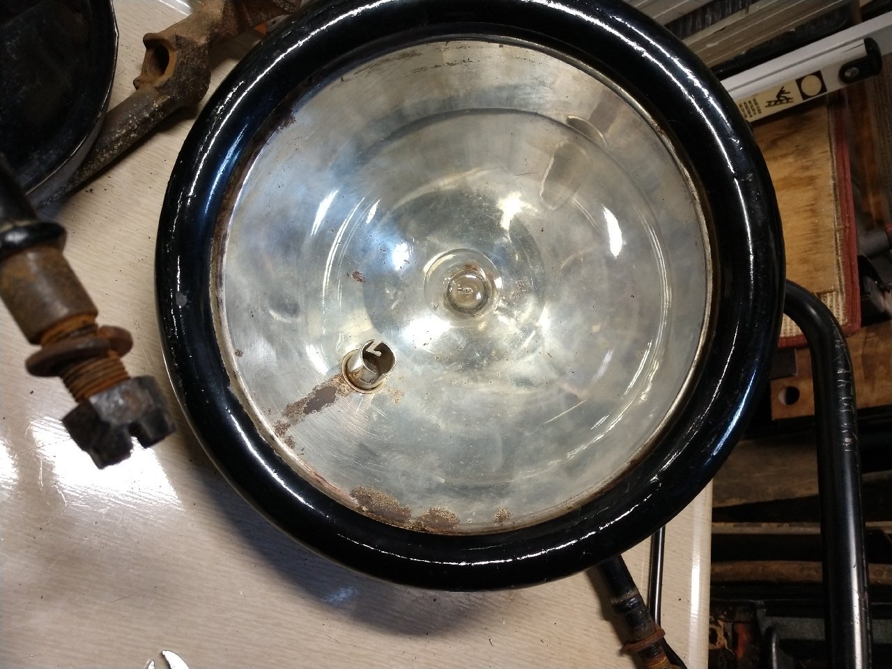

John S-M, So that is the definite distinction for those "two-bulb" T headlamps? I have wondered and asked a few times on this forum in the past about that, and don't recall a definitive answer (maybe I missed it?). I have read quite a few opinions, speculations, and over the years later proven wrong devoutly-believed ideas. 1919 and '20 closed cars "only" makes better sense given the numbers of lamps around than almost any other ideas do. (I hope my aging memory can file it properly ?)

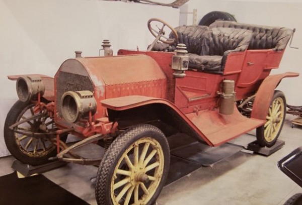

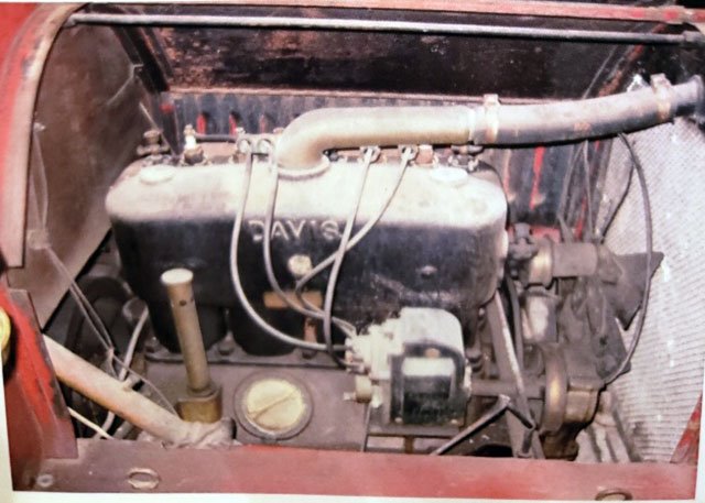

This is the '10 Fuller I was referring too...
Someone ate 30 pound of sugar and took a can of red paint and brush to it.

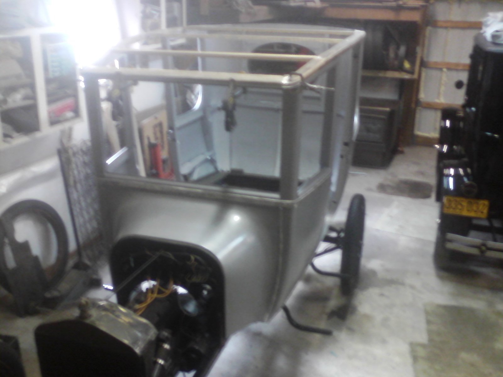

Frank, Scott are you sure it wasn't the write up of Les Sumners Centerdoor? Les lives about 45 miles away. We have known each other for several years now. Les is a perfectionist at everything he does and heck of nice man. He took the old fabric material from my 1922 C-door and actually duplicated its design. Les had his C door at the Standish Model A and T show this summer. It was by far the best car there and the interior was incredible. I will be using him for details on this restoration, he doesn't know it yet so don't say anything.

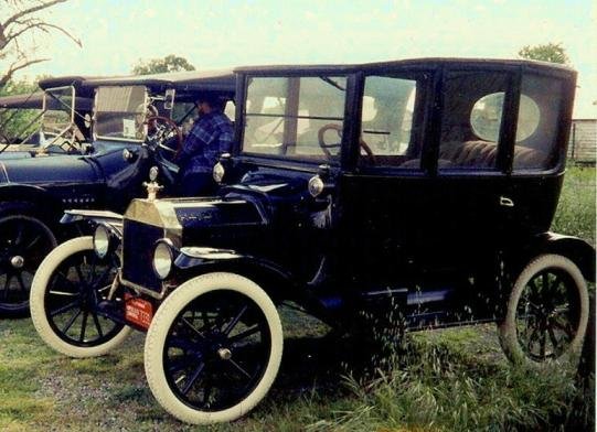

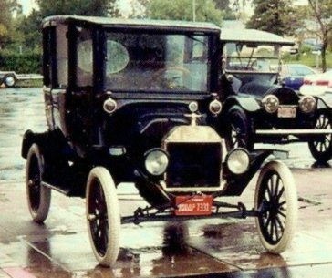

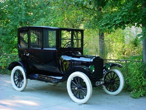

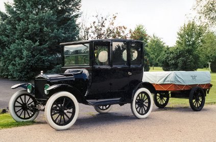

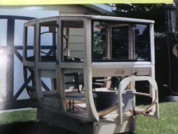

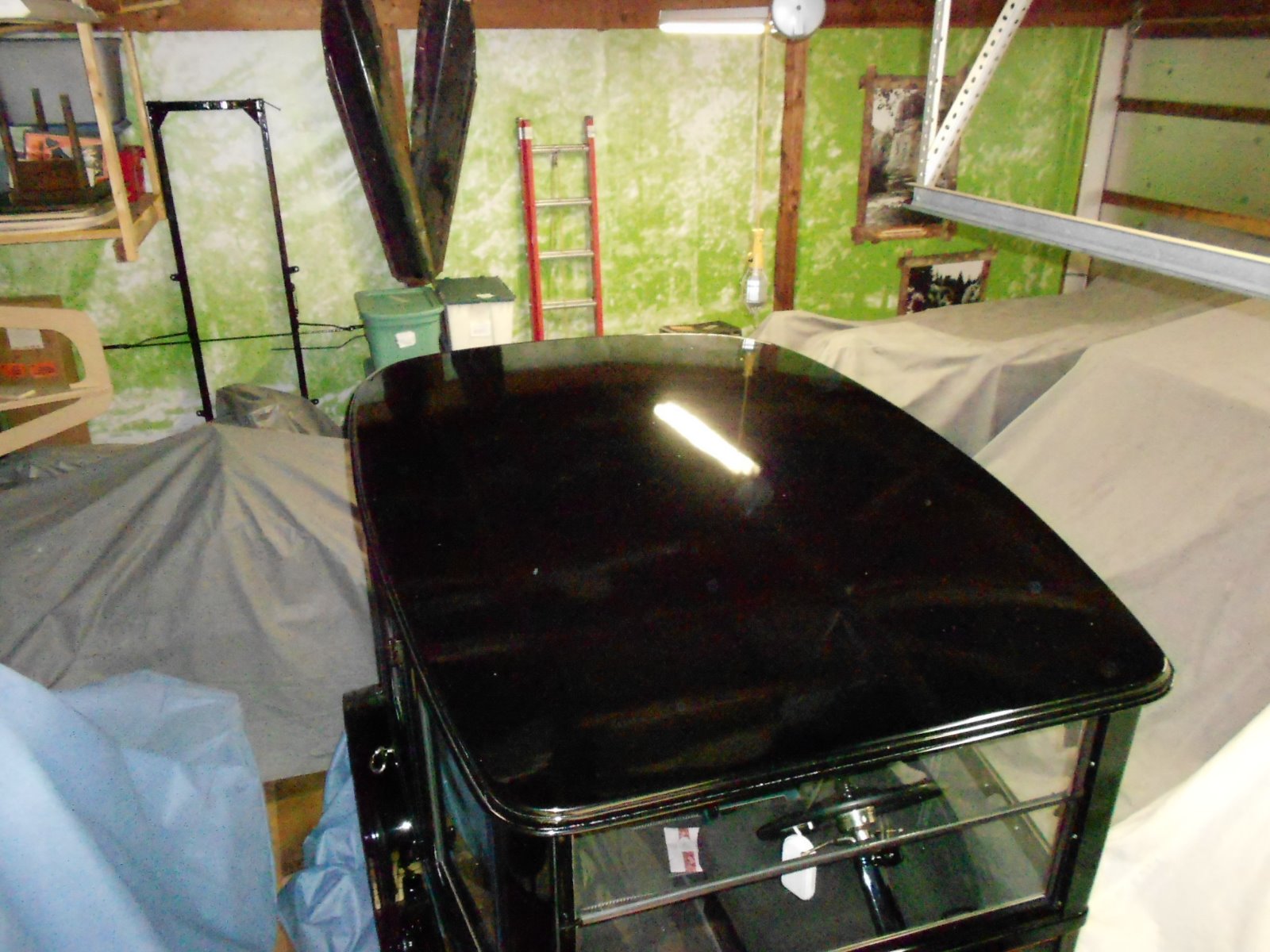

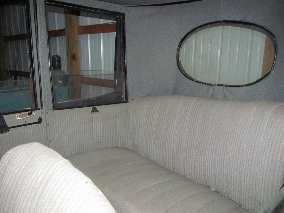

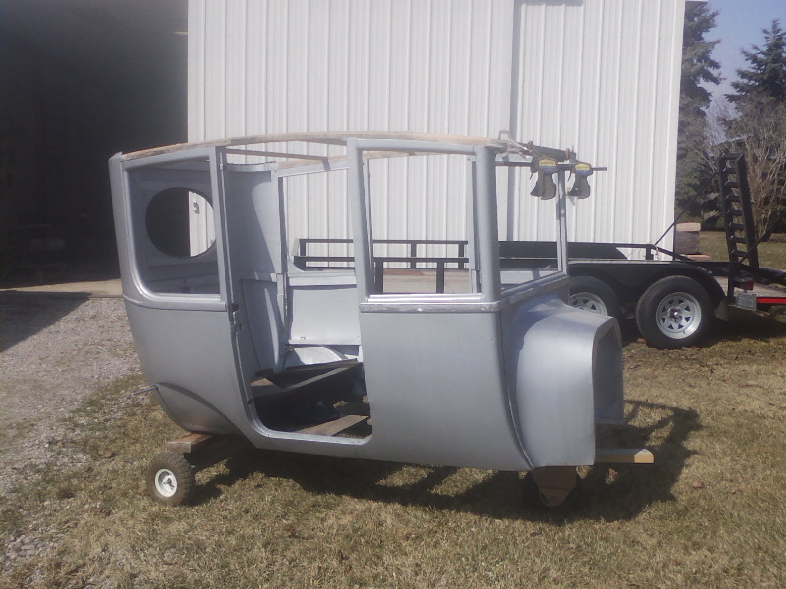

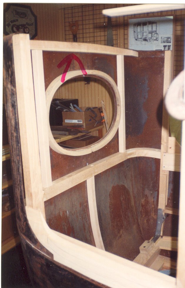

This is some of the pictures of Les' C door.

Don, I always look forward to your wood car adventures. You have a 3 dimensional brain, which is a rare thing and will be much needed on this one. I have seen worse, many , many years ago. It was a packard body where some “restorer” poured fiberglass resin down the termite infested pillars. Have fun, I already know you like the challenge!

Les' car is gorgeous and may have in fact been in one of the magazines...I don't know. If so, it is a striking example of woodwork, as I know you are going to do. With respect to my instance, I was indeed referring to Joe Fellin of Apache Junction, AZ., and his series of articles.

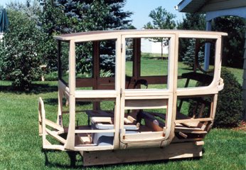

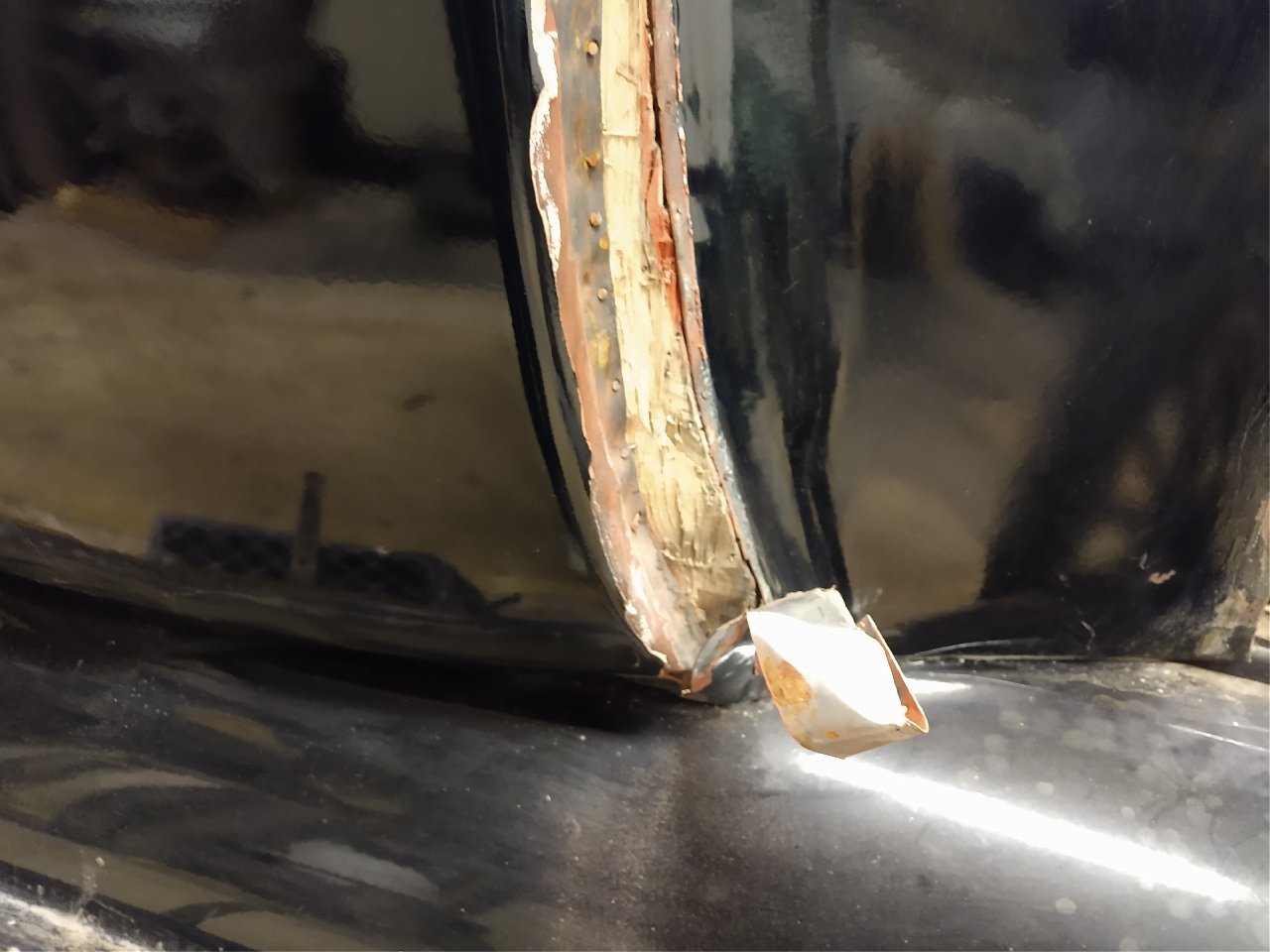

The wood in Joe Fellin's Centerdoor, while an ambitious restoration, was not anywhere near the caliber of Les's centerdoor wood.
And that's just the opinion I formed from looking at both. I'm not degrading Joe's restoration at all, because restoring a center door is a daunting task. (i know first hand), but Les did it like the factory.

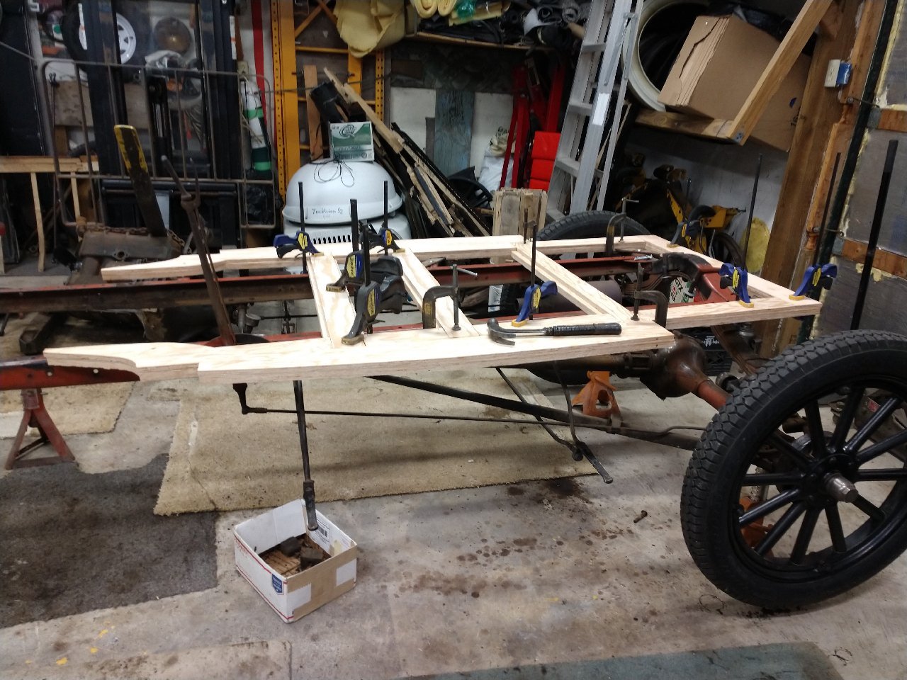

i have rewooded 6 of them, you have got your work cut out for you. i still have all the patterns charley

Don, that wood sure looks like Cottonwood from here, and yes, a lot of pallets are made from it. We have a lot of it here in the MO. River bottom area (N.W. MO.), even had a sawmill here that made pallets from it, at least before the MO. River floods hit in March. Floods are still going on. Dave

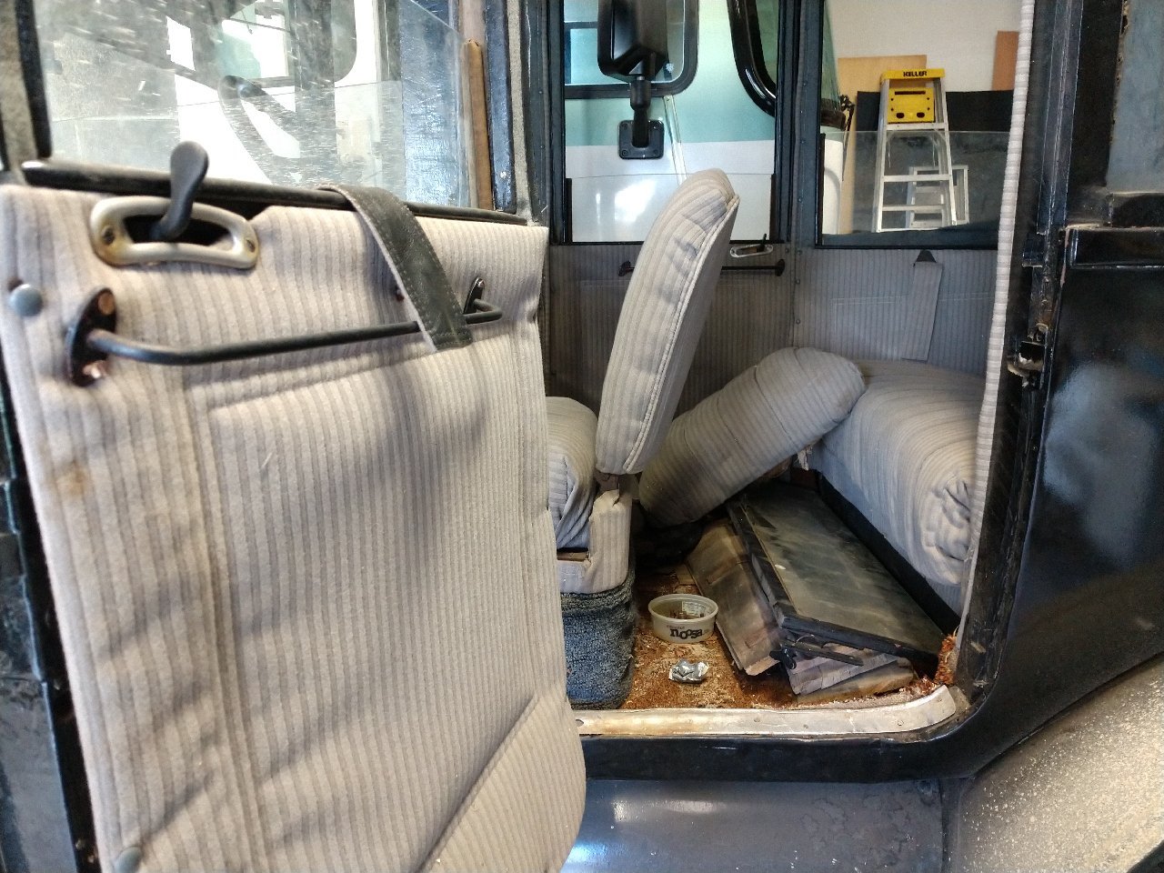

This car has a two filament socket on the passenger side and single filament socket on the drivers side. I have a feeling the drivers side headlight is incorrect for the car.
Now I have to wonder how the heck the prior managed to put the cobra grain top on? The rear window panel (shown here) shows the cobra grain under the top of the steel rear window panel, along with the padding. They must have put the top together and then mounted the rear window panel ?? There are many ways to skin a cat... and a T.

Well lets talk tolerances. This is one way to fit the skin to the psgr side A pillar. Looks like it came up short by about 1 1/2". Hmmmm what to do?? What the hey, I'll just nail a patch in dar….

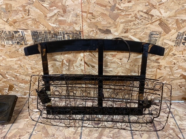

Hate to keep beating this dead horse but how much work goes in to this kind of sculpturing? I can't even tell what type of tool was used.
After removing the body nails the entire rear wood came out in one piece. Frightening !! The last picture show a frame mount to nowhere.
- Posts: 2842
That is one rare body Don!!! Beaver built bodies of Bay City are RARE !!!! Thanks for photos because words would not do justice.

It is amazing what can be done with a bow saw and an axe. No power tools and batteries needed.

Firstly HELLO LES !!! I hope you are doing fine. I miss our talks !

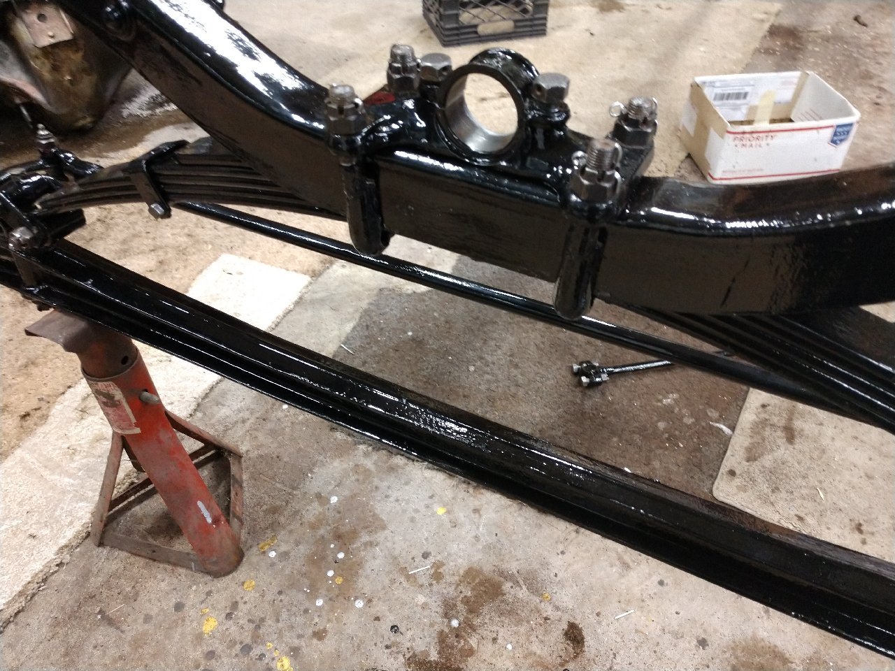

Things are looking pretty dog gone good with the metal. That's a relief.

There, the easy part is done. Let the good times roll !!

NOW, its been brought to my teenie little brains attention that I may actually have a 1918 Wadsworth body here. The wood that I have removed all had pencil marks as if the prior traced the shape from the original wood. This would explain the four vertical rear panel braces. It would also explain the window channel being attach to the glass and not the pillars. Other oddities like the wood work around the rear window. Its ALL different from the slightly later Centerdoors. IF ANYONE has any information or pictures of the 1918 Wadsworth body frame, I am in need. I can use the hacked up wood for a reference but I would really like to get it as close to correct as possible. Thanks in advance !!
Wayne, the station plays a mix of modern and vintage blues. I love it !
FordorGalore
Topic author - Posts: 430
- Joined: Fri May 03, 2019 8:20 am
- First Name: fore
- Last Name: door
- * REQUIRED* Type and Year of Model Ts owned: 1922 centerdoor 1927 fordor 1916 centerdoor
- Location: Nowhere Michigan
Thanks to Mike Husted its been determined that this is actually a 1915-16 Centerdoor body. So, that changes the plan of attack. This may be a much longer term project than previously thought. Using the original 1920 Fords part list catalog the conclusion is indisputable. The shopping list just grew exponentially !

My guess is that in the past somebody had a newer open car and used this body to make a closed car. I understand this was done a lot.

Yes I tend to agree that a body switch is most likely. But, its hard for me to believe this thing was used much at all. It just wasn't put together in a safe way.
This WILL be a long term project and I will be taking my time with it. In other words "Having Fun" !

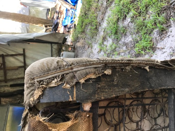

Don, that is an ambiguous project but very rewarding when completed. I know little about the centerdoors but like the style.

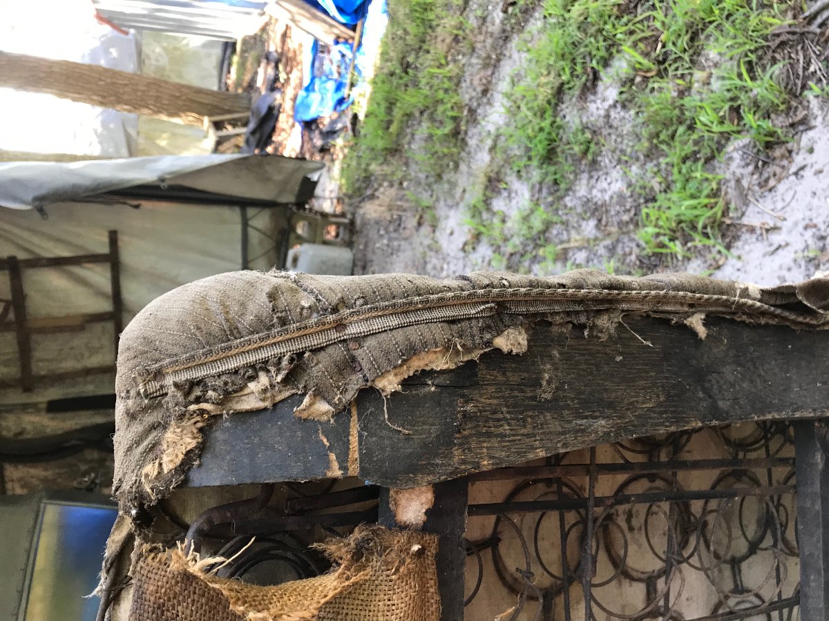

I have posted a picture of a seat back frame I have and suspect it’s T era. If it looks like it works for you let me know. John (Yooper part of MI)
FordorGalore
- First Name: fore
- Last Name: door
J that looks like a Fordor rear seat frame. It may very well work on this centerdoor. It had no seat back frame so …..can't say for sure. Now, my '22 centerdoor had a similar frame also.
My 22 rear seat back looks like John's. It curves at the top like his and is square at the bottom. Here's showing me removing the upholstery from it.

Right now its the least of my worries. I'm currently tearing the chassis apart and cleaning everything.

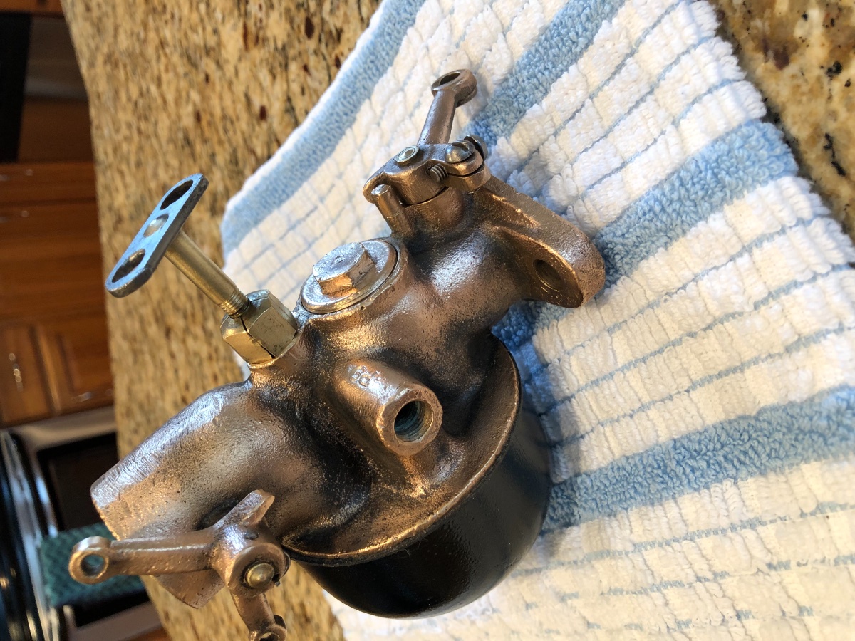

Interesting headlight, the Fed's wanted Henry to make the headlights brighter. His reaction was to install another socket and lamp.
Roughing in the base wood for this beast. Its all oversized so I can fine tune the body fit. Never enough clamps around for this.
Mark Nunn
- Posts: 1288
- Last Name: Nunn
- Location: Bennington, NE
I would put some old shoes on those running board brackets. You don't want to find those brackets "the hard way".
Don,
Today is the first time I saw this thread and I would like to thank you for posting it and sharing all the pictures.
If you are storing pictures and records of your rebuilds on your computer PLEASE use a back up file system. I lost all my rebuild information when my computer crashed a few years ago.
Old shoes over the running board brackets is a good suggestion...I used foam pipe insulation and pool noodles and it saved my legs many times.

- Posts: 7411
Is the chassis 1915 too?
FordorGalore
- First Name: fore
- Last Name: door
Steve, I would have to have someone that knows take a look at it. From what I've gathered it is or its very close to it. But I can be proved wrong rather easily.

:Don, looks like your making good progress on the rewooding foundation . Soon you will be ready to install the Carberator

While the Kingston L2 was available beginning in ‘16, the two armed choke indicates that the carb shown is a ‘19 or later example. The Holly model G was available through ‘15 and ‘16 and could also be considered depending on the chosen target date.
- Posts: 4404
1915? 1916? While they may look alike in photos? They are TOTALLY different bodies! The '15 skin is mostly aluminum. The '16 skin virtually all steel. The rear tub is multi-part sections, the aluminum rear tub as a skin is one piece. while very similar, near every dimension is different. I have never seen one up close, nor have I seen photographs that clearly show it. But I have heard and read that the outside of the body hanged slightly below the top of the frame. I have heard and read that a few special parts unique to the '15 were required, but I find myself doubting much of what I heard and read years ago, because as much as I have looked, and studied photos, and seen? I have never seen those unique parts.
The true '15 is not quite as tall as the later C-doors. The rear window, still oval, is slightly different size. The windshield/visors are unique to the true '15 model. And again, body-wise, almost nothing is interchangeable between the '15 and the '16 models.
Production of the true '15 center-door sedans ended mid-year as hundreds of unsold sedans sat in storage awaiting sale. Remember, only about 950 of them were produced.
The '16 model center-door is a whole mystery unto itself. Very little is really known about them. In fact, until recently, it wasn't even known for sure that any were even built originally. Nearly thirty years ago, Bruce and I had a discussion about this subject. It was after the big black book was published (B's bbb), and I was restoring what was believed to be an early '16 center-door sedan. In his books, it was stated that no evidence was known that any "brass" '16 center-door sedans were built. However, Bruce said that some may have been, and admitted there was some evidence to that effect. (Later, I may post some notes that can be looked up, including an illustration in B's bbb.)
I lost track of the details, however, shortly after Bruce passed on, a researcher at the Henry Ford (or whatever name the Benson archive was going by at the time?) found a record of a small number of center-door sedans that were in fact built in December of 1915. Last I heard, total production number is not known, but is thought to be less than a thousand for all of 1916 also (it may even be much less?).
The car I restored is an issue itself. It had suffered a really bad 1950s restoration. NO attempt was made to keep the car correct. So everything about the car is suspect. However, it was claimed by the restorer to have been a real brass center-door sedan before the bad restoration was begun. It was toured in the late '50s and early '60s with San Francisco Bay Area antique automobile clubs. I never found it, but was told it was even pictured in a national club magazine. All of which really means nothing. A (then) well known collector bought the car in the mid '60s, intending to re-restore it. To that end, it was taken apart. However, then he found a "true '15" center-door sedan, and had it fully restored instead. With no interest in having two such cars in his collection, it (mine) got sold as a basket case. It went through at least four (I think five or six) more different owners before I ended up with it. Each of those owners provided some pieces it needed. And lost a few that it had had. By the time I got it, there wasn't much telling what was original to the car, or not. However, there were a few details, that my car had before I got it that made it different from any other center-door sedan I ever saw, except for one.
That one was owned by some longtime good friends of mine. It was also a very interesting car. For one thing, it was a Canadian built brass era center-door sedan complete with several Canadian features and details. However, it also had been poorly restored many years earlier with a loss of some of its correctness. Although owned by good friends, we somehow never got the two cars together. They saw my car and compared details several times. And I looked over their car a lot of times.
Comparing the cars was interesting for sure. And I think somewhat informative. The Canadian C-door had its original gasoline tank still under the rear seat! The rear seat riser/framework on their car and mine were basically identical, and not like any of the twenty or so later center-door sedans that I got to look at the rear seat risers in! So, our two cars, both believed to be originally early '16 T center-door sedans, had the seat riser designed for the gasoline tank. My car however showed no signs of ever actually having the under the rear seat tank installed. Their car had the front seats replaced by a previous owner to include the later driver's seat gasoline tank (the car did not have that originally!). My car had the gasoline tank under the driver's seat from new. My car also had unusual front passenger seat riser/posts. Their car had the common later style because both seats had been taken from a later car. I only ever saw one other teens era C-door with the passenger seat folding riser/posts like mine.
The Canadian car had some of the usual Canadian things, Robertson screws, fork mounted headlamps.
One of the things I discovered on my car while restoring it, was that the spark/throttle stamped quadrant was originally brass plated! For a late '15/early '16, I think that would be unusual. It of course had the early electric horn button, and the combination of the two features, one mostly early '15, the other mostly later '15/'16, I think was unusual in itself.
Unfortunately, we didn't keep the early center-door sedan very long. We sold it to buy a horseless carriage my wife wanted us to have. I soon lost track of it. I wasn't happy with the fellow I sold it to. And when he passed on a few years later, his estate sold it to a nasty collector/dealer (a two-face liar of the highest order). I have no idea where it went next. I do hope it got a good home/caretaker at some point. The car was worth proper preservation.
Your car? My opinion? If there is sufficient reason to believe it is a '15/'16? It very likely is not a '15 (unless most of that body metal is aluminum?). So restore it as an early '16. If you wish, get a December '15 block, and target December of 1915. That way, you can slip it into the HCCA. Otherwise, anything first half of calendar '16 would be great! There are a lot of fake '16 center-door sedans. Most of them poorly done and obvious to anyone that knows the '15/'16/early black era differences (I have seen a couple with early '20s chassis!). Also my opinion? 1916 is not well enough represented in the antique car hobby.
- Posts: 4404

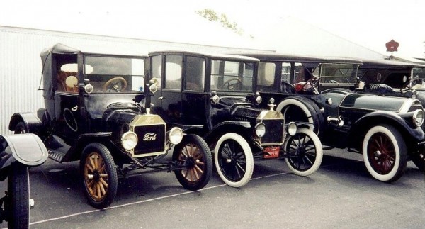

A few pictures of my '16 many years ago, on tours.
FordorGalore
- First Name: fore
- Last Name: door
Thanks Wayne for the information and pictures of your C-door. This project has more questions than answers and I don't pretend to know exactly what the story is here. The information I received from the original 1920 Ford parts catalog does confirm many of the parts as being '15 and '16. My conclusion is the car is most likely a '16 and likely a late '16? Any 100+ year old car has been tampered with and at this point its unknown just how much was changed. I would be the last person to claim this thing to be a original anything. As for now it seems to be a gray area at every turn. I haven't decided which way to go with this thing. The evidence points in many directions and questions are plenty. It would be more cost effective just to put it back together and hang a question mark on the license plate. However, I am enjoying the debate this one little car has stirred up ! Just the fact that there is no one clear answer is what makes this project so fun. Meanwhile I will make my way thru the snow to the barn and crank up the heat and the blues and pick away at yet another historical artifact with just a bit of a smile on my face.

Don, this may/may not be helpful.
My 1915 Canadian tourer had firewall to frame brackets whjch still bolted to the top of the frame rail. They were unlike the previously forged 3 hole brackets, being made from flat strip. They followed the frame at the foot, bent upwards and then back fown again, to pick up the frame rail again. They used the same two holes in the top of the frame rail for mounting, but had just two holes for bolting to the firewall, just like the later brackets.
From your frame photos, I can see no holes in the top of the frame rail, but can see the two on the side for the later style. This may indicate that the car more likely to be later than 1915, but then again US production may be different.

Allan B, USA production also used those "bent strap iron" brackets for a short time in early 1916 models. Apparently, with some speculation involved, the plan was to change to the later style. However, probably due to one of the usual production delays, the new brackets weren't available on time. Pure speculation, the bent strap iron brackets were utilized to keep the assembly line moving. Also, apparently, frames had holes for both the earlier and later style firewall brackets for awhile. I have had at least two such frames over the years. Both of the frames I had used the earlier style bracket holes originally, with no sign that a bolt had ever been used in the later style bracket holes on the side of the frame rail.
At this point, it appears there is a lot of speculation about Don B's new project, and just what its history is. The body apparently has a few features unique to the '16 models, however, much of the car is considerably later. Was it put together from gathered parts and pieces? Did someone find a loose body and put it on a chassis they had hanging around? Nobody at this point seems to know. He gets to chose the direction he will take it of course. Personally, I hope he resurrects the thing as an early '16. He is the right person that can not only do the body right! I think he can make it one of the most correct '16 center-door sedans around. Most of the ones around, frankly, are terrible! Frankly, most of the '16 center-door sedans around are '17s to '19s and even a '21 I saw some years ago. Just because someone puts on earlier fenders, hood, and radiator, doesn't make the thing an earlier car.

Thanks Sheri, Allen and Wayne. The frame has numerous holes drilled in it both on the side and top. I have looked them over and the side holes show no sign of ever being used. Normally you would find some corrosion from moisture being trapped but the frame is as clean as new. The inside of the frame shows no sign of nuts being tightened on it.
Wayne I want to get the car put together correctly as a '16. I haven't put a lot of time in researching the '16 but what I've seen so far it is hard to find solid information on that year. What I have learned is much changed in '16 and a early '16 compared to a late '16 is a different car altogether. This is what makes this hobby fun and at this point I have plenty of time to get it all figured out. The re-wooding of the body will be the challenge for this winter and maybe beyond. Thanks for all your help and knowledge of this project, its extremely helpful and welcomed.

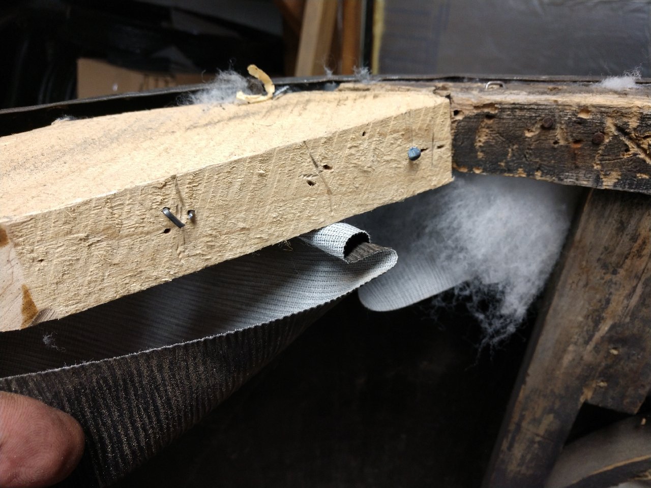

I'm thinking this is the original glass channel...what do you think? Also a picture of the firewall bracket mounting holes.
Lessumner
- Posts: 53
- Joined: Sun Jan 06, 2019 5:16 pm
- First Name: Les
- Last Name: Sumner
- Location: Lapeer Mi
The windows look correct. My 21 has the same window treatment. The padding covers a steel framework that includes the attachment of the lifting strap.
Your frame holes for the firewall brackets is the change period from forged to pressed steel style. Les Sumner

Nothing sweeter than a tight front end. New bushings thru out and she's good to go!

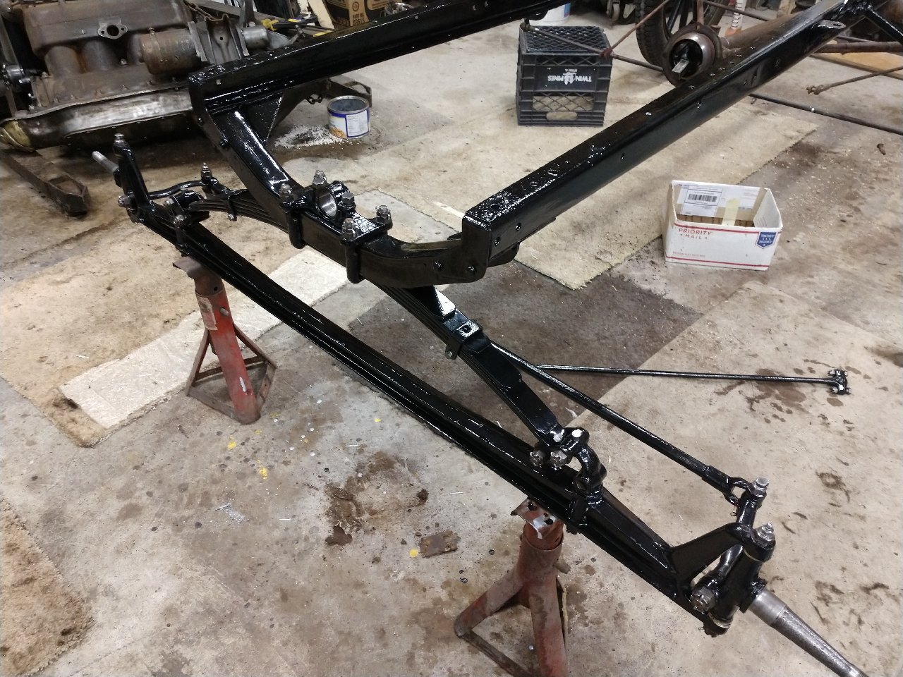

I found the drivers side of the frame had a slight bow in. Took a 20 ton jack and straightened it out. Just part of the fun !

Are you sure twenty ton is enough?!
Kidding. The last one I straightened I use a trailer tongue and leverage!

Yeah it was a bit of overkill but I got it within a 1/16". The funny thing is, the frame was bent inward right at the running board brace. It looked to me like it was done at the factory. The brace still has the original rivets and no sign the brace had had any impact. It wasn't off but maybe 3/16" and only the top of the frame was bent inward. So I got it as close as I could without overdoing it.

Within a sixteenth of an inch sounds pretty good!

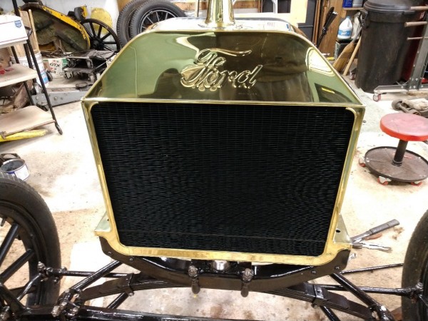

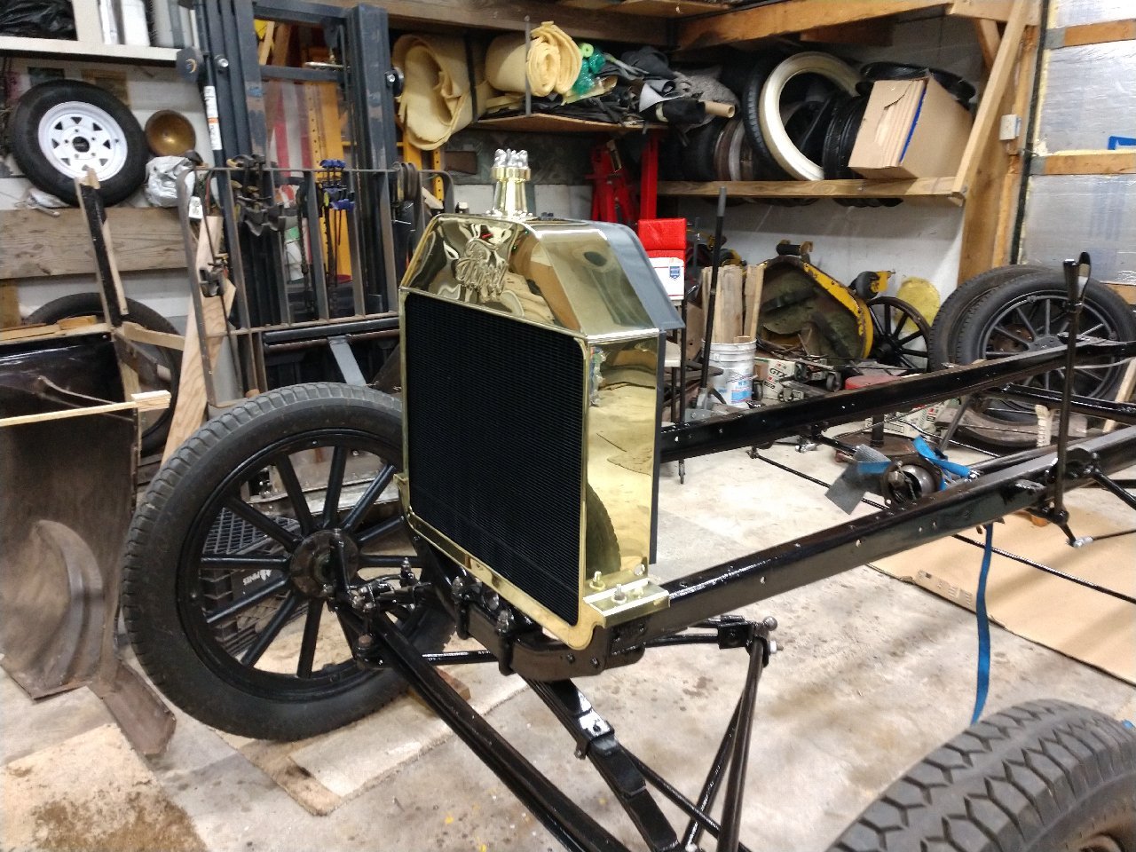

Went thru the front end and the rear-end. Frame is straight and painted. Brassworks stock just took a jump!
