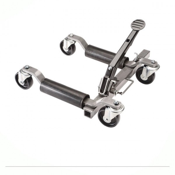

That would be a lot of work to remove the driveshaft! Dolly or flat bed. Short distance, plugs out in high maybe. I would not suggest towing with back off the ground, the steering would have the car all over the place and I would not trust a rope to hold the wheel. Find a clear area and try backing up a little faster then normal, but be prepared to have the wheel ripped out of your hand when you loose control.

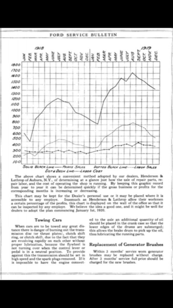

I don’t think there is a safe way to flat tow a T at all. The last time this subject came up there was a fellow that jumped in and told of the time he tried it and destroyed his engine and transmission. I would only tow a T if the wheels, all the wheels, were off the ground. Flatbed or trailer only.

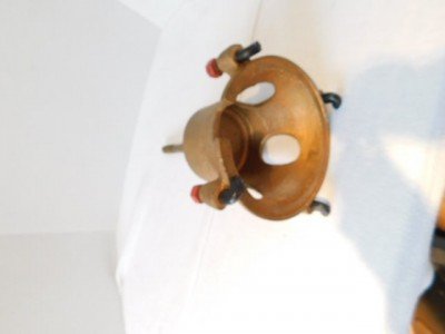

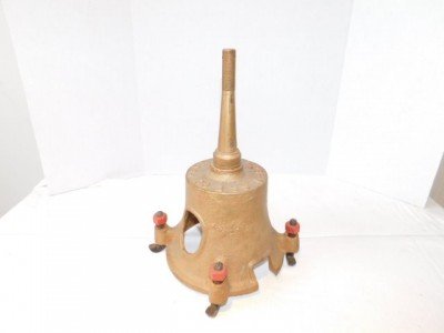

As far as towing "back in the day", a rear wheel could be removed from the axle, this device could be installed over an axle shaft, the wheel remounted on the device, and the car safely towed with the rear wheels on the ground. It was made specifically for this purpose.
Most people mistakenly attribute tool this to facilitating the retrieval of a T that has a broken axle (and it will do that), however that is not it's primary designed purpose.
as I recall the story, it was a worm drive TT and it was towed a considerable distance at a considerable speed.
They can be towed, at a low speed, under conditions as I related above

Take a good look at the tool Scott C shows above. Think about it. There were other tools made to tow a T with a broken axle. The one he shows is made to tow a T with other reasons for towing. The "spindle" is held out away from the backing plate because it is intended to go over an intact axle. If it were intended primarily for towing a T with a broken axle, there would be no need to hold the spindle so far out as usually when the axle breaks, it comes out from the rear end (yes, I do know there are exceptions to that), leaving a close connection practical. Scott C's device is made to clamp onto the backing plate over an unbroken axle.

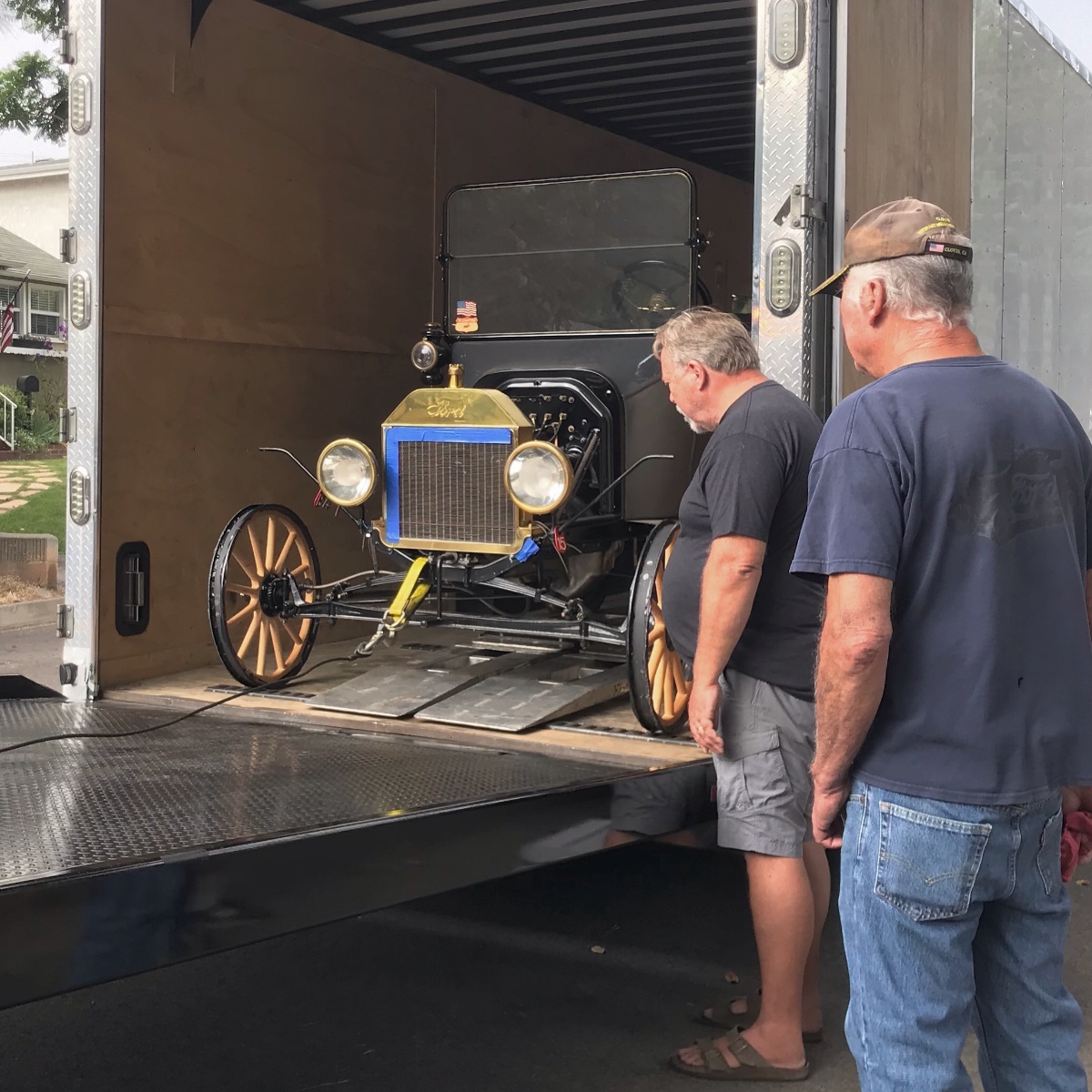

The Difference

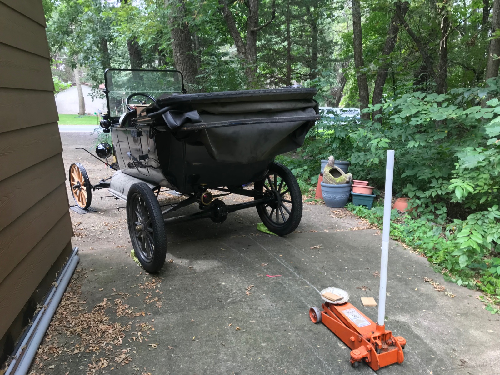

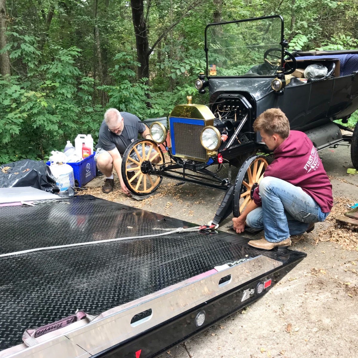

I recently had a “ locked up “ Model T to pick up on a Sunday kinda out in the sticks.
This Model T belonged to Ken Jones in Minnesota who passed earlier this year - KD used to clean and polish as a kid growing up in Washington state.
This Model T started it for Kim ....
Larry ended up buying the car to finish restoration.
Like every Model T that I haul - it had an important history ....
It also had no tires - but nice wooden rims that the new owner had tried to protect with blue painters tape.
I called out a rollback tow truck.
We used floor jacks on the rear pumpkin and front axle to lift the T on wood blocks to get it from the rear garage on the property up to the driveway where the rollback could grab it and carefully winch it onto the deck using skates.
Then we transferred it into my enclosed trailer.
This took a few hours - but no damage was done.
There is no substitute for Care and Experience.
FJ

Re: flat towing a T
I believe it was Floyd Clymer who detailed the plugs out rationale in one of his books.
When a T is towed in neutral, the flywheel is not spinning and the steel clutch plates lack lubrication as they rotate. Towing in high gear makes the clutch spin as a solid assembly and allows the flywheel to spin and provide lubrication to the moving parts of the engine assembly..

To Clarify
To Clarify:
Wheel Skates
Used by commercial tow companies to slide a non-rolling vehicle onto a rollback or other tow platform - they slide on diamond tread or aluminum deck or smooth asphalt/concrete roadways.
Typically used at accident scenes.
Wheel Dollies
Typically used on smooth & level hard floors to move a vehicle easily within a confined space.
Both rely on the weight of the vehicle & a smooth and level surface - neither device has a design provision for attachment to the wheel to keep the device secured that I have seen.
In the real world - when you are trying to move a lightweight vehicle that is locked up using either of these devices - on a broken or rutted surface that is not level - the vehicle has a tendency to fall off the device.
In the case of a Model T on nice wood rims with no tires - this can damage the wood rims.
Even with a person at each corner of the vehicle - it can prove difficult.
FJ
Wheel Skates
Wheel Dollies
FJ
