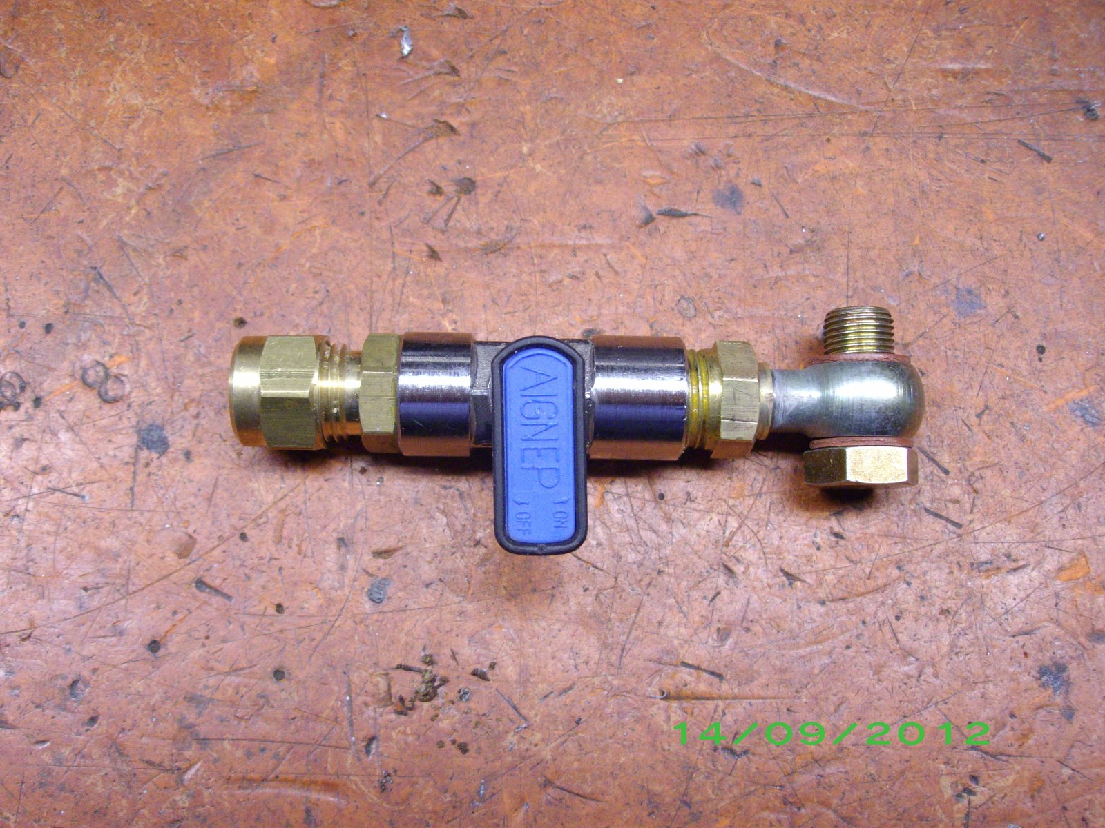

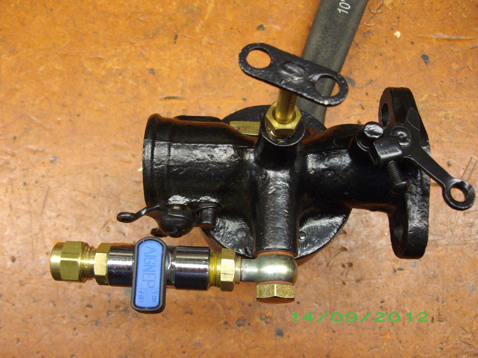

I use this one , I know it is not Original , but it works for me .
Toon
Toon

Re: New gasoline shut off valve sticking?
Anthonie,
I like your fuel shut off ball valve configuration. I do have a couple of questions. Is the banjo bolt that threads into the carburetor a straight thread. All the ones I have ever seen are straight threads with the two crush washers that make the seal. Did you rethread the carburetor to accept straight threads. I thought the carburetor has 1/4 pipe threads that make the seal. I am a new member here and I am having a little problem with gas seeping out of the standard shut off valve. I want to replace it with a ball valve. Your setup looks very nice. Thanks! Brad Hollan

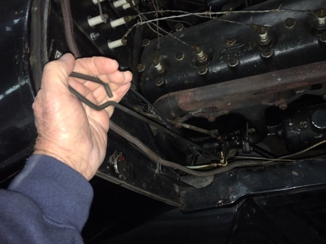

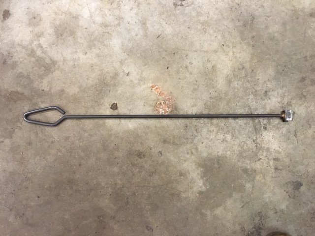

This works for me. Pretty easy, too.
- Posts: 5587
That tool would work much better IF you could slightly pull upward as you turn !
- Posts: 6789
Steve
isn't THAT the truth. The only thing I can seem to accomplish with those is to unwittingly and permanently jam the petcocks closed so that oil neither drips nor flows.

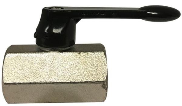

A possibility. A min ball valve with viton seals. ($4.11 + shipping) If the handle doesn't satisfy you desired vintage look, I'm sure you could fabricate one from your broken one. This company has several styles / sizes Go to their site and click on the PDF - datasheet on this page to see whats availabe
https://blackhawksupply.com/products/mi ... ball-valve

- Posts: 6789
Frank
these are an excellent choice and when properly fitted, allow you to remove the carb for servicing without losing a bunch of gas. While like most, I have carb-mounted valves and frankly while they stop the risk of fire and dripping, it is dumb to have them directly attached to the carb. My next project this spring is to fit a very similar valve as you have pictured, to my driver, though it will be one with a smaller handle. This really is the way to go...
