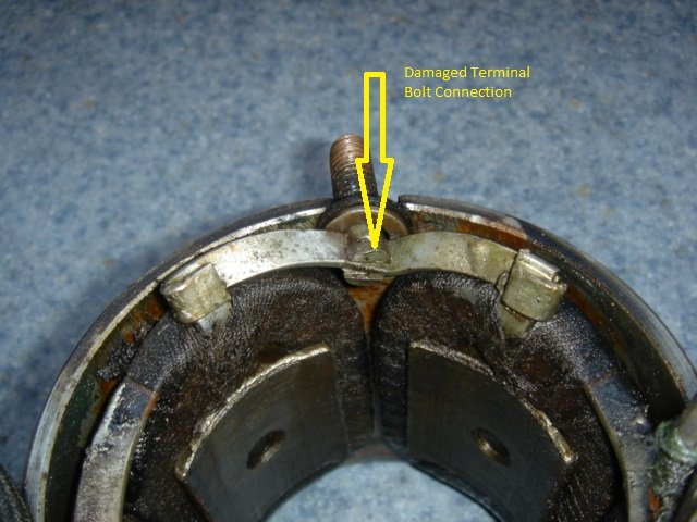

- Posts: 4684
Re: Is my starter toast?
Very often the post where the cable is connected comes loose inside the starter. There is a copper half circle strap soldered to the windings at each end and a post soldered in the center. That connection sometimes comes loose when you turn the nut to replace the cable. That's the first place I'd look. Also the brushes might be worn out.

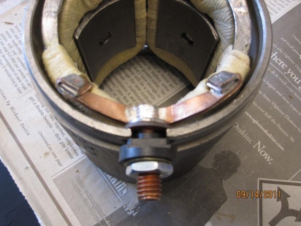

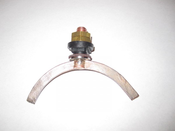

Ignacio
Here is a photo of the starter fault mentioned by Norman Kling.
This is by far the most common failure of Model T starters.
It can be repaired by replacing the terminal bolt with a kit available from Lang's Old Car Parts. The kit has a new terminal bolt and buss bar that is silver soldered and far superior to the original soldered Ford part. Complete instructions are included with this part. The only special tool you will require is a 250 Watt soldering iron.
Ron Patterson

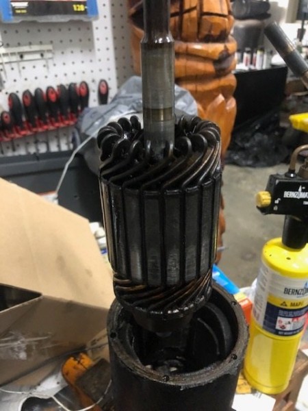

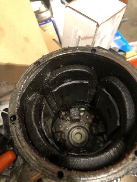

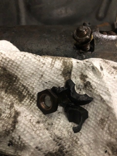

Here you go. The post is loose. The fork at the bottom of the post is clearly not attached. Can I solder it back on? The bake lite or plastic or whatever square retainer thing disintegrated. Unsure what to do about that. How can I tell if my brushes are worn out? They are worn. Also how do you retract the brushes to put the rotor back in?

- Posts: 5340
Repairable for sure - brushes are mucked up and the brush end is sporting the original Babbitt bushing.
No problem. The Bakelite, or plastic insulator is available from one of the many Model T parts suppliers. I’m glad you found the problem. Jim Patrick
