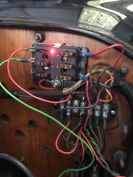

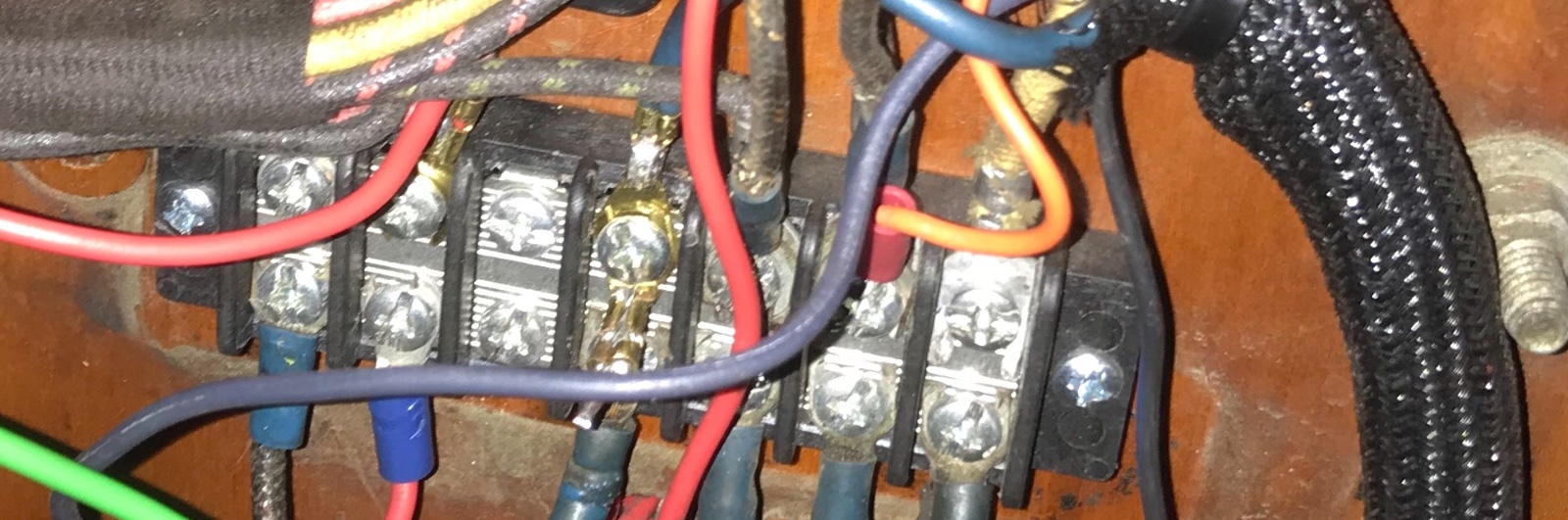

I've been planning on rewiring George for some time now and collecting parts. So after wiring Roberts new racecar, I got inspired and did mine yesterday. The Voltage problem is now solved.
New busbar: .
I even found a fancy small fuse panel that shows which fuse is blown. I know, not stock, but as much as I drive this car, these 2 upgrades will be totally worth it.
It's still a work in progress, but good enough to get me going for now, and it now starts easily. Unfortunately, it still has a slight occasional miss on acceleration, so that has to be gas. I see Winfield adjustments in my day today.

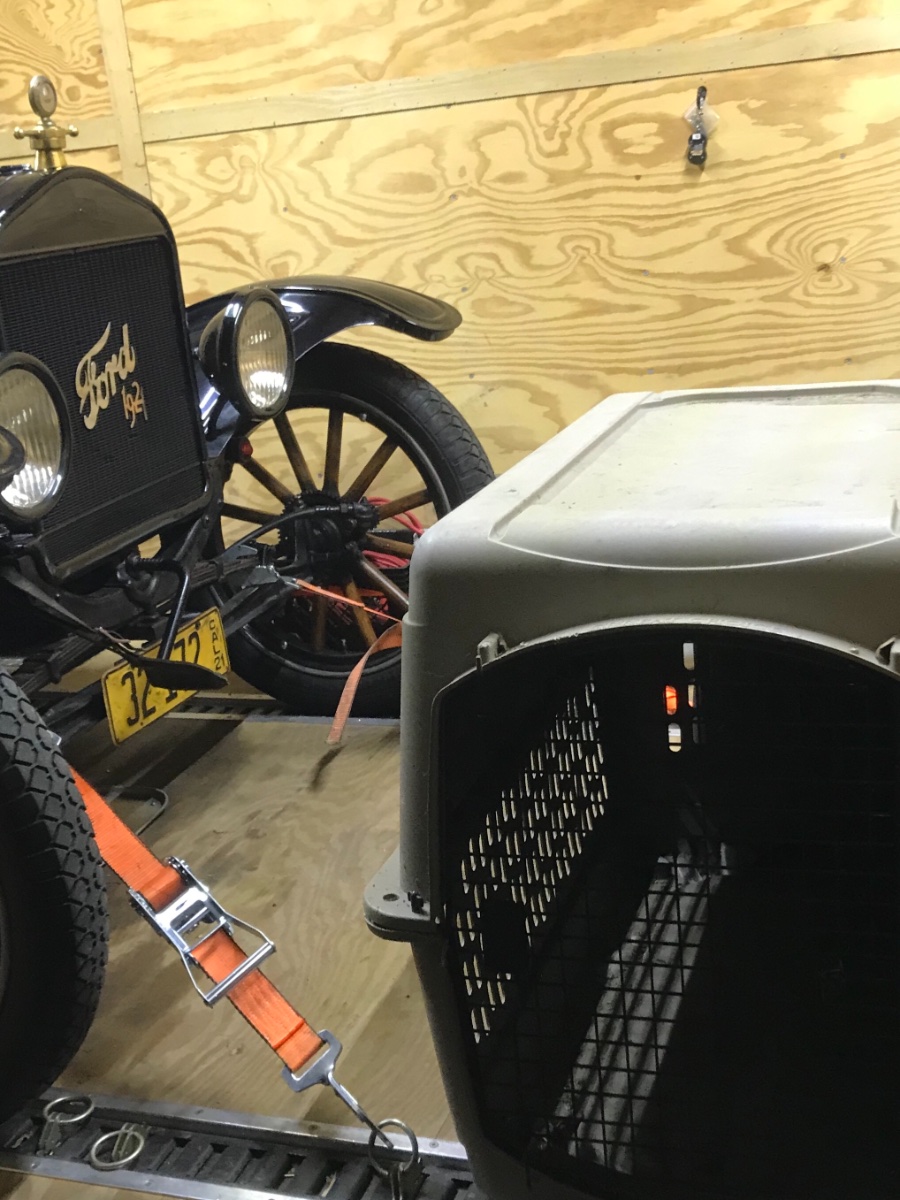

Well.... power just went out at 5pm and mandatory evacuations are in effect 10 miles to the north of us in Windsor and Healdsburg all the way to the coast. My motorhome is loaded, guns loaded, it's gassed up, and one of my most prized possessions, my T is loaded in the trailer. If we are evacuated (which has happened 3 times to me in the past) I grab the dog, cat, oh and then the wife, and we get outta here. Everything else is fully insured.
The cat gets to ride in front of the T...
Watch out Hank... I may just keep driving and get out of this god forsaken Socialist State of Cali.
