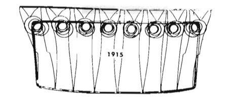

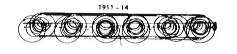

Post by DanTreace » Fri Oct 11, 2019 8:49 am
That single row backrest spring is a 1914 style. Depending on the model year of your T, it could be correct for early '15.
Typical 1915 style is a one-year only design, shown below:
Backrest 1915.jpg (36.09 KiB) Viewed 8419 times
1914 backrest.jpeg (26.85 KiB) Viewed 8419 times

Post by NealW » Fri Oct 11, 2019 9:04 am
Thanks for the picture Dan. My runabout is an early 15 model (based on the engine serial number), so it sounds like the spring could be correct, as mine is a single row with 6 coils like your picture shows. I heard that Ford would use up old stock at times. My foot pedals have the letters on the foot pad, which were serialized out during 1915 also.

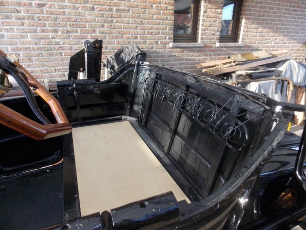

Post by AndreFordT » Fri Oct 11, 2019 9:24 am
This what I found during the rebuild of the drawn 1914 runabout in 2016. The runabout was build in September 1914, may be an early 1915 model.
Good luck
Andre
Belgium
P.S. For the rebuild I had two pair of helping hands

Post by NealW » Fri Oct 11, 2019 12:36 pm
I ended up ordering a 1915 backrest spring from Snyders that looks like the one in Dan's and Andre's pictures. It wasn't that expensive, and I think will result in a more comfortable seat and a better looking installation. The old installation looked pretty bad with the springs that low. I would've needed to add more cotton batting to round it out more, and the springs would still be hitting lower than where they are shown for the 1915 spring.
Thanks for posting pictures Dan and Andre!

Post by KWTownsend » Sat Oct 12, 2019 8:34 pm
Dan,
I'm curious of where the image for the backrest spring for 1911-1914 came from.
I know that type was used in 1914. I have never seen a 1911 with any spring. I would think 1912 was the same as 1911. I have no idea about 1913.
Keith

Post by Scott_Conger » Sun Oct 13, 2019 10:45 am
Keith
there is no spring in the backrest of a '13. Just padding. If you went to grade school and were made to walk with a book on your head, you'll find it to be just fine. If you've spent your life slouched, texting into your phone, you'll be very uncomfortable. :lol:

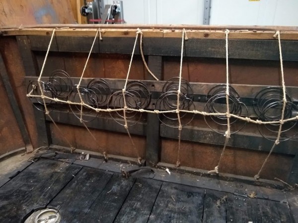

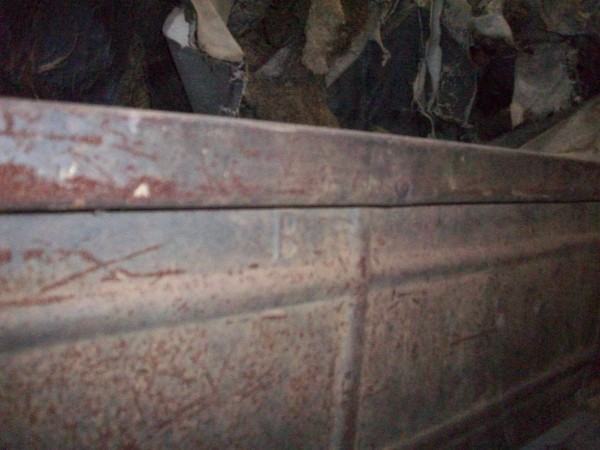

Post by Hap_Tucker » Mon Oct 14, 2019 8:26 pm
I think it may be more involved than just when the car was assembled. In your photo Neal, your seat has the wooden cover over the gas tank. It also appears to me to have a wooden seat frame rather than a metal seat frame. In 1915 Ford USA was purchasing the bodies from out side suppliers. From the single photo you posted, I would guess your body will also have a "B" stamped into the seat riser as shown below:

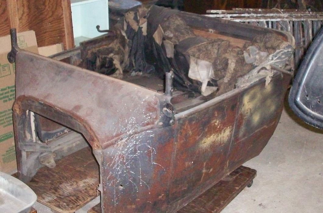

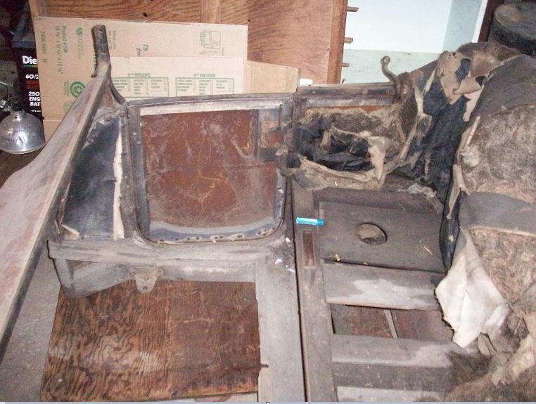

Post by Hap_Tucker » Mon Oct 14, 2019 8:30 pm
That photo and the next one are from my May 1915 "cut off" body that was made by Beaudett (also spelled Beaudette and referred to as Pontiac in most of the Ford USA documents). It came from an unrestored 1915-6 cut off was turned into an express wagon. The windshield brackets were changed out to the later mid-1917 to 1922 but the body is clearly a 1915-16 without the half moon cut out above the coil box etc.

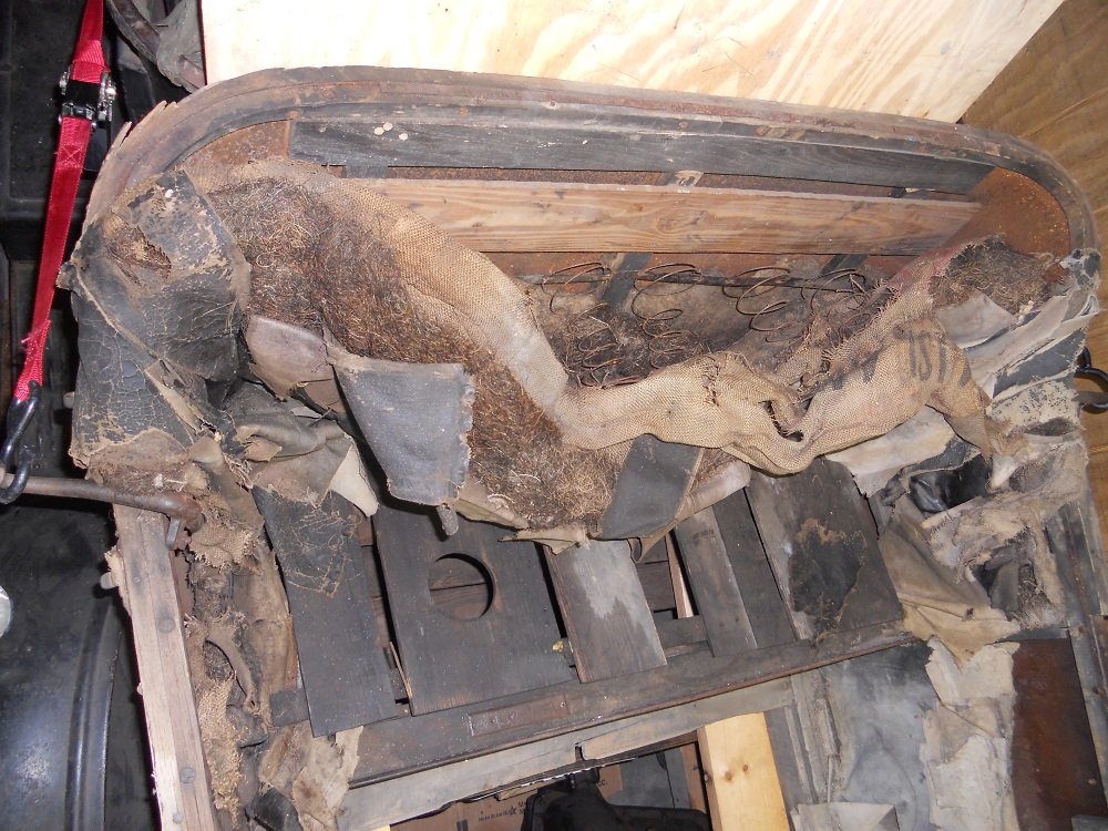

Post by Hap_Tucker » Mon Oct 14, 2019 8:38 pm
That body also had the single row of springs about mid way up the back rest. From the newer looking wood (not painted) I suspect someone added that piece -- but the rest looks original to me.

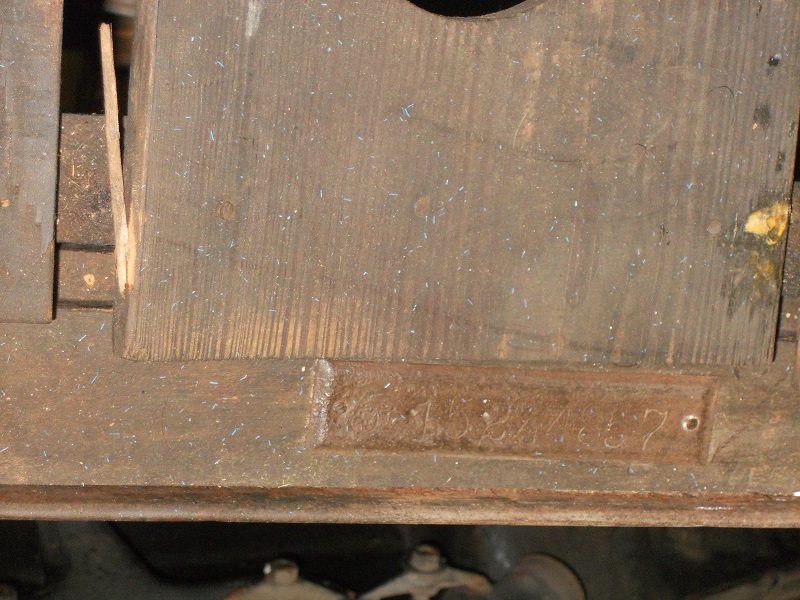

Post by Hap_Tucker » Mon Oct 14, 2019 8:41 pm
The body tag shows 5 15 224857 and is easier to read when you can change the angle you look at it.

The cut off body that is on my 1915 has the metal seat frame and metal gas tank lid. It appears to use a different spring for the back rest. Both of those cut offs are the front section of a touring. The second one I still have not figured out which of the 5 or so 1915 body makers produced it.
But please let me know if your car does or does not have a "B" stamped on the front seat heel panel (where if you are sitting in the car the heel of your foot could hit that panel if you kicked backwards.)

Post by NealW » Mon Oct 14, 2019 9:10 pm
Hap,
My runabout body has the Beaudette "B" stamped on it. The seat back spring may have been original, but it was attached to a board that was then screwed to the original body wood. This appears to have been done when the car was first restored many many years ago. I installed a new 1915 seat back spring from Snyder's that showed up today. It looks much better, and will provide much better shaping and support than the old one did.

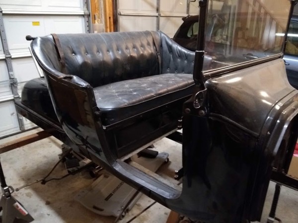

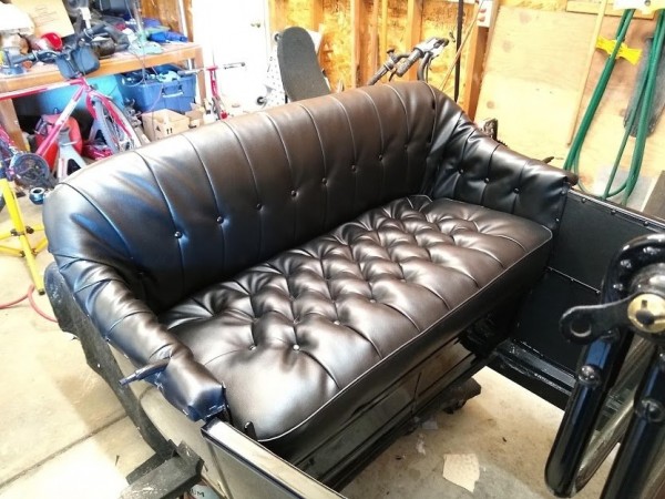

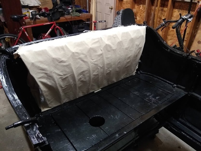

Post by NealW » Sun Oct 27, 2019 5:32 pm
I finished installing the upholstery back this weekend. I am so glad that I replaced the old 1914 era seat back spring with a new 1915 seat back spring from Snyder's. I think the final result looks so much better than the old installation. Certainly more comfortable. I think whoever restored this car 50/60 years ago probably got the old seat back springs installed too low.
Now on to the top installation! I'll put the welt strip around the outside of the seat back upholstery at that time.

Post by Wayne Sheldon » Sun Oct 27, 2019 9:53 pm
Nice!

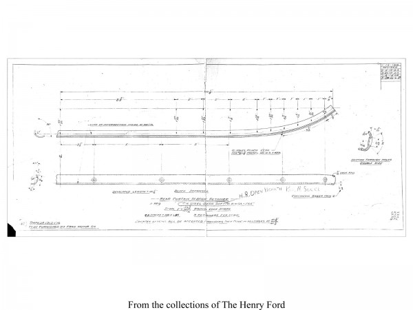

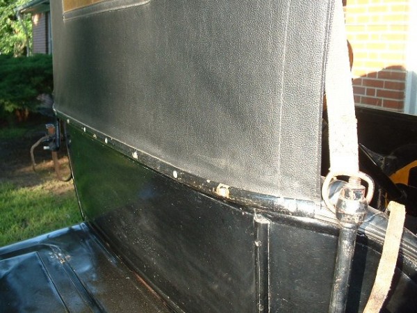

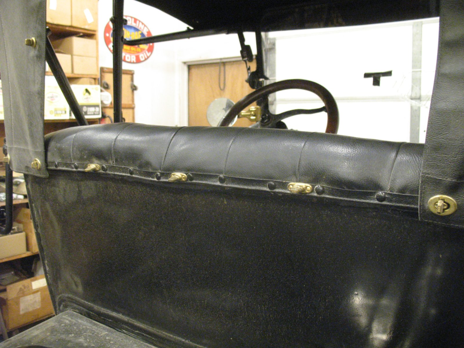

Post by KWTownsend » Mon Oct 28, 2019 1:54 am
Neal-
It is looking good. Is the end roll of upholstery leather?
The back of the rear curtain is trimmed with a metal edge piece, not welt strip.
Keith

Post by NealW » Mon Oct 28, 2019 7:02 am
Thanks for answering my next question Keith! My runabout has that metal retaining strip, but the previous restorer sandwiched it between the upholstery back and top. I was wondering if it actually mounted like you showed in the picture that you posted.

Post by Scott_Conger » Mon Oct 28, 2019 10:45 am
You're lucky to still have that. Many if not most have gone missing over the years. Mine required reshaping in a press and some by hand, to get it to fit nicely.

Post by NealW » Mon Oct 28, 2019 12:44 pm
I had also emailed Mike at Classtique's, and he confirmed that the metal strip goes on the outside. I had sent him a picture how mine was installed when I took it apart, and he said that he'd never seen it installed that way.
