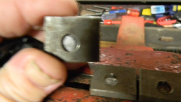

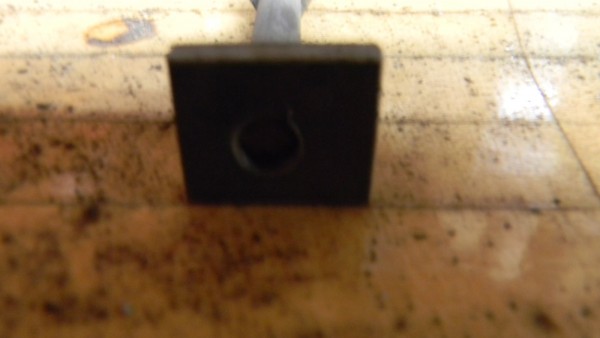

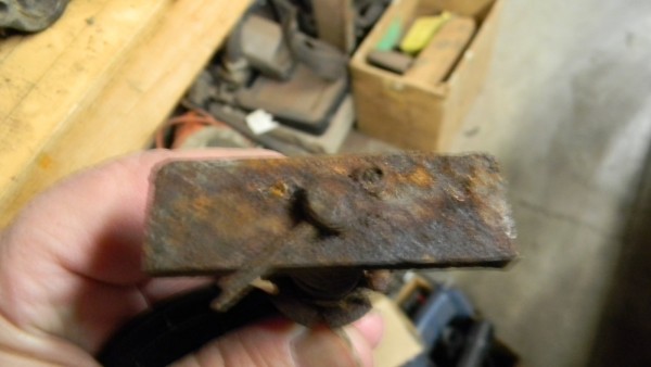

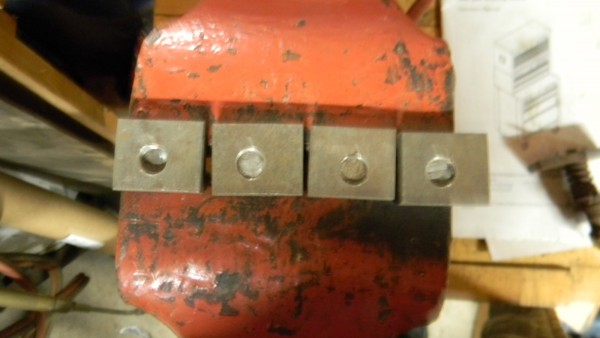

Looking at originals they are all over the map
1" x 7/8" on most but the holes are all over the map, none are centered and they all vary about .0020-.0085
the later style measures 2 5/16" x 3/4" with centered hole, I might have to get the prints but not a crucial part.
I will look for a few more, if anyone has some please let me know your measurements, Bob

Bob, make them all long ones. Those who must have the short versions and the grief they can give, can always cut them down to suit. They probably should not be plated either. Then, to be absolutely original, they should be sheared rather than sawn to length!
I too, have found some with the hole drilled off centre in relation to the width. This can be helpful when trying to clear the fender iron mounting bolt heads. I doubt it was done intentionally, as the hurly-burly of the production line may well have been to rapid for the fitters to mount them in a particular orientation.

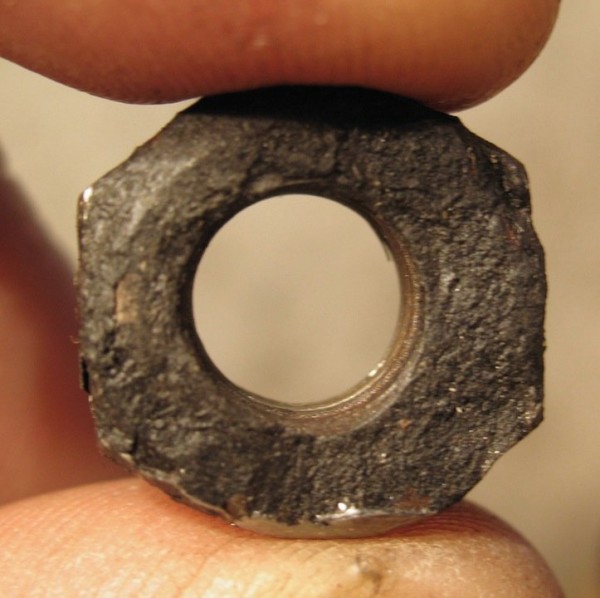

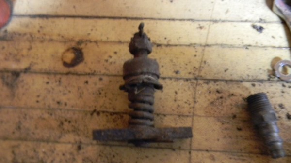

It's not just radiator nuts with the holes off center.
A lot of coil box terminal nuts are cockeyed too, some of them even more than this one.
