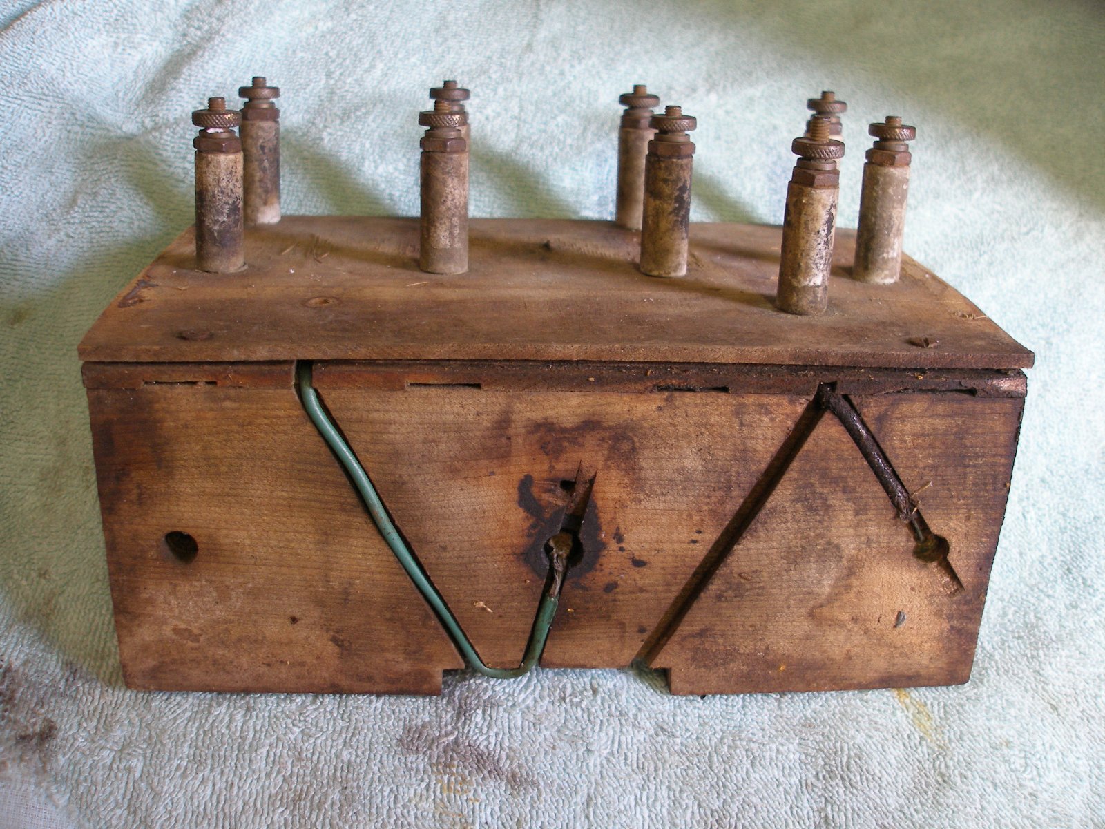

- Posts: 4641
Re: MAGNETO TROUBLESHOOTING
Don’t know if you’ve rebuilt the coil box but an intermittent can certainly occur because of an original coil box. Age catches up to coil boxes as with other original electrical components.
When restoring a T the coil box is the first thing to rebuild in the electrical system.

Thank you John. Your suggestion is good but if the coil box is the problem wouldn't it not run when on battery as well?
- Posts: 7403
...if the coil box is the problem wouldn't it not run when on battery as well?
Correct. On your 1923 the coil box has only one input. It takes current from both the battery and the magneto. That makes the switch a leading suspect. I would first determine whether there's normal output at the mag post. If there is, then the problem has to be somewhere in the path from the mag post to the coil box. That would be in the switch or one of the connections. A problem I once found there was a cracked terminal block that kept one of the screws from making a tight connection.
