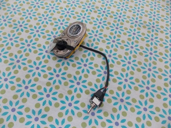

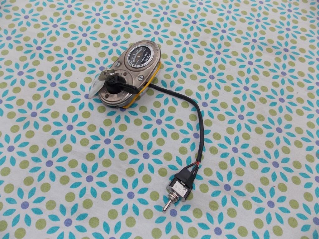

Think may have an ignition switch problem causing my mag problem. If I have the switch out of the system , is there a ez test to see if this is my problem. Truck runs pretty good on battery. Thanks for any help/ Eck

If you're suspecting an intermittent problem in your switch, it's pretty easy to wire up a 3 position toggle switch on your steering column and run it that way for a while to see if the issue disappears. The switch would be termed " On-Off-On". The center lug gets wired to the coil box, and each outer lug would go one to the mag post and the other to a battery source.

Here is what I did in the past.
For me, there was a short in the switch. During a ride, when I canged from battery to magneto, there was DC current connected to the magneto and the magnets discharged.
At the last I run the car with only with the three way switch and that for a few years now. I disconnected the wires for the ignition from the original switch and connected it all to the three way switch. no problem since than.
Good luck
