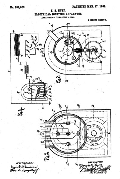

I don't think ignition systems were in Henry Ford's skill set
IMO, just the opposite. Henry first gas engine, the kitchen sink one, began his knowledge of igniting gas engines, he made lots of contributions, the most famous in directing Huff to perfect his idea of a low tension magneto that would need no owner maintenance. High tension magnetos of the day used outside power to drive, needed points cleaned and regular care and oiling, could succumb to moisture and dirt.
So his direction made the Model T ignition superior of the day, no service issues, 4 individual coils too, if one went south you came home on three cylinders, not onboard old Dobbin
Huff worked for Henry, used Henry’s direction, added his own efforts, and Ford secured a patent, with Ed Huff as novel inventor, for a magneto to be contained within Ford’s engine, with the patent gained by Henry and then assigned to Henry.
This contribution by them put the simple reliable ignition system in the Model T, 15 million of them, and unknown thousands of these Fords are still on Ford/Huff system! Like today’s Coil -on -Plug technology, 1908 style.

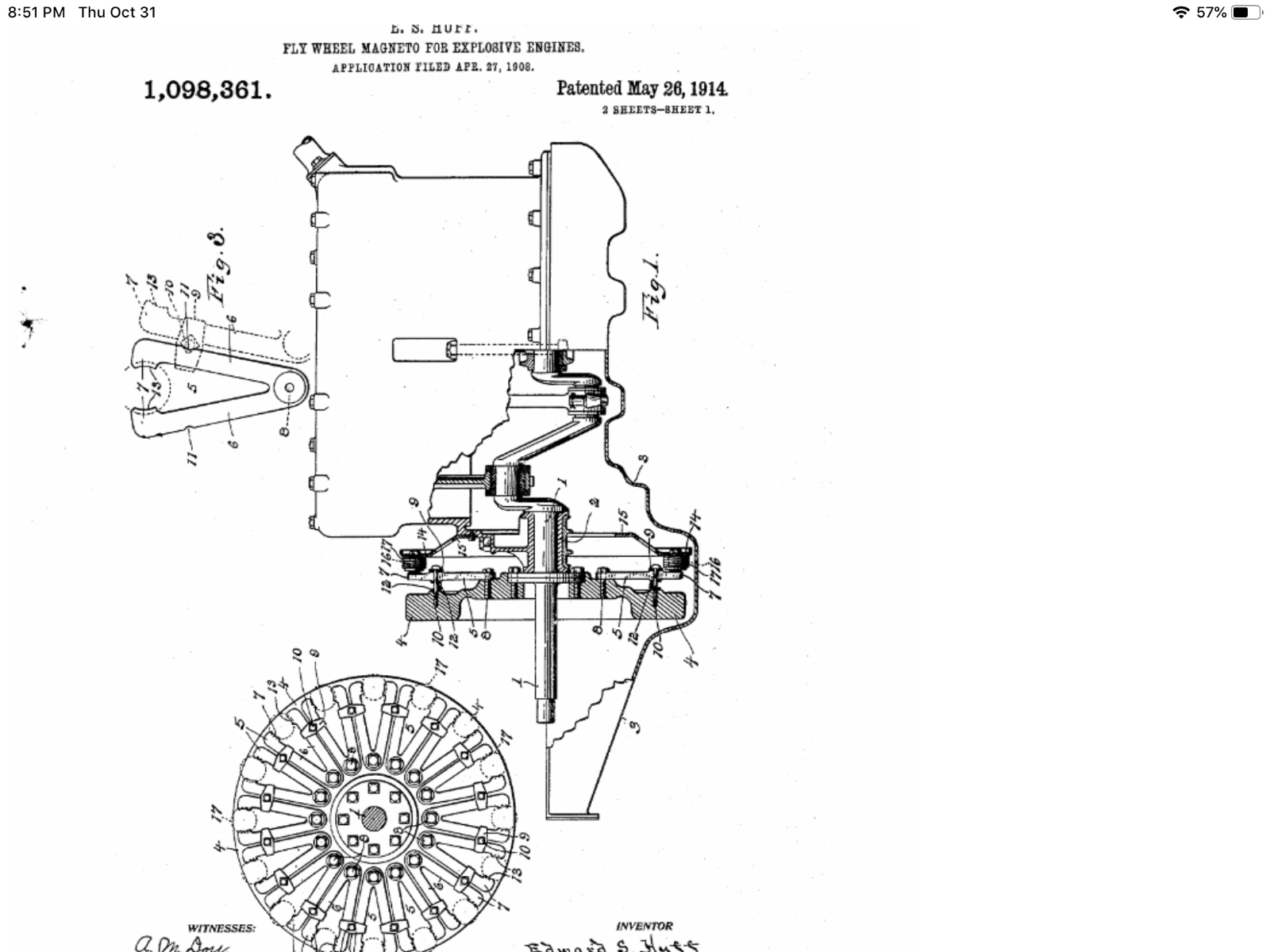

But he did recognize a rugged and reliable design, the trembler coil being one, which he had little interest in modifying over the production span of the Model T. But in all fairness, the high-tension magneto had been used in production cars since 1899, and by 1919, nearly every car on the market was driven by magneto ignition. By the time the Model T went into mass production in 1913, a magneto still cost around $140, which was completely out of range for the Model T.
If Ford had wanted, he could have modernized the ignition system to the high-tension magneto type when he added an electric starter, a generator and a storage battery in 1919, as he could have lowered his costs by manufacturing his own magnetos and simplified the electrical system by elimination of the low-tension flywheel magneto and the four trembler coils. This again, suggests Henry Ford's unwillingness to get involved with ignition systems.
