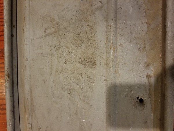

Hello fellow Model T-ers,
I have two questions for you today.
1). Is this an original Model T tailgate?
2). What would be a fair price to pay for this particular tailgate?
Thank you in advance for your comments.
-Steven

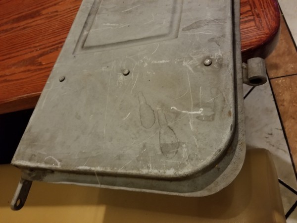

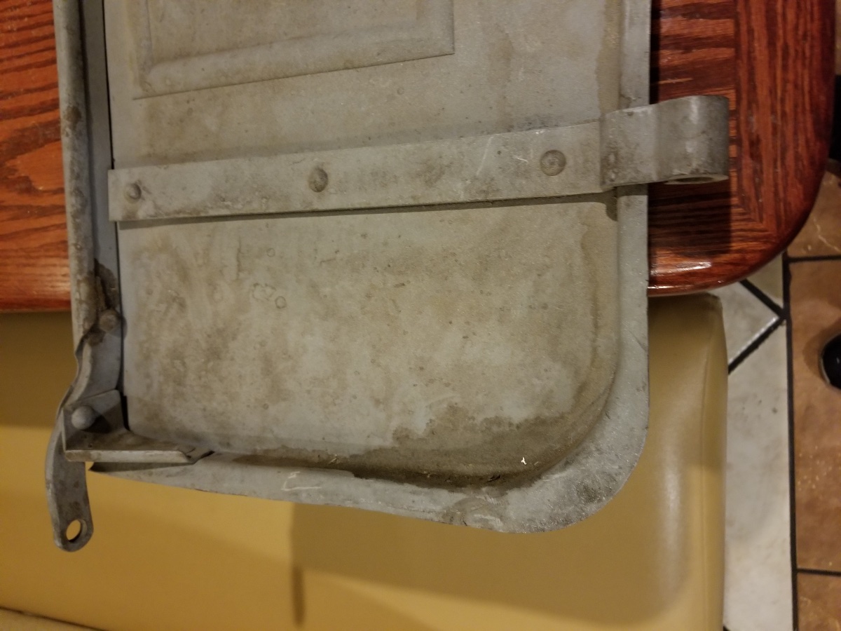

Same tailgate.

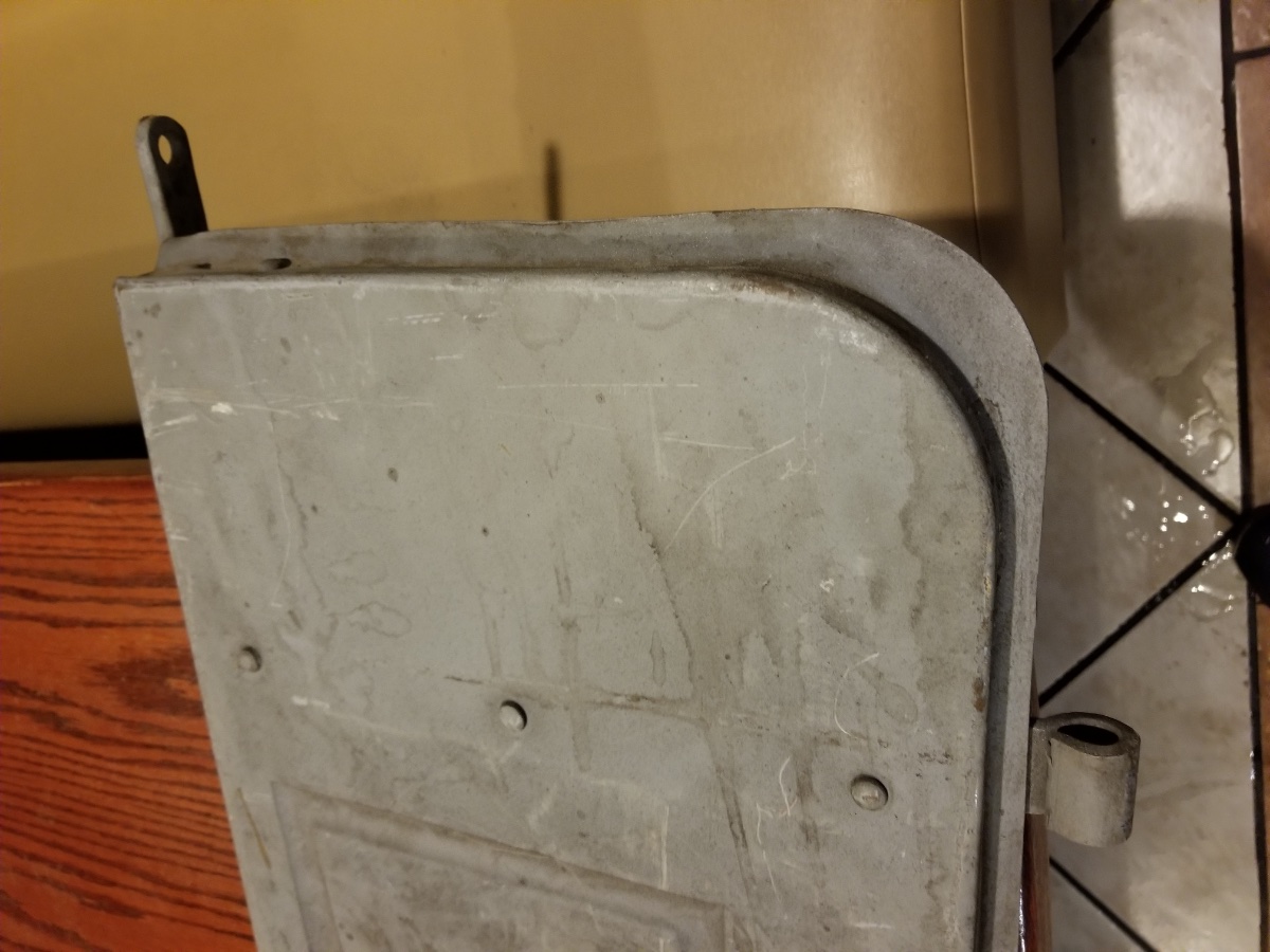

Appears to be & pretty nice condition for other than the bullet hole and the 2 other small holes - perhaps reflectors.
Value is whatever you can get for it but IMO $100 - $150.

Depending upon the size it could also be model A gate but that would be a good question for the A guys also. The straps/hinges for those would be different. Just a thought.

Model A tailgate is the same as the T.

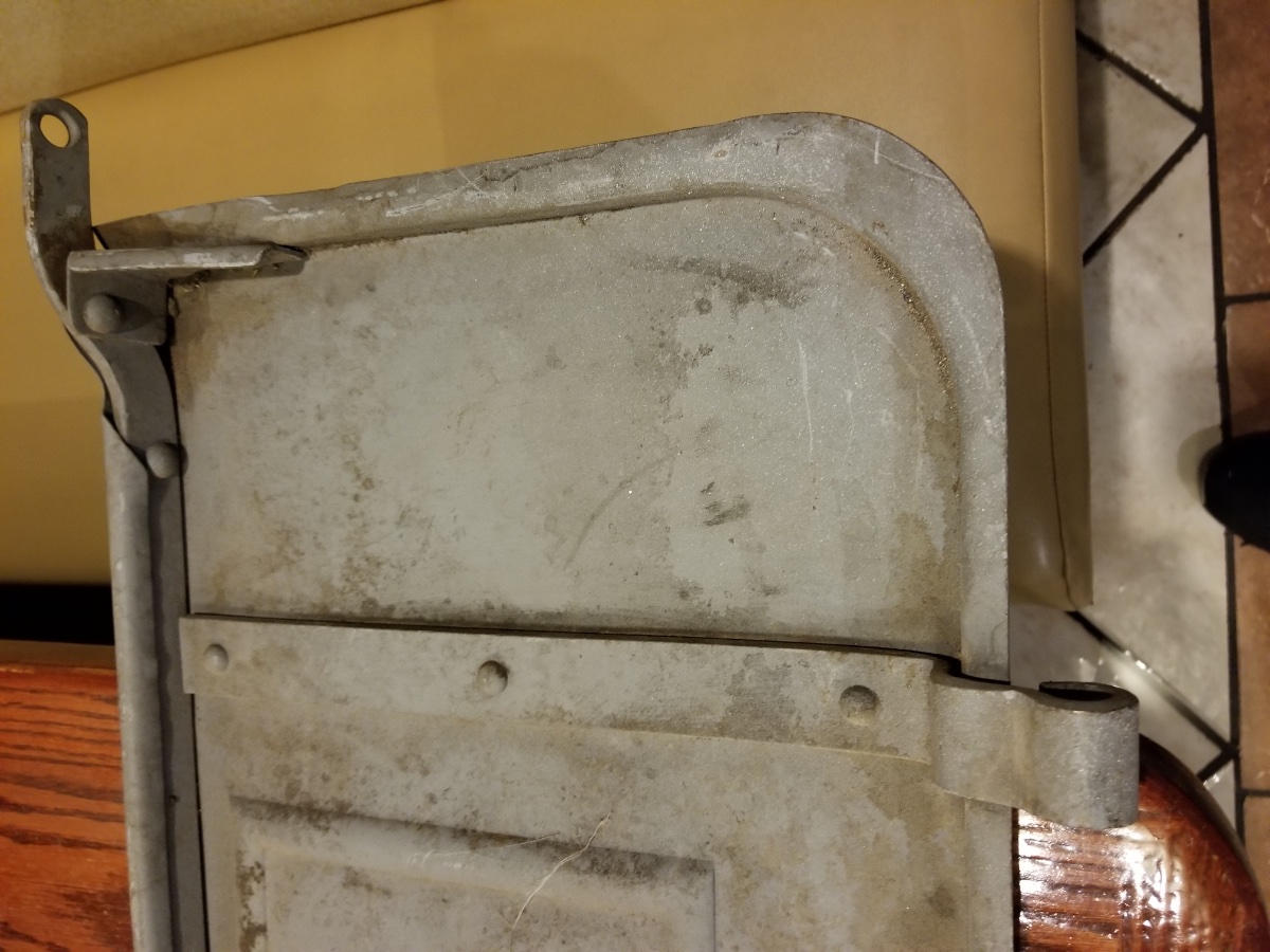

Steve has value about right IMO.
That is a T tailgate. The A tailgate will fit a T bed, but the A tailgate has folded over double at the bottom hinge strap, because the single T strap is weak at that lower spot.

Measurements of this tailgate.

Another

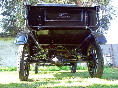

The tailgate is definitely a T tailgate. This style was also used on the first 1928 A pickups too. They found the hinge was weak, and they are, so they modified that hinge for the A's, but they will still fit a T. You mentioned in a phone call that there is a slight convex problem with that tailgate which could probably be corrected on a press if only slight, but if not, would require heat, shrinking the metal back to it's original form. I own an authentic 1925 pickup, and spend countless hours painting and sanding my tailgate. It still isn't 100%, but it's as good as I could get it.
