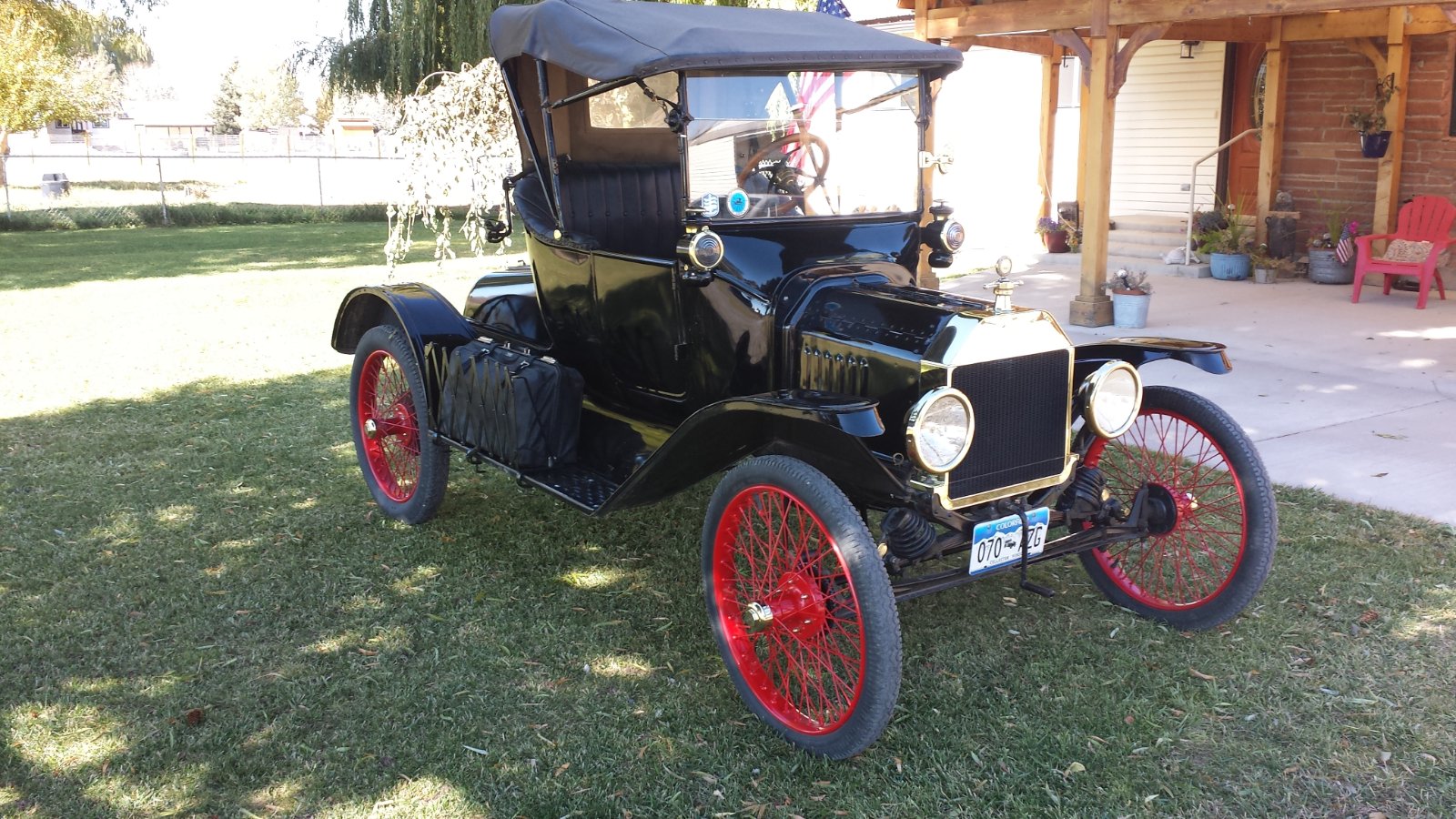

Nice looking Runabout too !

Michael
that is a very nice looking car
