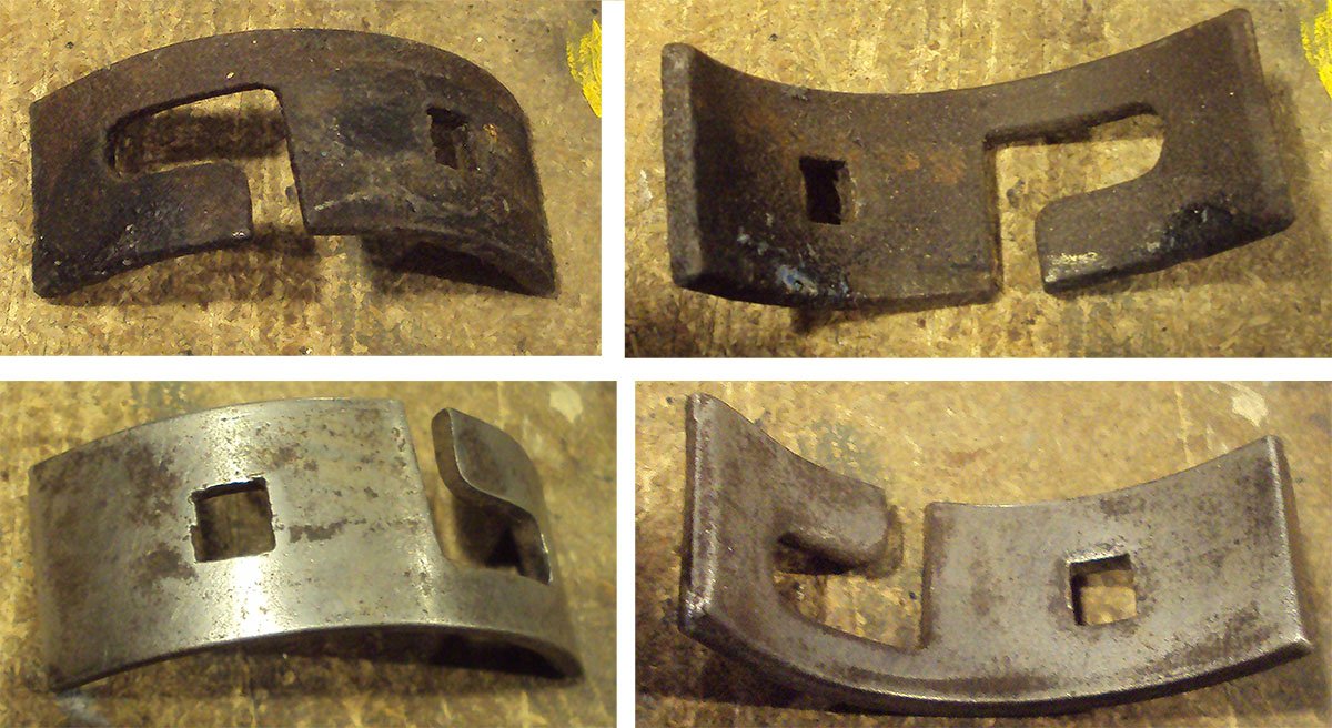

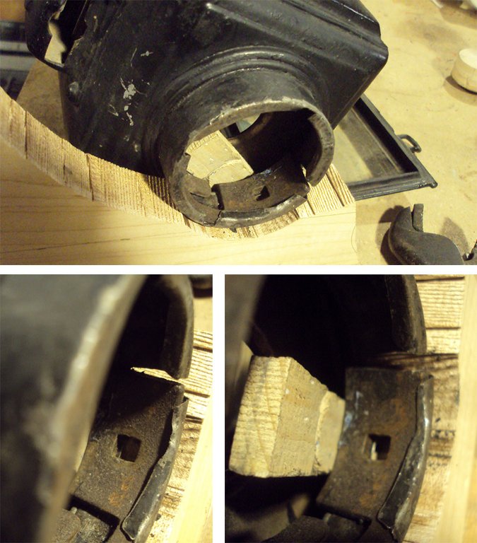

I wanted to reassemble this one that had the font forcibly removed without lining the 4 tabs up. The hole was no longer round. I cut some maple to fit the curve of the base for the font. Then by using the curved latch plate as a form I could hammer the lip back into shape.

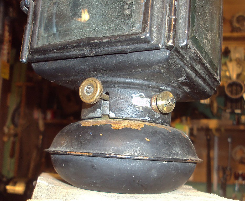

These junk lamps don't work smoothly like new or restored lamps. If we aren't familiar with them and careful much damage can be done. A hundred years of dried kerosene, rust and paint had made it difficult to release. Some cleaning made all the difference.
To get the knurled nut off was difficult too. It's screw had been staked with a punch or chisel after assembly as was the practice. Filing the threads helped some. A #12-24 tap and die are good to use if you have one before reassembling.
