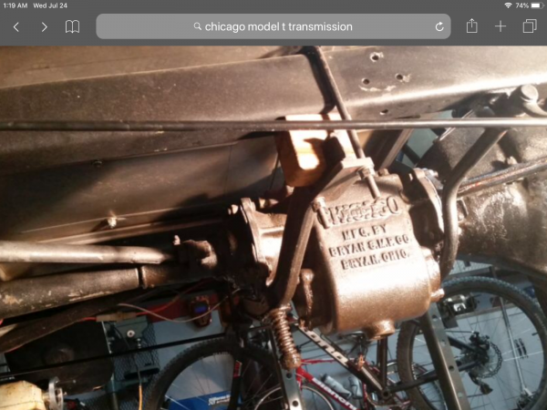

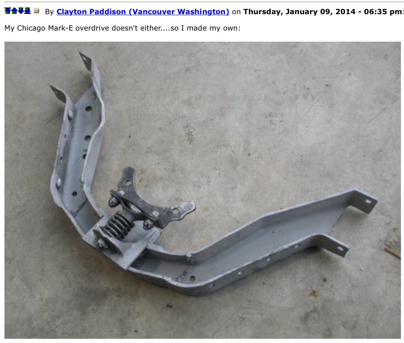

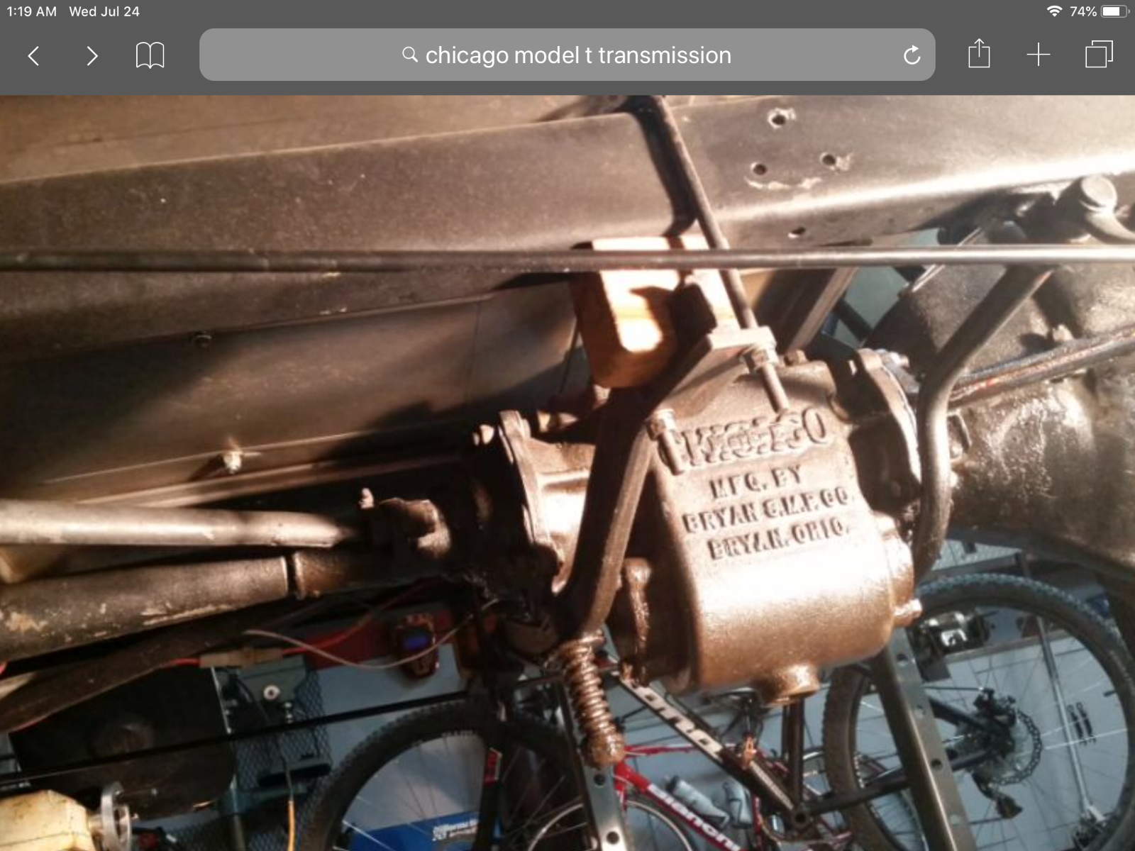

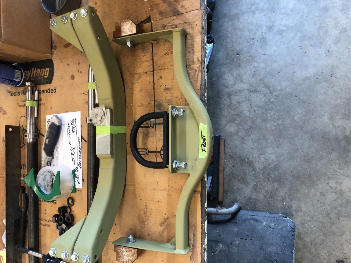

Here are a couple ideas if you are a do-it-yourselfer. These are for the Chicago but same idea.

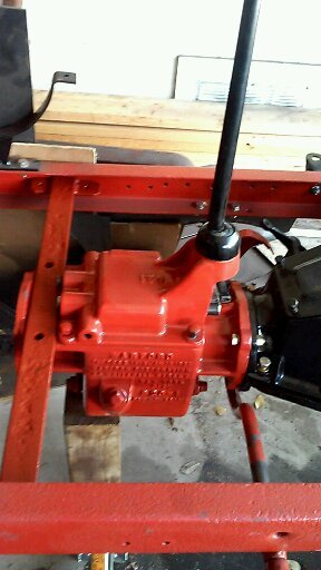

I made my own using a front frame cross member, to fit my KC Warford. It is spring loaded too, and that spring is adjustable to vary the the support offered. By spring loading the mounting/support, wracking in the frame can still go on with no detrimental effect.

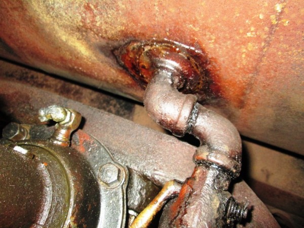

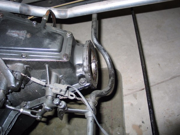

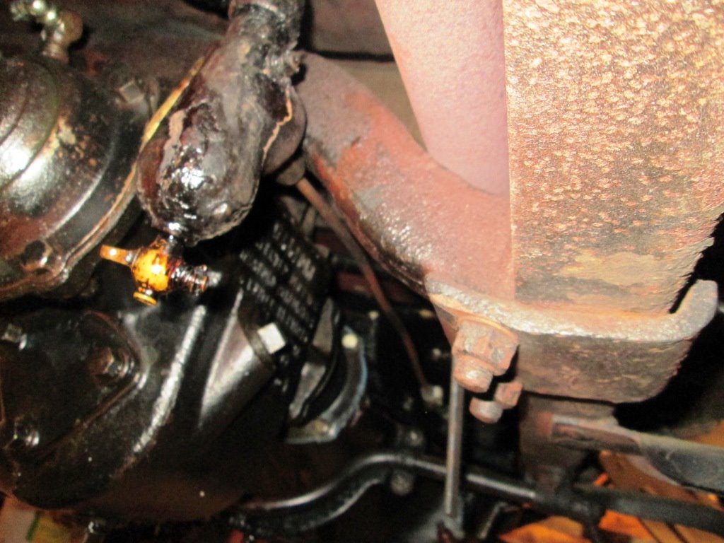

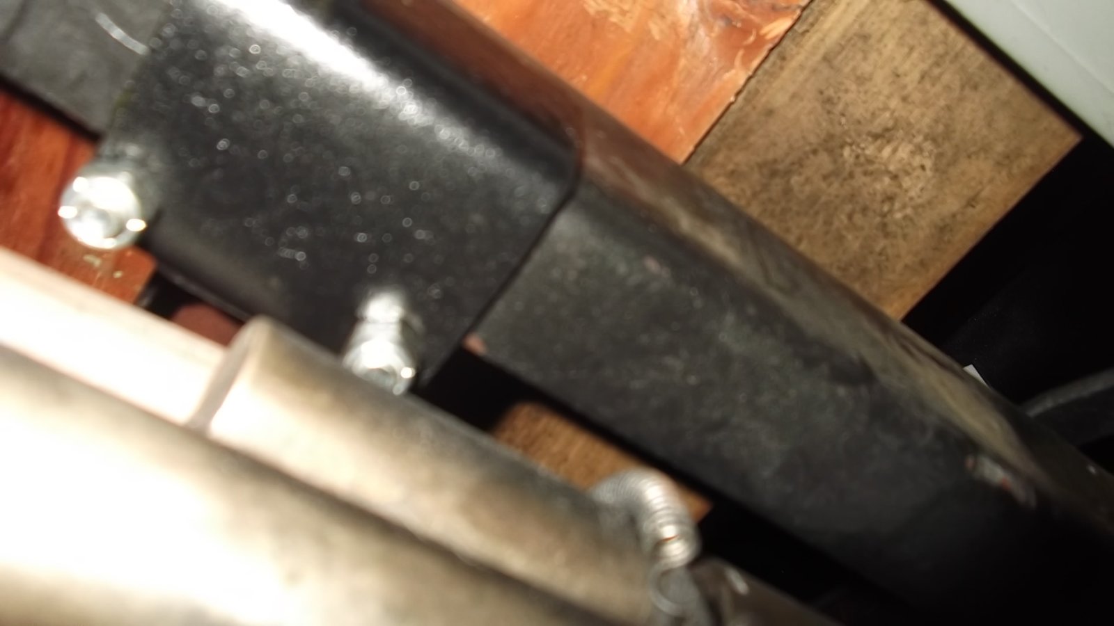

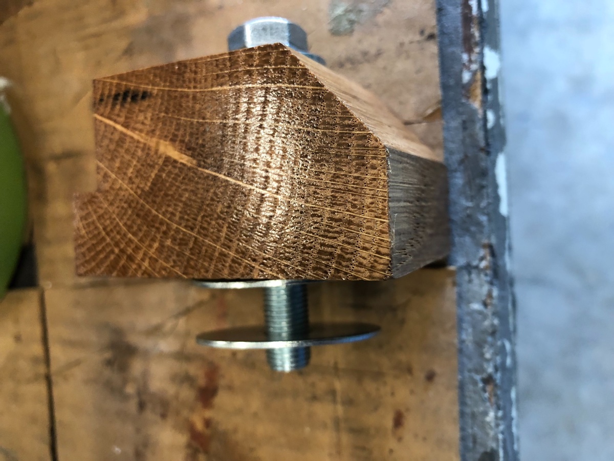

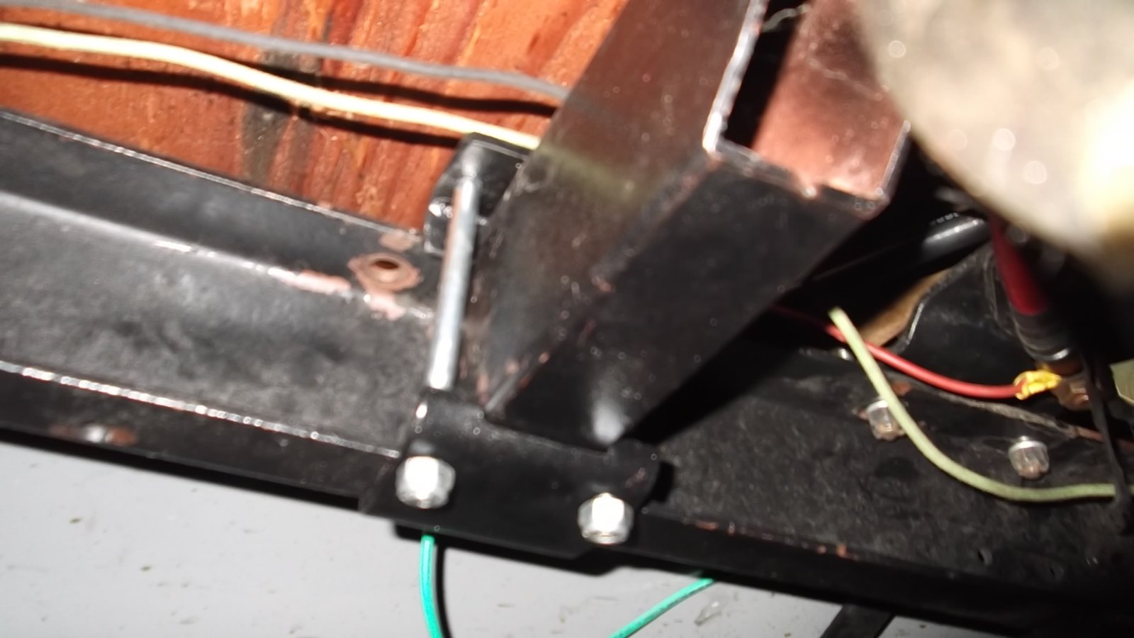

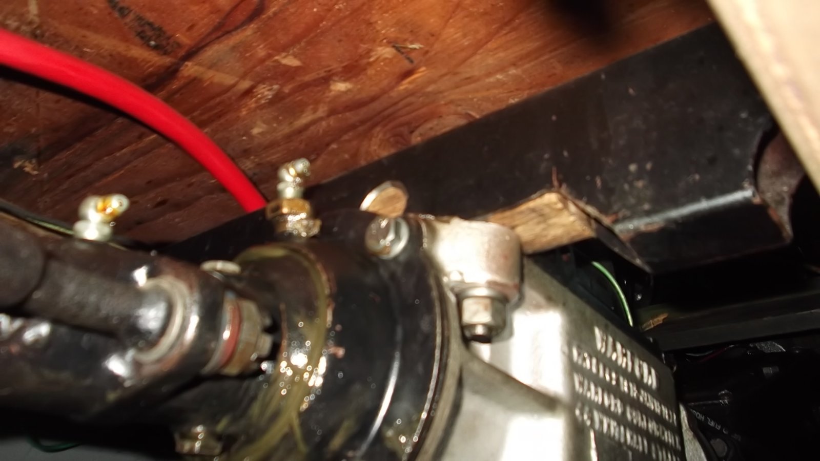

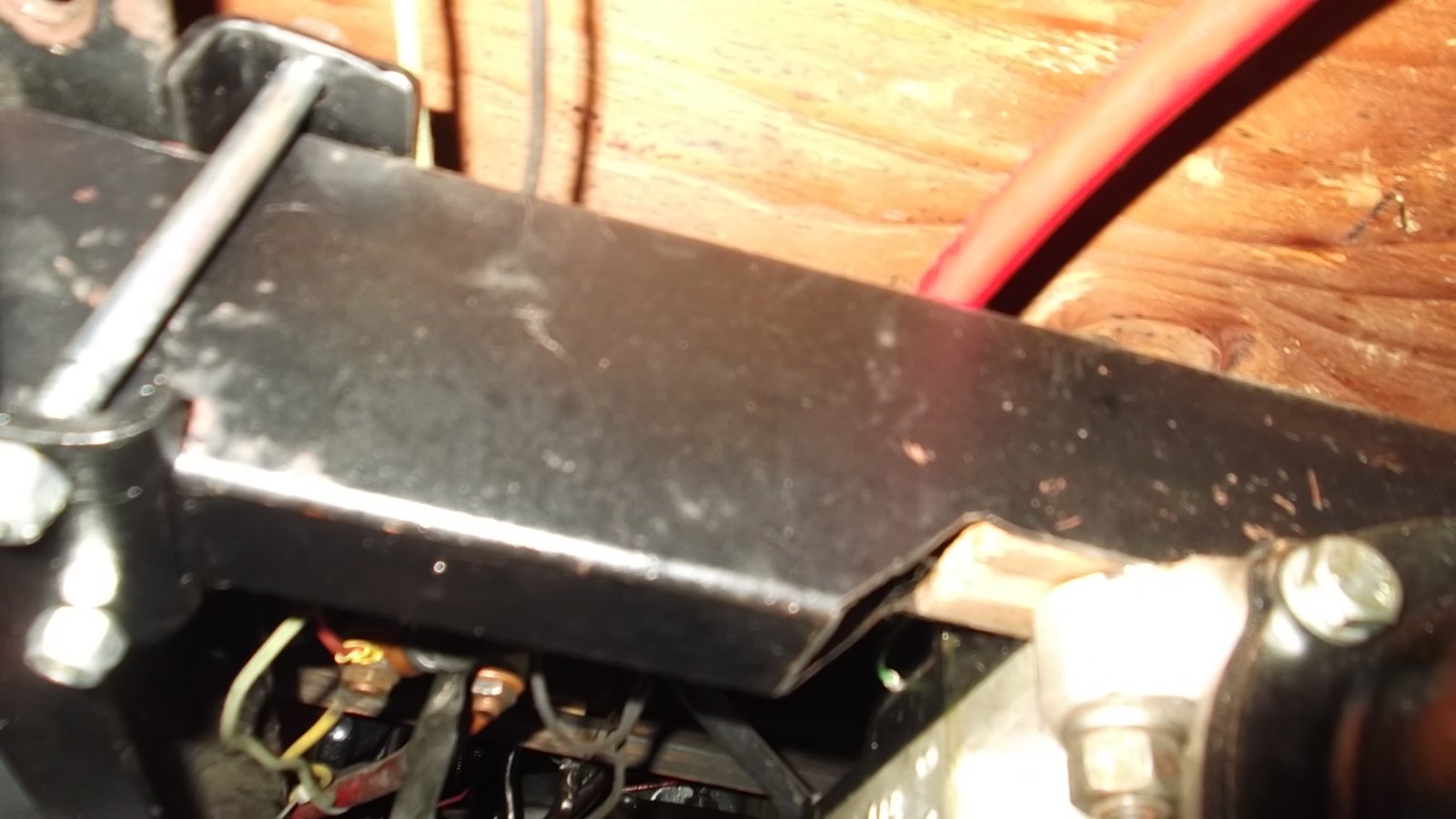

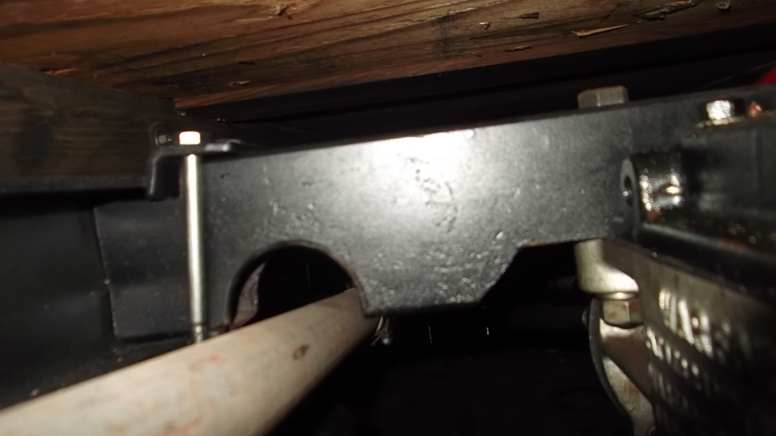

Some quick photos of how I mounted my cast iron Warford. It was painted silver when I got it so repainted same color.
From the front, notched for exhaust pipe. I notched the cross bar and used wood filler in it to add strength and fill the void, this way the metal cross channel is not rubbing top of case. Shots of L brackets at the ends You will note the hole just above the Warford case. I at first got it backwards and had to redrill from the other side. There needs to be a place for the shift rail to go into in the cross channel for one of the two. The original Warford support had this.
I am going to ask a real to the point question, is it a cast iron 3 speed Warford or are you using Warford as a general term? Kinda like some people calling ALL outside brakes Rocky Mountain.

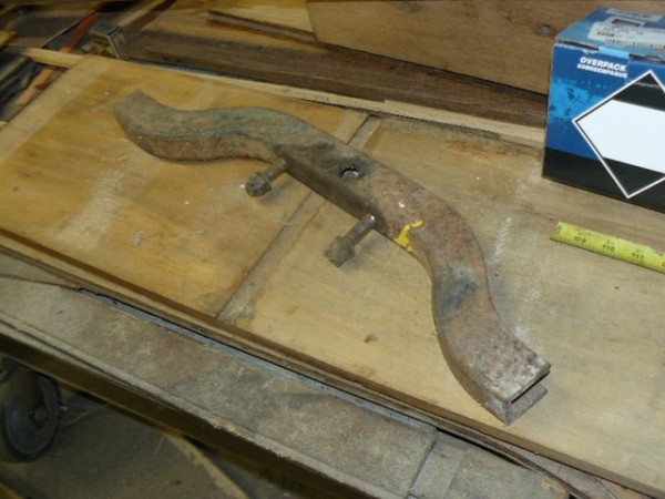

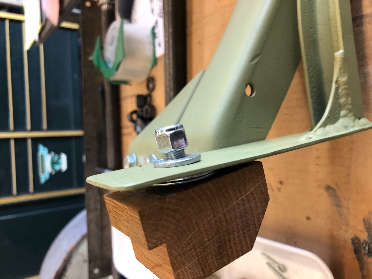

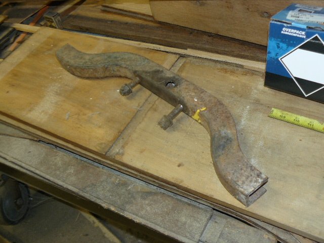

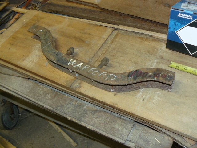

Harold another simple method is using a pressed steel running board iron. This one is for a 37-38 Chevy transmission mod but you can see quite simple. Installs in the inside frame channel and uses the same wooden blocks as the rear oil pan.
Hope this Helps,
Hank
Hope this Helps,
Hank

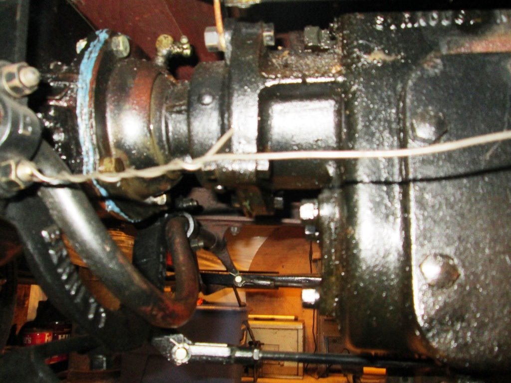

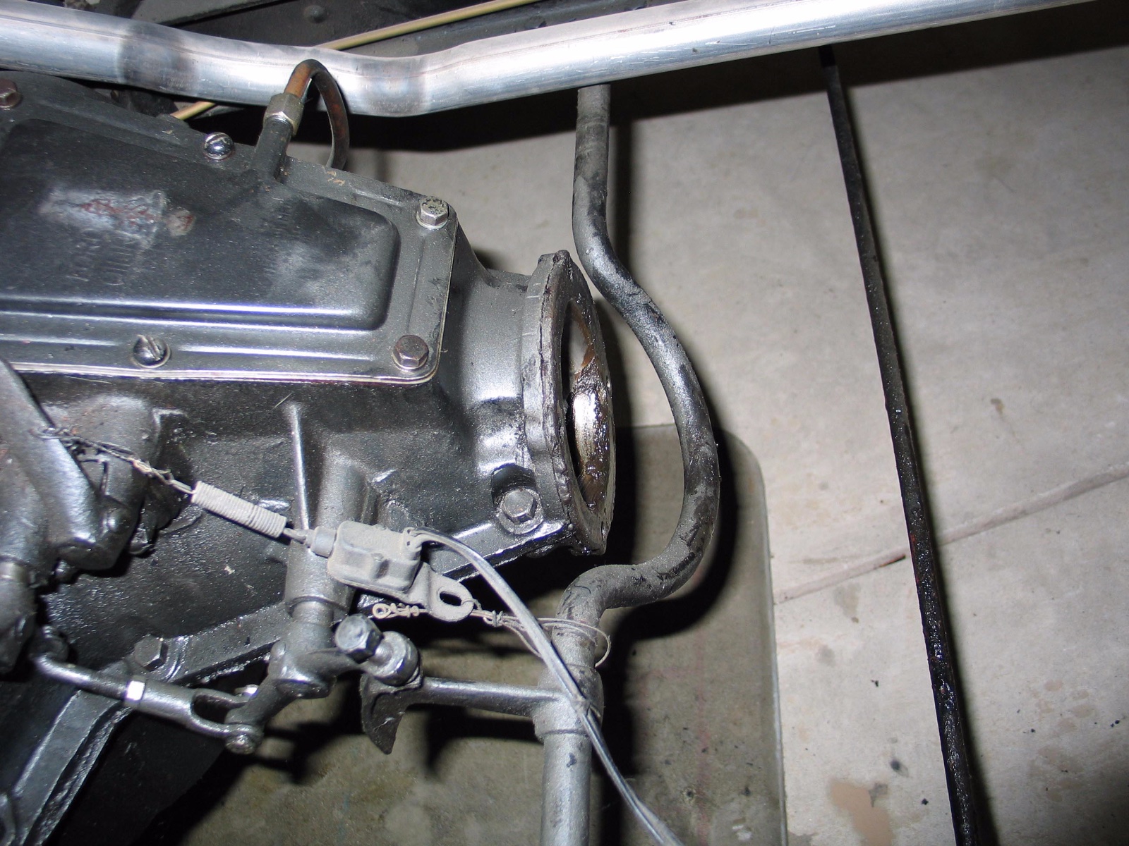

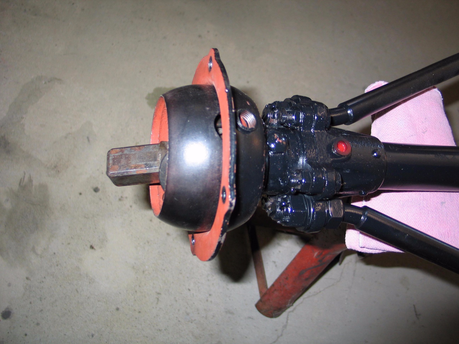

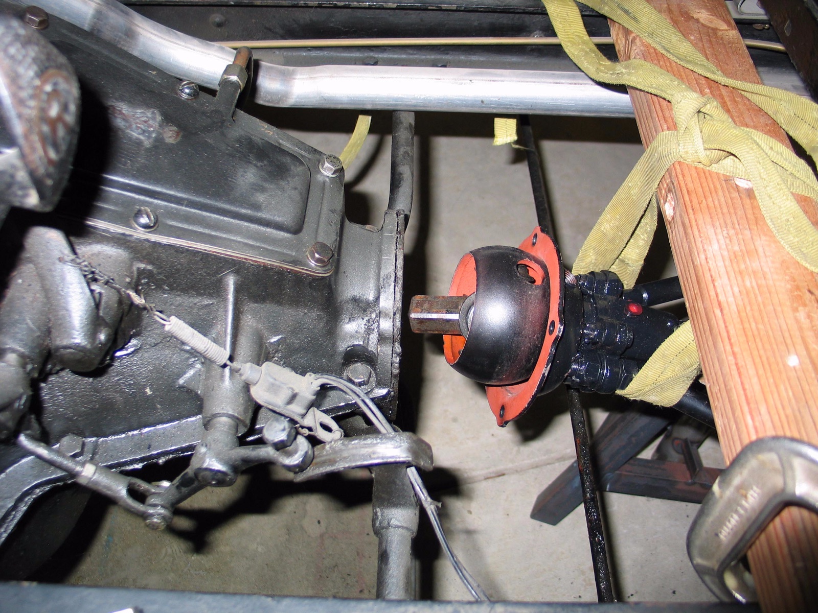

I know it's tough to visualize. Here are some photos that might help.
Top picture is the back of the T transmission; no Warford or driveshaft installed. Sorry I didn't have the foresight to take a pic looking straight at the back, but there is a square receptacle there to receive the front of the U-joint.
Second pic shows the front of a T U-joint. That's the square peg that will go into the back of the trans. And it's the same square peg that is slightly too small on the front of a Warford.
Last pic shows the T U-joint ready to slide into the back of the T transmission. That gap (a little larger gap) is where the Warford would be installed.
There is supposed to be an intermediate housing installed between the front of the Warford and the back of the T transmission. That housing contains a second U-joint. IT REALLY NEEDS TO BE THERE.
As Mark said, the output drive at the back of a T transmission is a square receptacle. The stock T U-joint has a square peg that fits snugly into the hole in the T trans. The Warford (at least on original iron Warfords; I can't swear to the others) has a square peg that looks just like the front of a Ford U-joint. The problem is, the Warford peg is slightly smaller (maybe 1/32" smaller) than what would be on a T U-joint. The Warford peg will slip right into the T transmission, slick as can be. And the car will work just fine. For a while, that is. But eventually the too-small peg will waller out the hole in the transmission and you will lose your connection between transmission and rear wheels.
When the connection fails, you will lose not only low, high, and reverse, but also your brakes. And then you become a cannon ball rolling down hill. I'm not certain if this was failure mode that killed Walt Rosenthal, but the effect was the same. Poor Walt wound up laying on somebody's front lawn, thoroughly dead.
The faulty configuration that I found when I removed my Warford was exactly as described. My Dad had installed the Warford in the late 1970's. After I inherited the car in 1983, Mom commented that he had intended to take the Warford back out. When I asked her why, all she knew was that he had said it wasn't safe. My ears perked up then, but it wasn't until several years later that I heard someone explain exactly what the problem was.

Can anyone post pictures of an original bracket for a cast iron Warford? Maybe some of one installed? I've got some time to work on this, and it sounds like a good project. I just don't have a cast iron case Warford or bracket. Are there different bracket styles? Are there different case styles? The ones I make for the KC are designed to support from the bottom, with a cushion, and there is a small bracket that gets bolted to the aluminum case. I don't know if there are similar holes on the cast iron one.
What obstructions do I need to think about? I see the reference to the exhaust pipe, I'm not sure if there are other concerns.
- Posts: 5599
Re: Warford Support Bracket ?
I have an original TT cast iron 3 speed in my Gramps' truck - I'll get some photos - without climbing under to verify, one of the running board cross braces was cut & the original sediment bulb has to be moved with a "swing joint" 1/2" pipe connection.

here is the bkt i have forsale.i took it off a cast iron warford.charley

Here's a few photos from under the truck - 1st is the cast iron "extension" that holds an additional u-joint, 2nd is the bracket & special frame clamp & 3rd is the plumber's swing joint.
Charlie - do you have the clamps ?

NO, BUT LOOKS EASY TO MAKE FROM THE PCS.CHARLEY

Great pictures Steve! And from that first picture, I can now visualize what Mark G. was talking about in his post above when he said that without even seeing it, he would bet that my car does NOT have the little cast extension and 2nd U-joint/coupling between planetary and Warford!
Because the Warford in my '26 Touring does not have any kind of support bracket, or cross brace, or whatever you want to call it, as Mark G. said, the Warford absolutely HAS TO BE bolted solid to the rear of the planetary (which is wrong) or it would be unsupported and hanging down at an angle which would be ridiculous! I guess that means that there will be a HUGE amount of work involved to install my Warford properly! Not only will the rear end have to come out in order for that little extension and the 2nd U-joint/coupling to be installed between planetary & Warford, but the drive shaft and drive shaft housing will have to be further shortened the same amount as the length of the added cast iron extension housing which will contain the added U-joint/coupling!
Sheesh! ....I guess if I'd known about all this, I probably wouldn't have even bought that car! Frankly, I guess the easiest and most inexpensive solution would be to just get rid of the Warford and replace the driveshaft and housing with standard stock length components, huh? Oh well,..."live & learn" I guess, huh?
Thank you Steve and Mark and all others that responded to this thread I started, because altho' I don't like the "bad news" I have now found out about, I sure have learned a lot,.....harold
