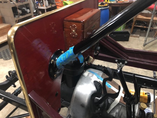

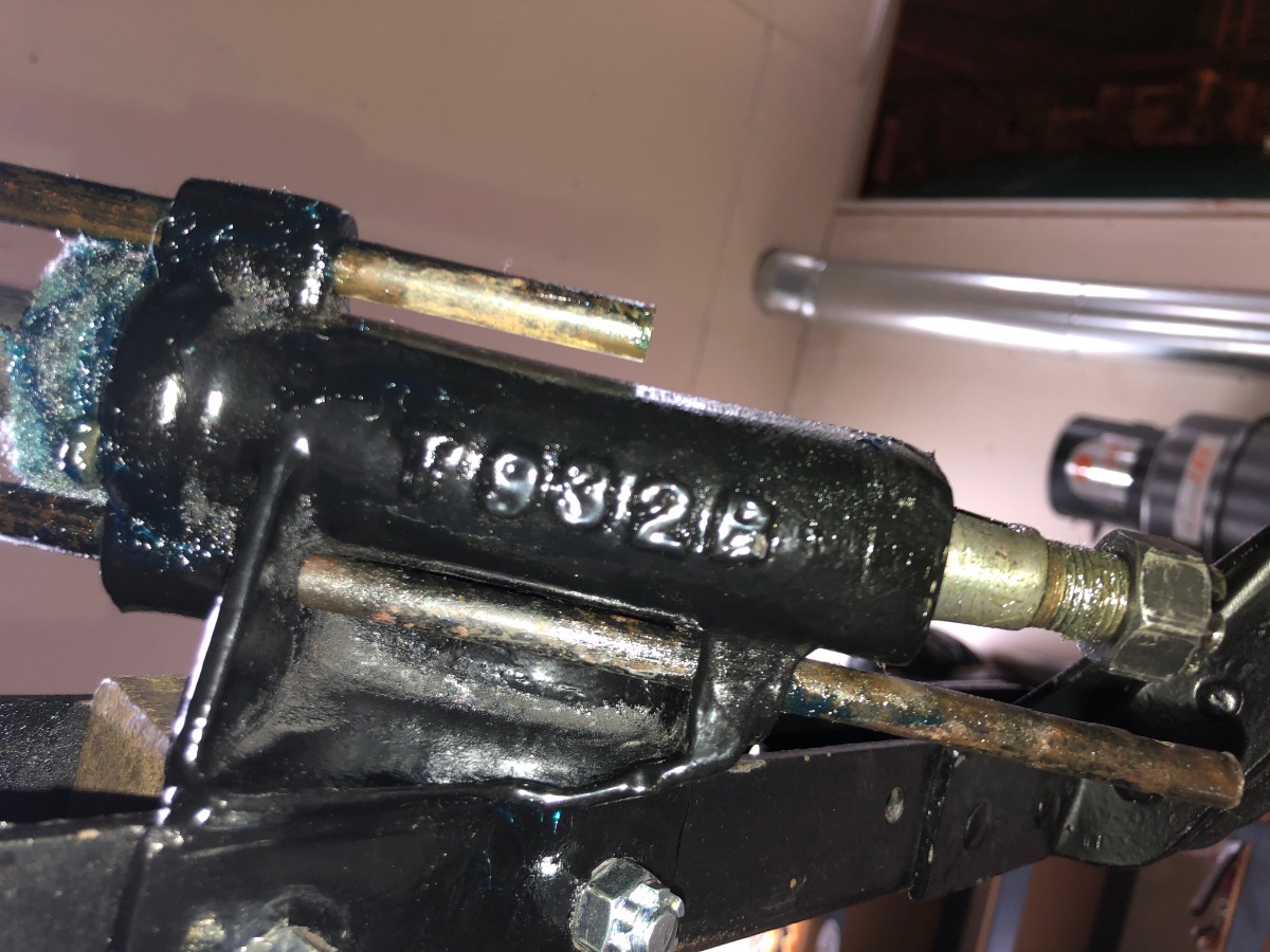

I put my steering in the 11 today but it doesn’t seem to have enough sticking out the bottom of the steering bracket for the pitman arm to tighten up on. The top of the shaft in as far as it will go. What is wrong here? Art

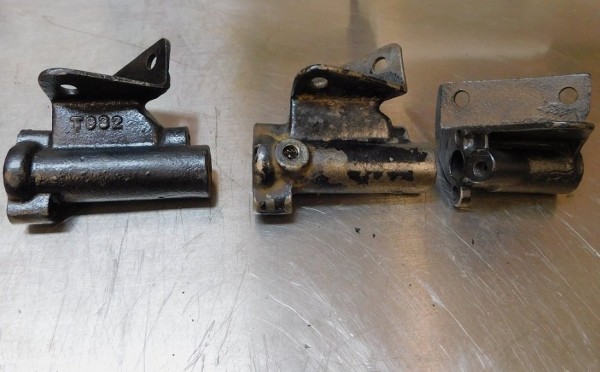

I’m more concerned about you having the correct frame-to-steering column bracket. Ford made a half dozen different ones for Ts. What part number is on that bracket?

The bracket is a T932B which should be correct according to Royce's article. The steering column and shaft were one unit when I got the car. Art

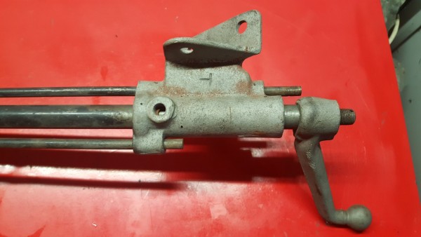

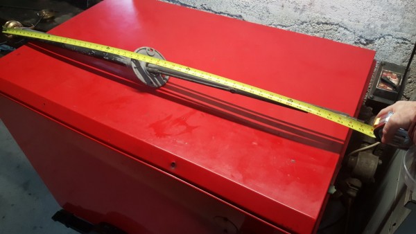

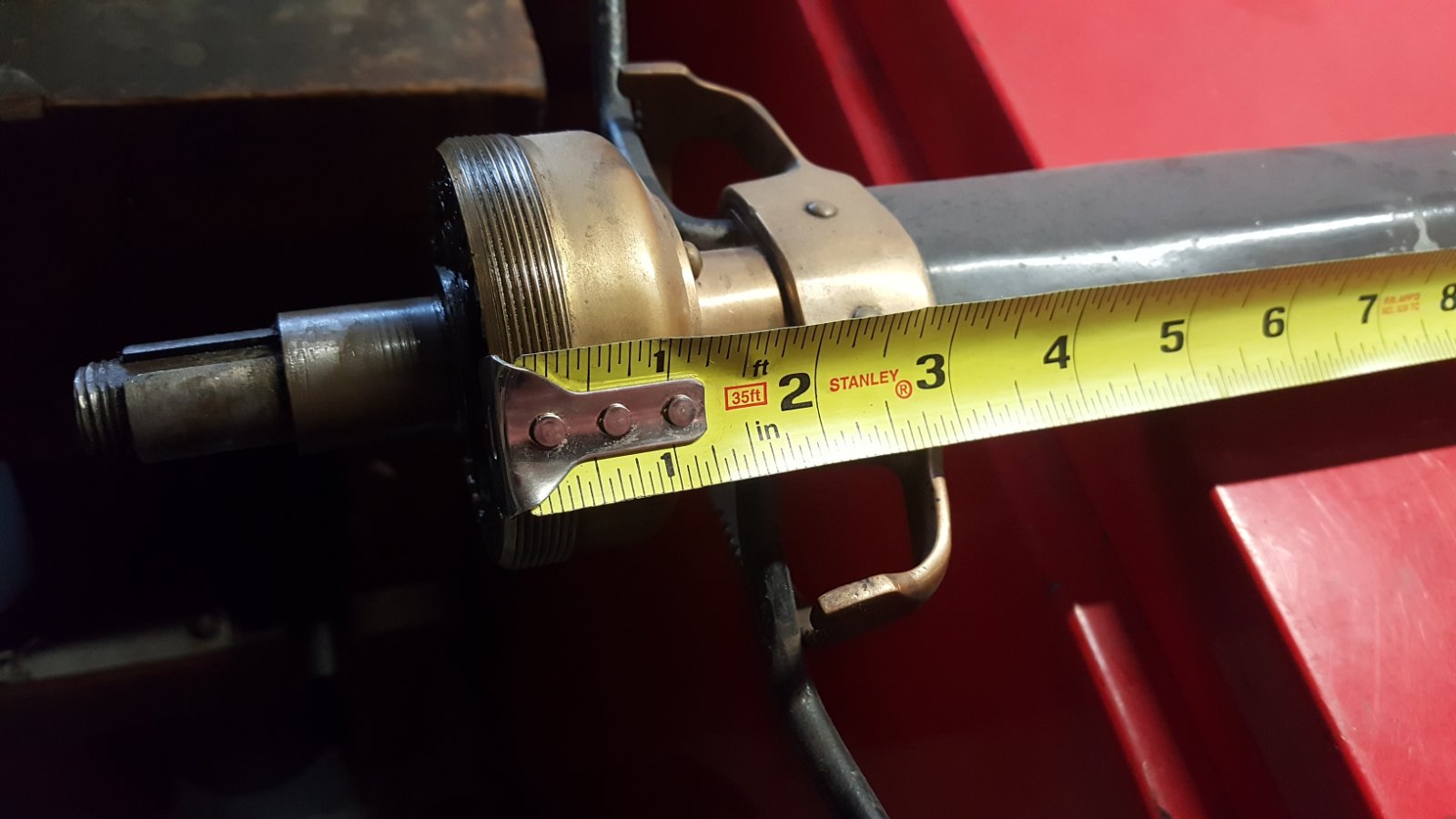

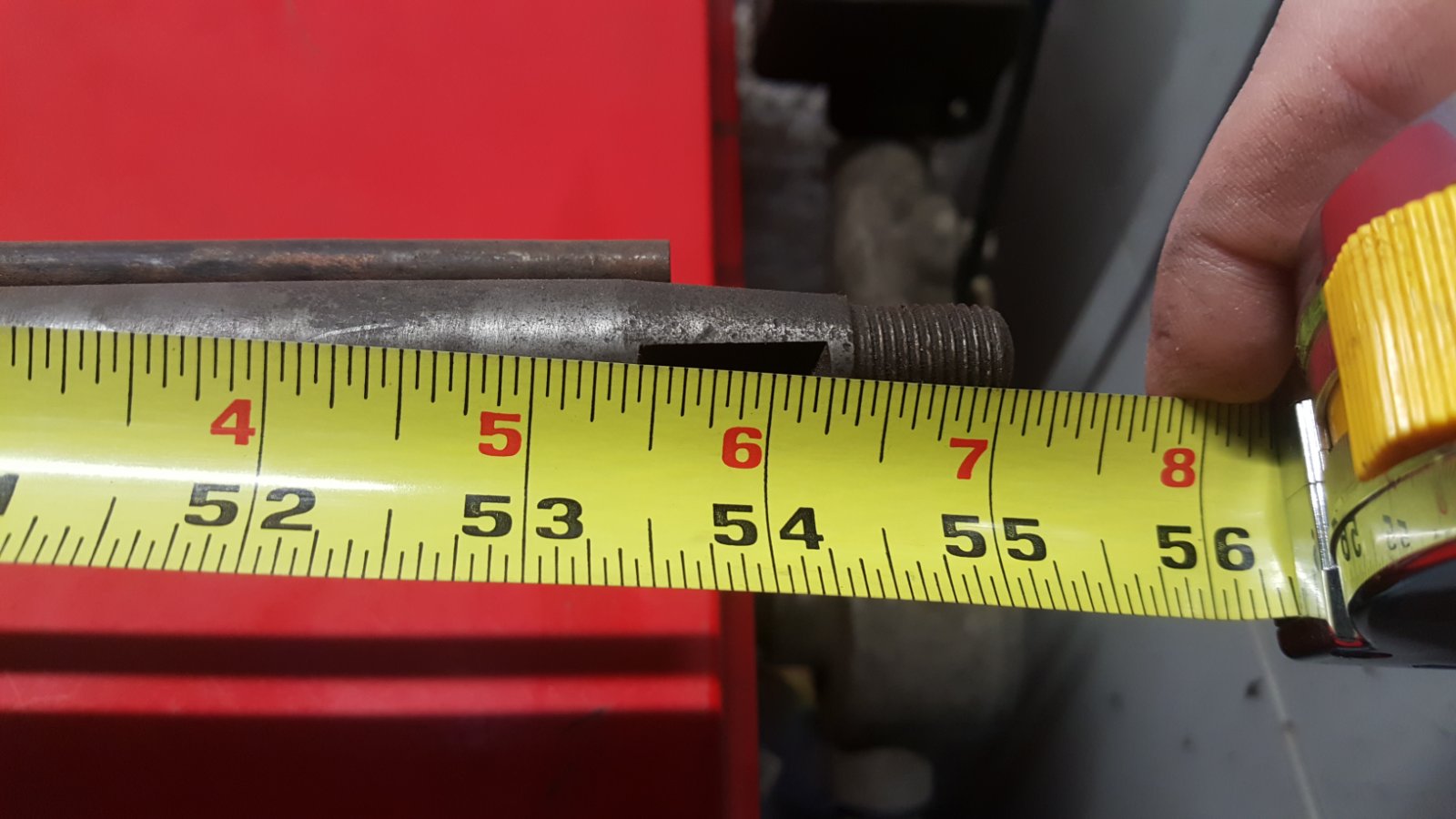

Attached are photos from an unmolested 56" 1912 column. The steering shaft should be the same length. Clipping your tape to the top of the steering case and going over the flange should be a valid datum point if you measure yours the same way that I did there. Obviously, you'll need to remove the unit from the car and take the bracket off the bottom.
The very top of the key slot is 53-7/16". The taper starts about 1/16" above that. How much difference is there between this one and yours?
For a second reference, with the gear case cover screwed on you will measure 56" from the flange that the steering wheel butts against to the very end of the threads on the shaft.

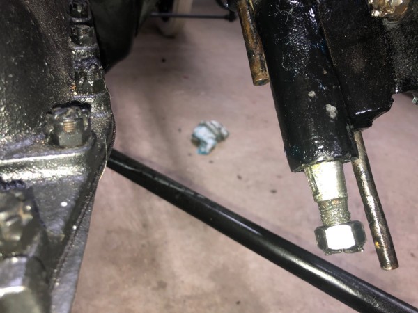

Compare the position of the spark and rod ends on yours and Walts set up. Your rods extend beyond the end of the main shaft much more than his. Unless your shaft is not seated in the gear case, your column and levers are not matched to the shaft.
Very good eye!
Here is the column with a few parts thrown on the end for reference. The bracket is pushed back the right distance as measured off an assembled car.
