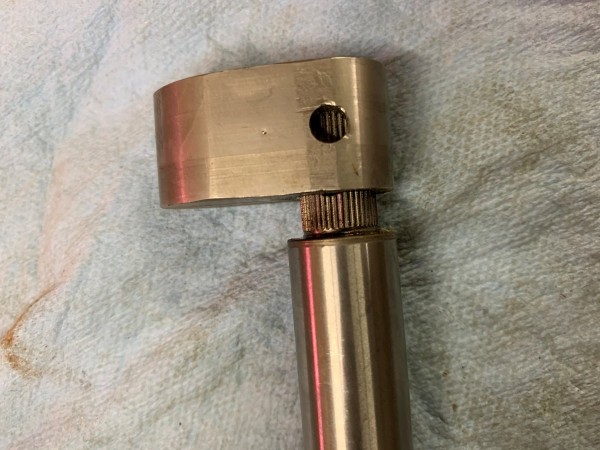

Here is a picture of one of them. I really don't like the way it is made. It looks like an accident waiting to happen!!

The 26/27 brakes were not meant to be service brakes, they are parking brakes. OP: I do not see any difference between the lever which is pinned to the shaft or a cam being pinned as long as they are tight on the shaft, you could shear ether one if one put enough force on them. If you don't like them might I suggest looking for good original ones.

I agree with Mark. I wouldn't worry about it unless there is something very obviously deficient in its assembly, and you're the only one that can conclude that, not us.

I would agree other than the diameter of the shaft is larger at the lever end. The shaft appears to be only 7/16" in diameter at the cam end. Subtract the 3/16" pin diameter and your left with 1/4". Divide that by 2 and you have only 1/8" of material left on each side to hold the forces that are applied by the hand brake lever. That is what concerns me. The parking brake is also the emergency brake!

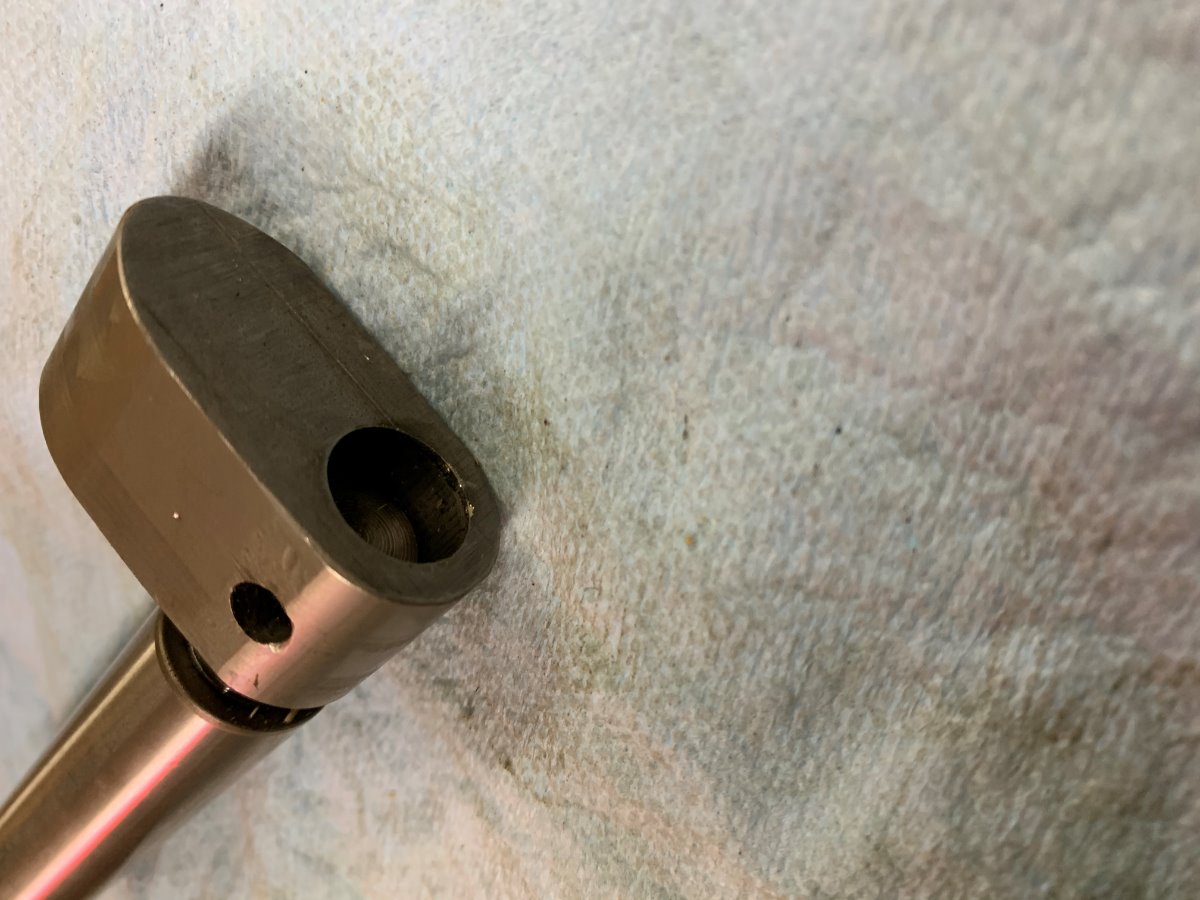

I can not see how that could be safe. Meaning a smaller diameter round shaft in round hole pinned. I will give the benefit of doubt if the item has been proven in an independent lab on the shear/clevis strength test to the item it is replacing. Now pull like hell in an emergency situation and see what happens over time. As some of you comment, "In Henry's day" well, I do not believe he would have done that when it comes to public safety. When it comes to safety, only better, proven methods of material construction/techniques should be used. Saving dollars to meet the demands at an affordable price is not in the interest of any hobby. One person gets hurt, that is one too many in my opinion.

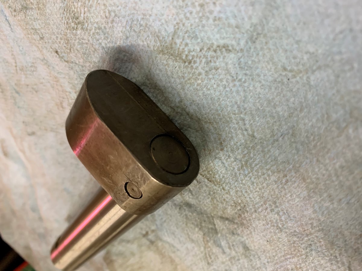

I wonder what keeps the pin in place? Had I the need to fit these, the shaft would be chucked in the lathe, a deep groove machined at the cam and shaft interface, and a substantial weld used to fill the groove. All the while it was fitted I'd be looking for some good original forged pieces. Assemblies such as this are akin to the two piece, pressed together spring shackles.

This is not true. The cam itself is adding significant hoop strength to the assembly. If on the other hand, you were looking at a roll pin there, there would be great cause for concern. Given the available "oomph" available on the handbrake, even with a safety factor, anyone that thinks they're going to shear that solid pin with the forces available, I believe are mistaken. If it only went 1/2 way through, like a set screw...UH-OH, but that's not the case here.only 1/8" of material left on each side to hold the forces that are applied by the hand brake lever

Isn’t the lever on the other end just held by the same pin?
I think the 26 -27 had one pin, earlier 2 pins.

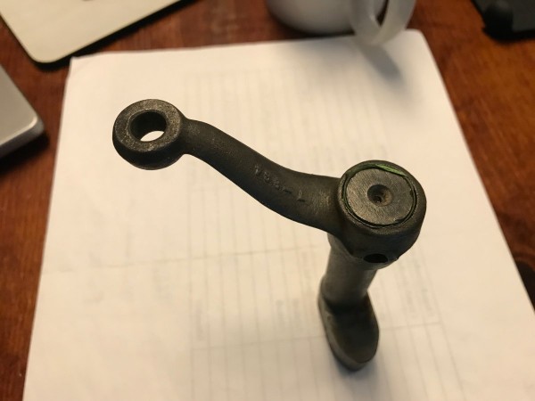

The entire emergency brake system needs to put in focus to determine the weakest link. I can't see the possibility of the pin in the cam shearing given its position and on the other end a lever arm that's only 2 1/2 inches long. Yes the hand break arm is much longer "lever" but it is pulling on another 2 1/2" lever arm connected by a rod with clevis pins in yoke ends. Each lever arm and yoke end has a loop at the end of its neck. So the question is what breaks first: a loop or pin? Think about how much force you could apply to a wrench that's only 2 1/2 " long.

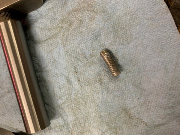

Wow!! Some of these responses are not what I thought that I would receive. I asked an honest question and voiced an honest concern. I did not insult anyone. Any way, here is an up date on what I have found. I had a hardness check done and the results were, the original tested at 8 and the reproduction one tested at 20. So, the new one does test significantly harder. I think that is a positive. I removed the pin and pulled the lobe. The shaft is splined, while the lobe is not. The pin is also slightly splined. So, it appears that the posted issue from the past has been addressed by the supplier. I now, do think that they are safe to use.

And the hardness of the pin was?? That's a critical piece of this assembly.
