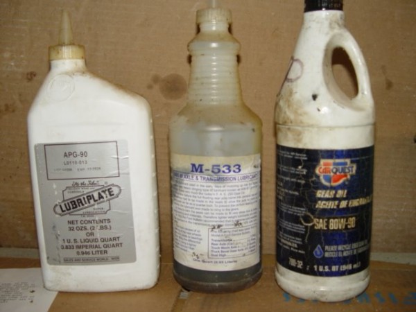

From left,
Lubriplate - correct for Ruckstells
M-533 - correct 600W for T rears
Cheap 80-90W gear oil - maybe as good as original?
Some say the modern oil can deteriorate the brass in the TT rear .
