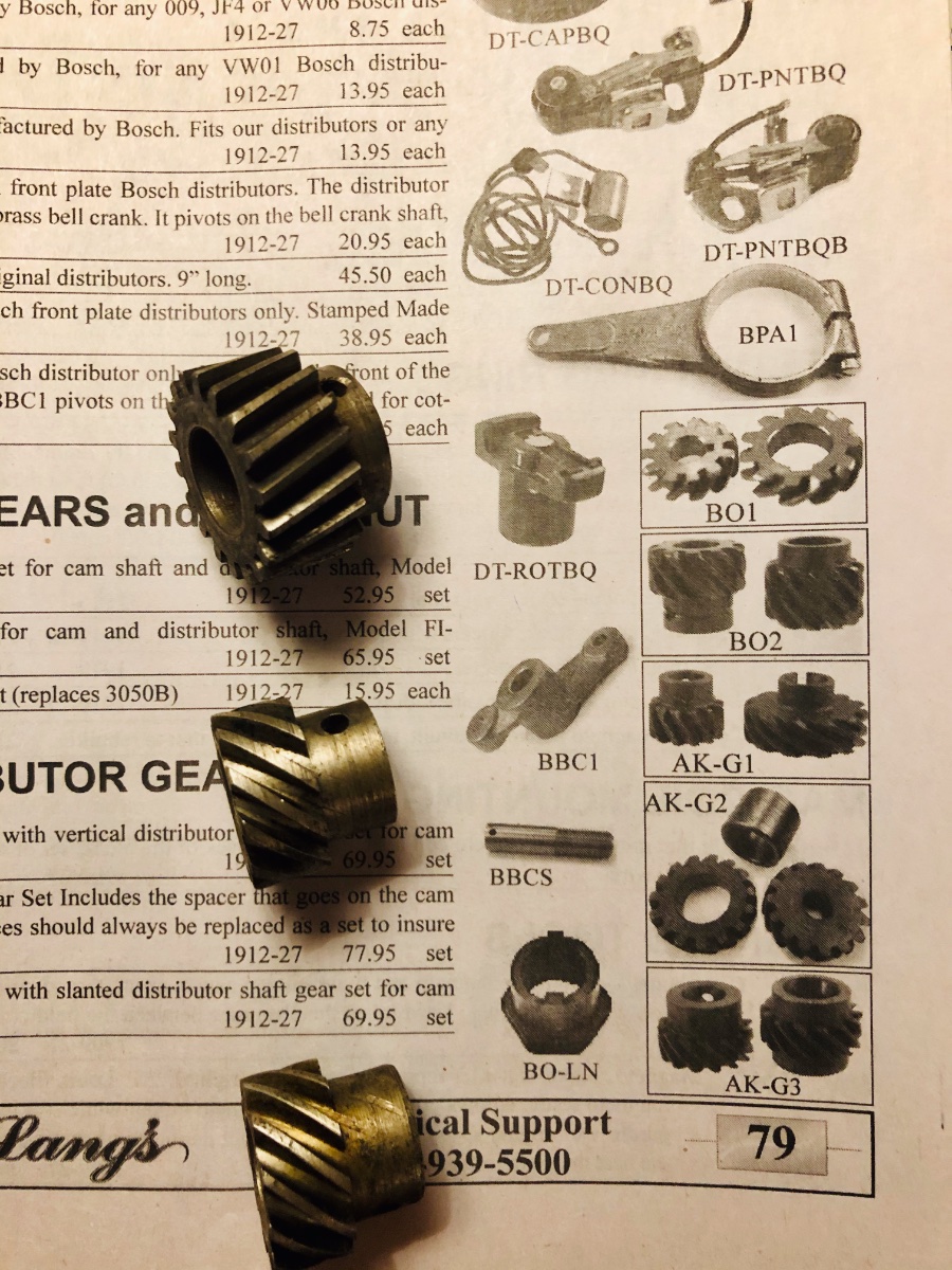

Like Mark's post, the available repros are sold by Langs for the more popular old dist. models. You can call them and get the dimensions likely. Can't think there is any source of printed ref. material on actual size of gears, tooth counts, etc. as most of the old info sheets of parts lists only list the gears by item number and description as 'large' or 'small' gear
I have a couple of about NOS small gears,11 tooth and one 18 tooth. If they help you let me know, cheap as don't have any need of these. (shown below with Lang's cat. page)

Right now you are asking too broad of a question with way too many variables to give answers to. If you have some gears that you are trying to figure out what they go to, or? We could post that X brand gear is Y, but that is only part of it if you are looking for off the shelf gears. If you look at the photo in Dan's post, some gear sets have two different diameter of gears and as Hank said, depending on the gear placement could be CCW or CW teeth. I think maybe you need to narrow down the question and be more specific.

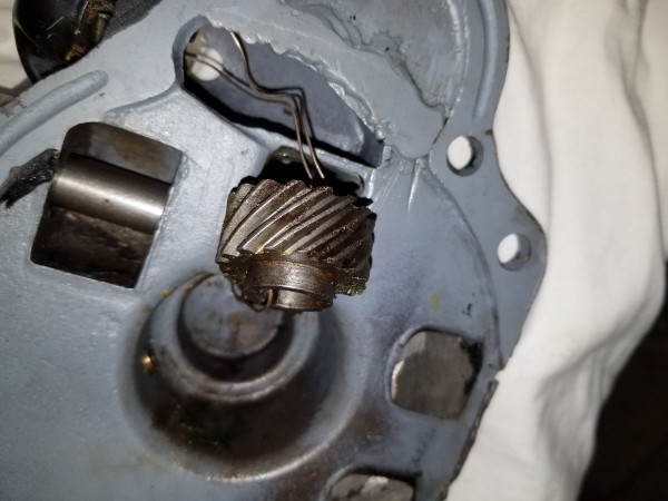

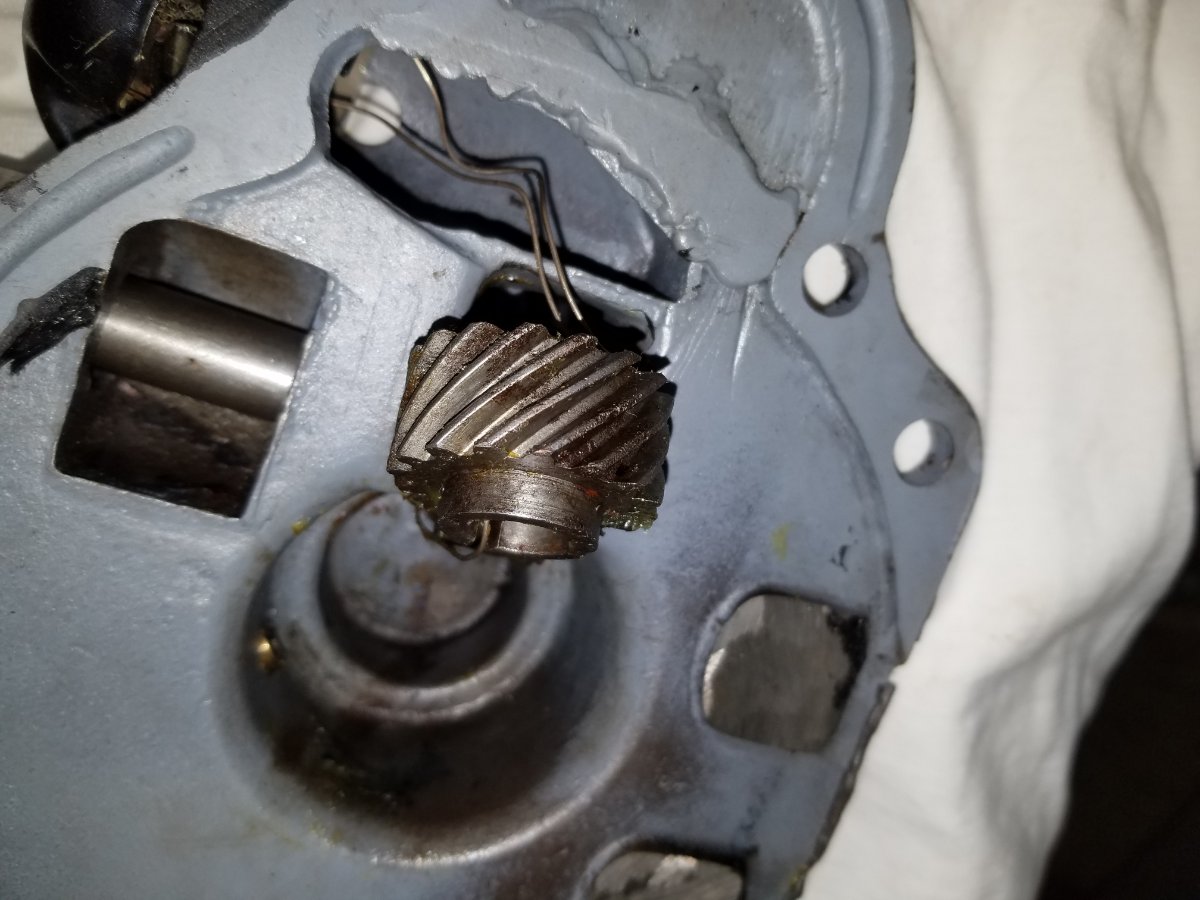

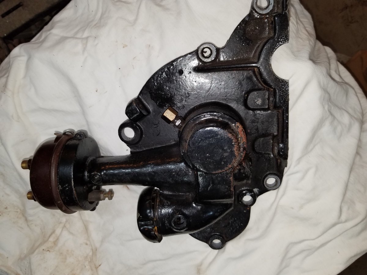

Here is what they look like.

It looks to be a Thomas.
http://www.mtfca.com/discus/messages/11 ... 1263778450
At some point the area by the oil fill hole was built up so it could be used on early pre starter engine. If you need a second cam gear might have to have it made at least you would have a sample to start with. I don't know it the cam gear is the same for the clip/bolt on type but if it is could be a market for them.
